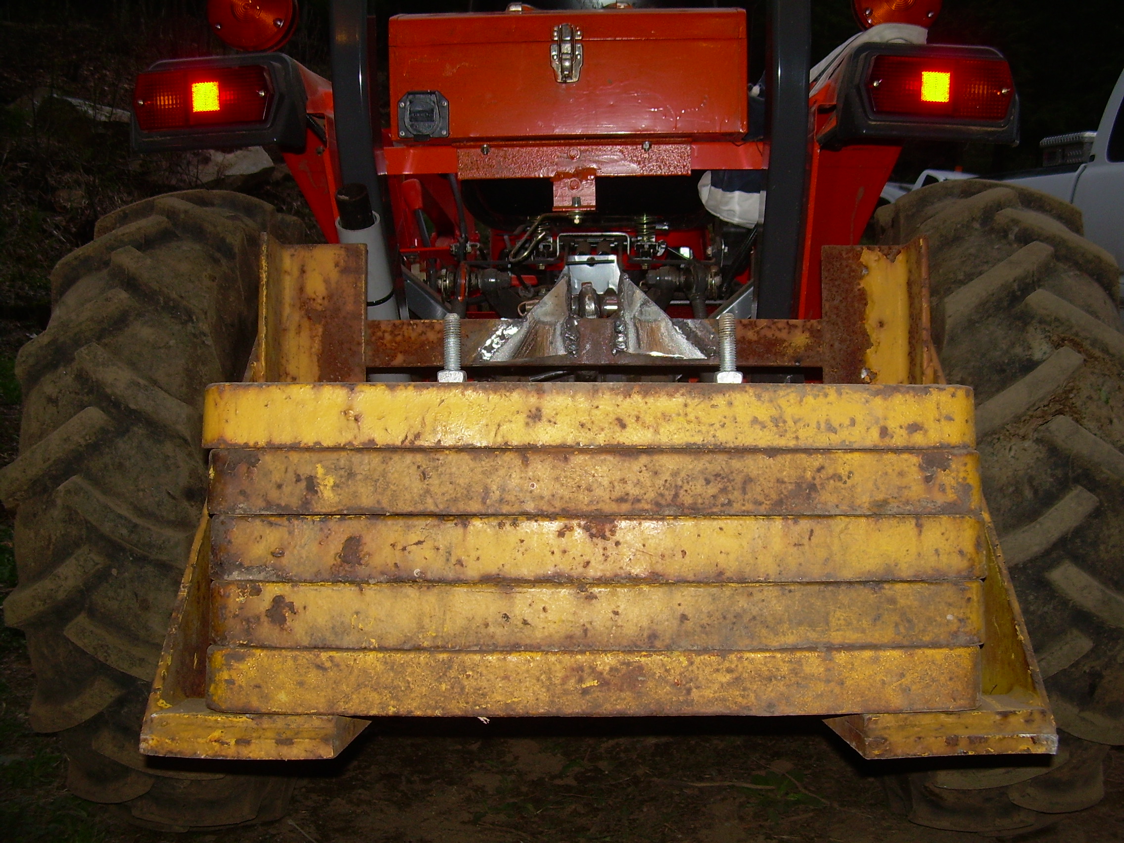

   / Kubota Newbie! L245DT/1200 FEL #26
Are your Kubotas older ones? Mine's 3 decades old and I imagine they made some improvements in the area of geometry. Mine does not look homemade or retrofitted. I don't mind the weight, just the fact that it's topheavy. My land is steep terrain and this limits what I can do with the loader. I know some people offset the wheels for stability, but the rear reductions don't look very stout to handle the extra stress, they're made out of stamped sheet metal. The front axle, although it seems to be in good shape, is not known to be extra strong from what I've read around here.
Because of the steep terrain, I need 4x4 all the time for braking as well as traction. I have read that the 4x4 is not designed for continuous use.
I'm in the same boat with some nasty terrain & a light tractor. This ballast box doubled my traction & stability (also setting the wheels out to max). I have not weighed the weights individually, but if I were to guess, I'd say 150-200 lbs each. I'd estimate the bracket to be around 100 by itself. You'll see a world of difference with 1000# on the back.
