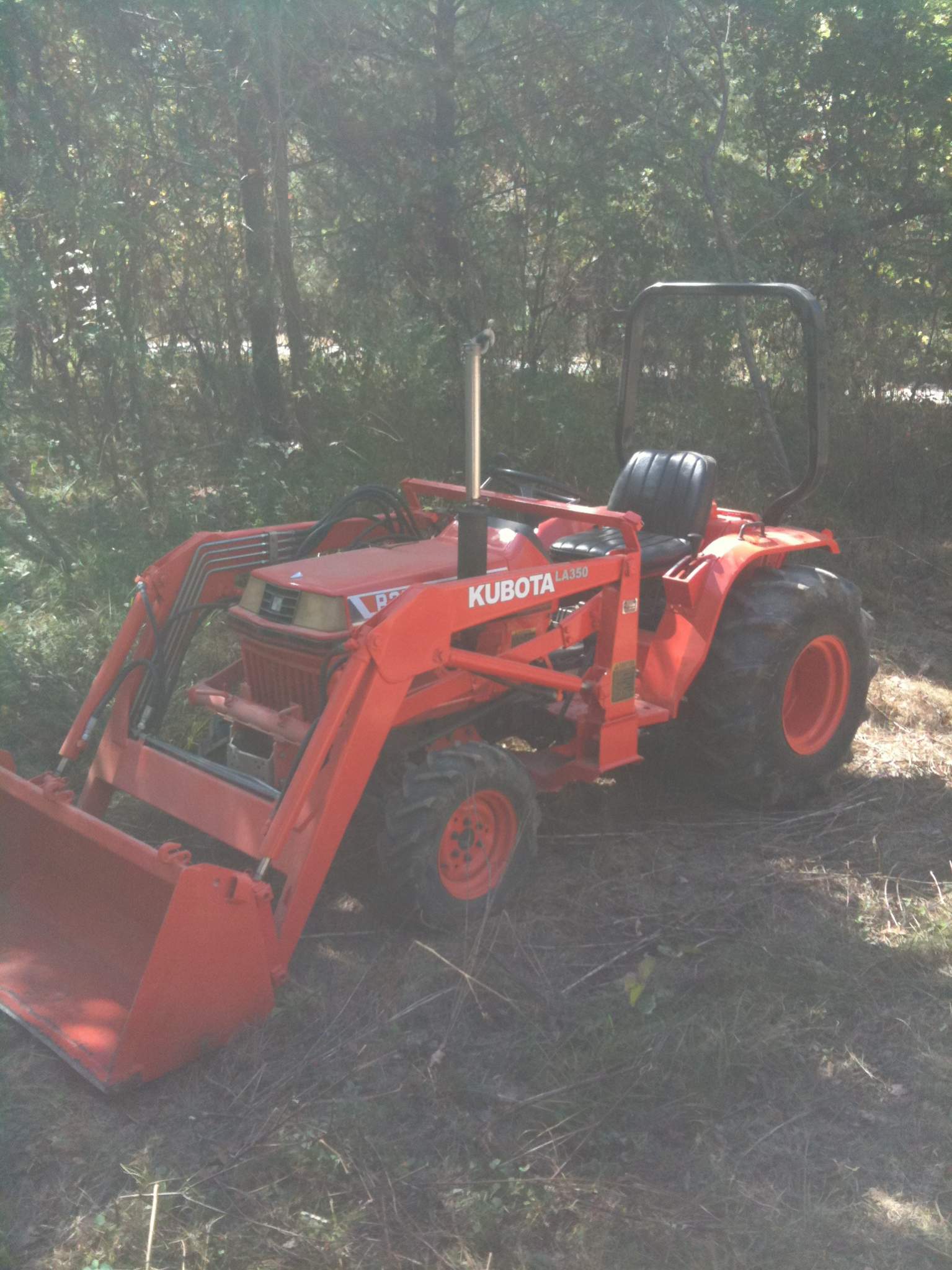

Howdy again all. Well I ended up getting the B2150 with no HST but Power Steering. The gears are over on the fender so are not in your way at all. Wow what a nice little tractor. 4 Cylinder 24HP 4WD. I have been moving dirt all weekend. It will do just what I wanted it for. Picking up a box blade from a friend this weekend. Pic attached.
   / Kubota No Power Steering is this a Problem #29
Congrats!!! Super Duper :thumbsup: Don't be a stranger, come back and let us know how she does...
   / Kubota No Power Steering is this a Problem #30
Congrats on your new tractor, looks really nice.
