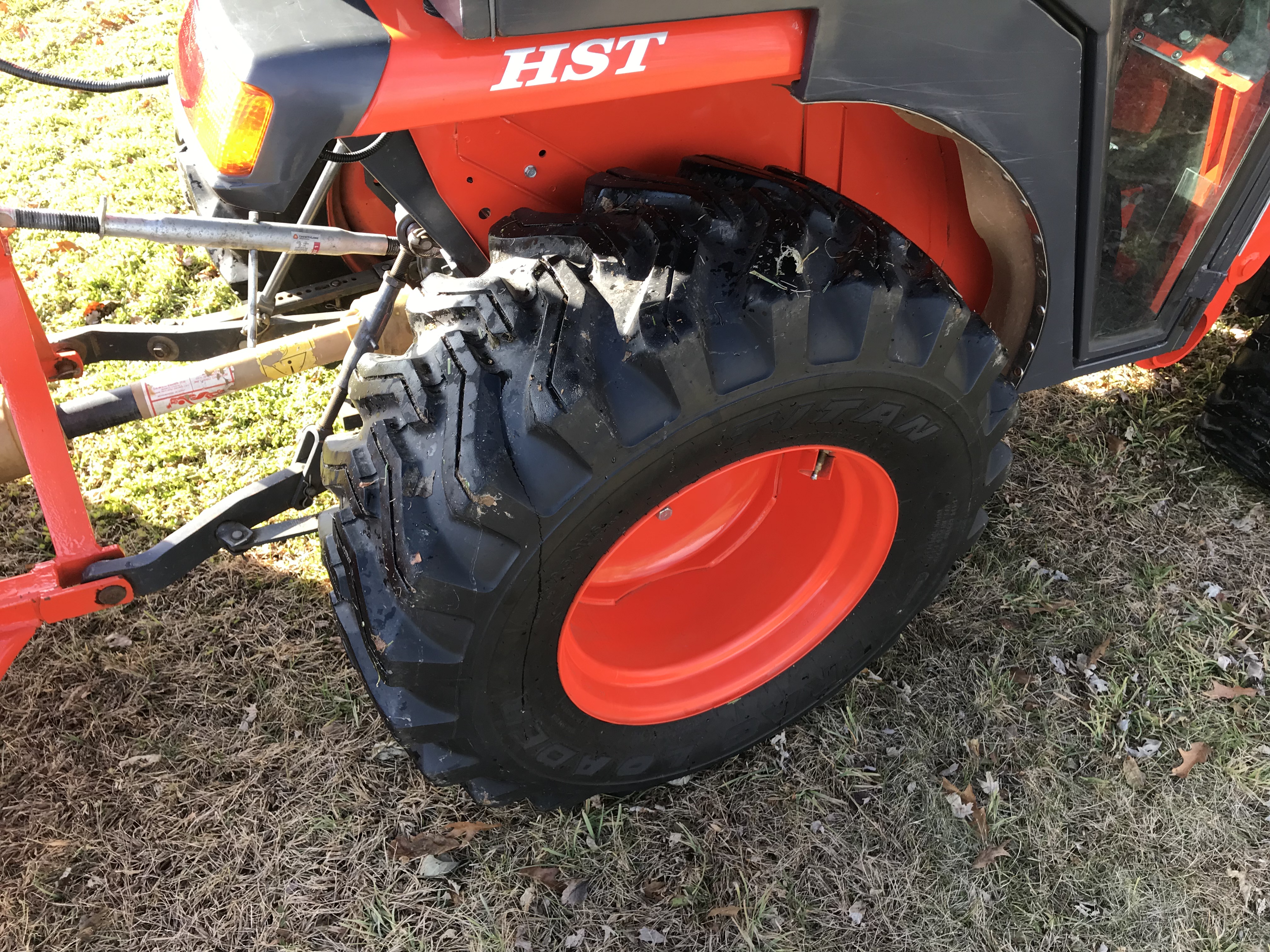

What bends them? In compression and buckle?
Somehow rear tires enters a dip and weight of tractor rests on implement (and through top link) because 3 point hitch parts don稚 rotate quick enough?
B series Kubota toplinks can be trashed by folding the ROPS down then fully raising a 3 point implement.
   / Kubota OEM top link bent #13
BX toplinks are shorter than most after market vendors make. Only found one place, Surplus Center. I think K OEM ones are soft. Bent two and bought no more. Same use parameters and no problems in over 1000 Hrs since. May they just look fake gold plated and are real gold after all as the price indicates.

I'm not really sure what bent it. Last thing o had on it was a 6' BEFCO land plane. ..But I may have backed into a tree /hen I was using the grapple to pick up stuff in the woods for my burn pile. If I had to guess.

I have bent them back, especially with that asian steel, it's pretty soft, compared to most of the others...
Straighten it, and you will have a spare.

I had one fall out of the holder while the implement was off. It was long enough to reach the ground and got bent going backwards.
And that is why the toplink on the L3200 I recently sold had a silver TSC replacement instead of the Kubota Gray original:)
EDIT TO ADD: The locking lever was nicer than the factory hex nut setup. I should weld a tab on the nuts of my other toplinks. It's easier to have something to whack the tab. With the hex nut setup I often need to hold the barrel of the toplink to loosen the nut.
