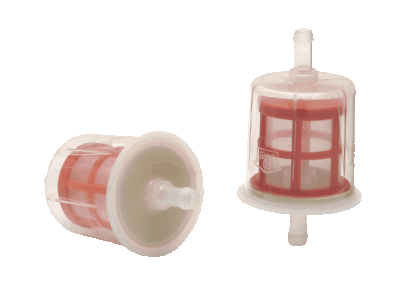

The WIX crossover fuel filter the 33972 for the BX is nothing but a screen. If you think that is a good cross then go ahead and use it and by a spare injector pump while your at it.
