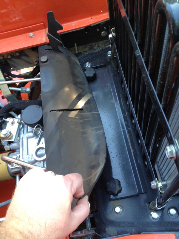

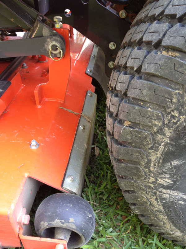

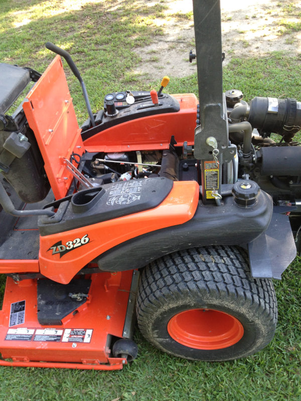

I took some pictures of the rubber flaps that mine came with that I'm sure help but it's still a pain.
Thanks. That's what I was pondering doing. Plan for mine to be a thick stiffer rubber that will come back about 6 to 8 inches and then may have a droop because of lack of support toward the rear of the rubber piece. Only screwed to the deck.
I don't think mine blows it up so bad when I'm mowing the grass that I only mow when it gets high enough to know for sure where I've mowed, which some people complain about:) and I keep my deck set fairly high to not cut down to the dirt but when I have to back up it's recutting the cut grass which I think is doing most of the blowing the fine cut stuff up where the fan suction pulls it up into the screen and all over the bottom. Theory, not proven fact. Theory: Recutting already cut grass creates more fine grass particles which will be lighter weight and more prone to be sucked up by engine cooling fan.
