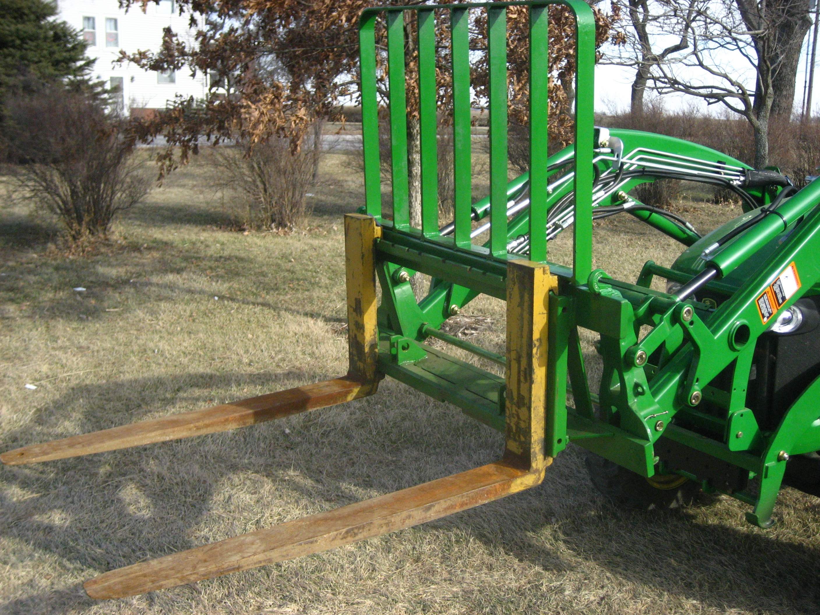

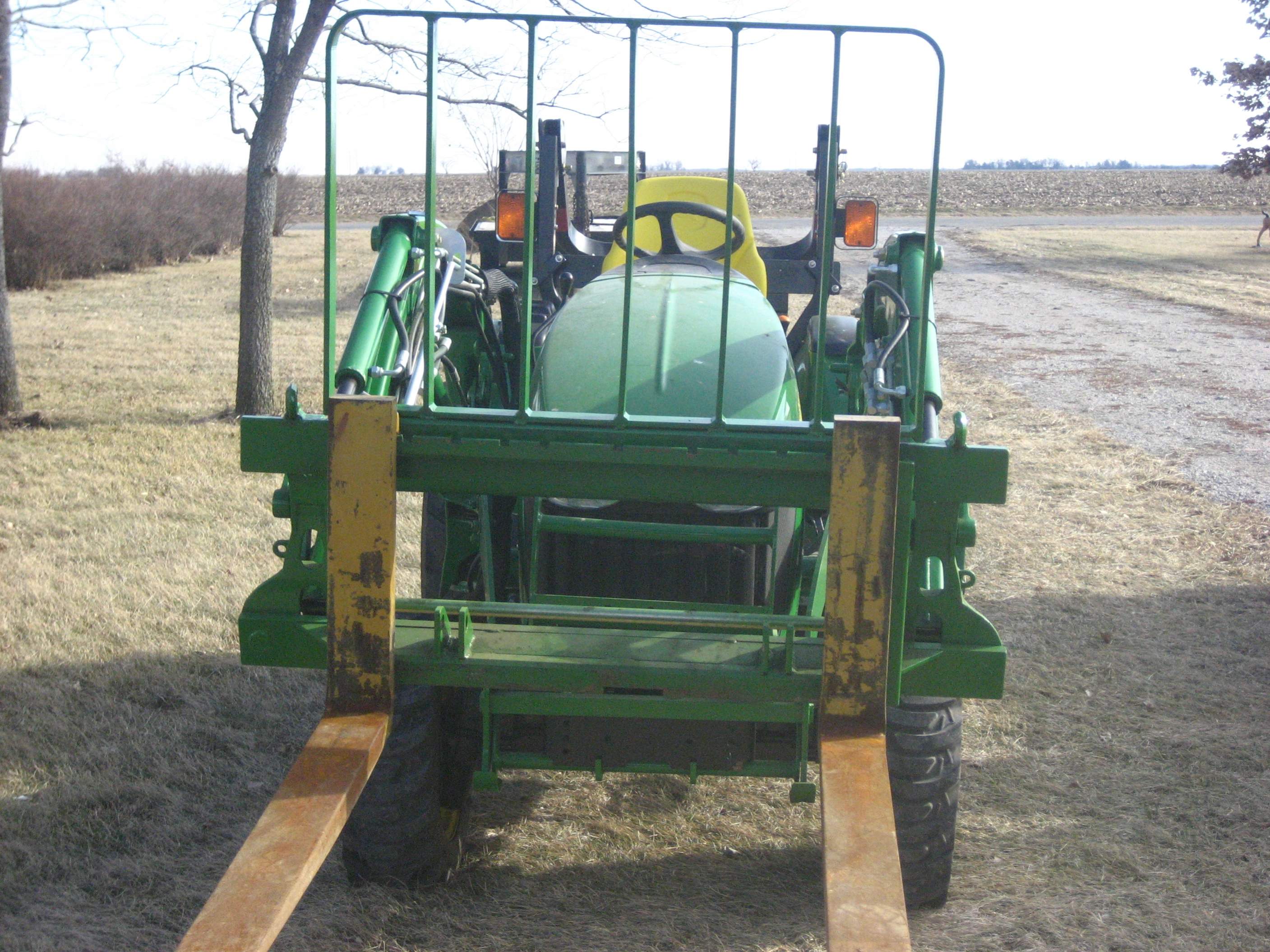

I am with the make your own crowd. I talked to the local Cat lift truck dealer told them what I had in mind. They salvaged the parts I needed over a couple of months and sold to me at scrap price. I then assembled my own. These are on a Deere loader but you can buy mounting plates for your tractor for around $100.00 and mount the parts to it. I wish they were wider but for $50.00 I can't complain.
Dan
