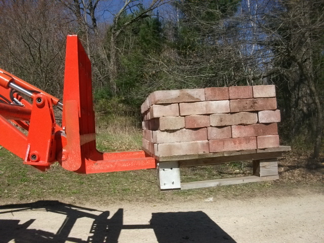

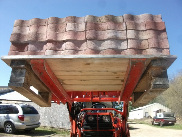

When I bought my B3200 recently - I talked to the dealer about going with the ATI SSQA and bucket. The price came in around $3k. The Kubota QA for the LA504 was something like $250. That made the choice pretty easy. The biggest disadvantages I see to the Kubota solution over the SSQA route are: 1) the Kubota QA pushes the attachment out a few inches, which is a reduction in capacity, and 2) the Kubota QA requires you to get out and screw with getting the lower pins in and out. They often stick - and I always have a mallet ready to beat them in or out if I need to.
For the difference in price between the Kubota QA and the ATI SSQA solution (approximately $2750) - I've made up the difference so far by buying the Kubota pallet fork frame ($650.00) , I will probably get another bucket and weld some teeth on just for digging ( 54" about $550.00 or so) - and I would like to get a root grapple bucket (probably about $1400) , and I have some steel coming to weld up a multi use device with a bunch of 2" receivers, hooks, loops, etc. - for moving trailers, pulling with ropes or chains, etc.

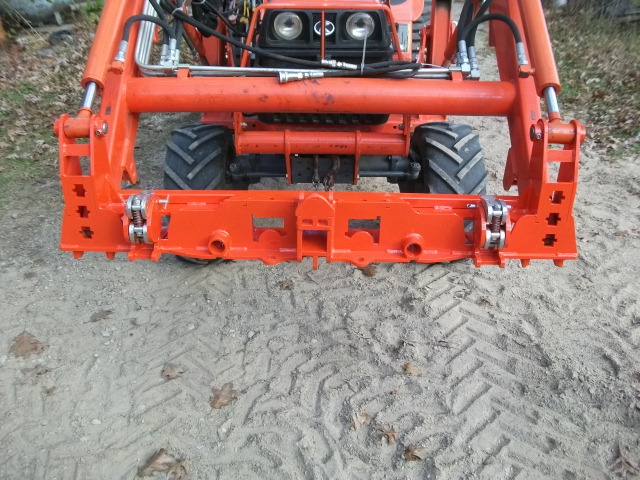

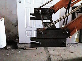

I have 3 attachments for my FEL. It wasn't hard to change them. But lining up the dump cylinders could be a chore at times. Talked to my dealer. He showed me a Quick Coupler that only requires a pin on each side of FEL to be removed to take Loader Bucket off and put Snow Blade or Loader Forks on.
I had to modify the loader pin brackets on the Snow Blade to make it fit the Quick Coupler.
I can now change between FEL attachments in about 5 minutes. /w3tcompact/icons/grin.gif
If I could change 3PH attachments that quick I would have it made. /w3tcompact/icons/frown.gif
Coupler will only work on <font color=orange>Kubota</font color=orange> attachments. All other attachments will need to be modified to fit the coupler, similar to my Curtis Snow Blade.
I have attached some pictures of Coupler being used on my <font color=orange>Kubota</font color=orange> 2910.
