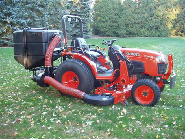

Campman, You are correct. The chains hold up the rear and the front wheels carry the weight of the front of the mower. To get the chain adjustment right I adjusted the hooks with the upper nuts until the weight was just off of the rear wheels. Then, I tightened the lower nuts to lock the hooks in place. The mounting point of the chains is in line with the links that raise and lower the mower via the 3PTH. The chains limit the amount the links allow the mower to be lowered. They can also be repositioned to hold the mower up while using a 3PT implement. I am very pleased with this setup and believe it would work on any mower of this type. Here is a pic of with my 3PT lawn vacuum attached.

Another question for ya ToolGuy. I really have not looked into the vac situation but with all the clippings that seem to pile up if I wait too long between cuts because of rain etc. That vas system do you have and how well does it work?
Thanks in advance
   / KUBOTA RCK6024B MOWER PROBLEM!!!!!!! #18
I like it a lot. What appealed to me was the ease of dumping it when it gets full. I bought it as a pull type model for my JD318. When I bought the Kubota I converted it to 3PTH which is much better now that I have a tractor big enough to handle it. When I bought it was called an EASY RAKE. It is now sold as a Bluebird. Here is a link. web page
