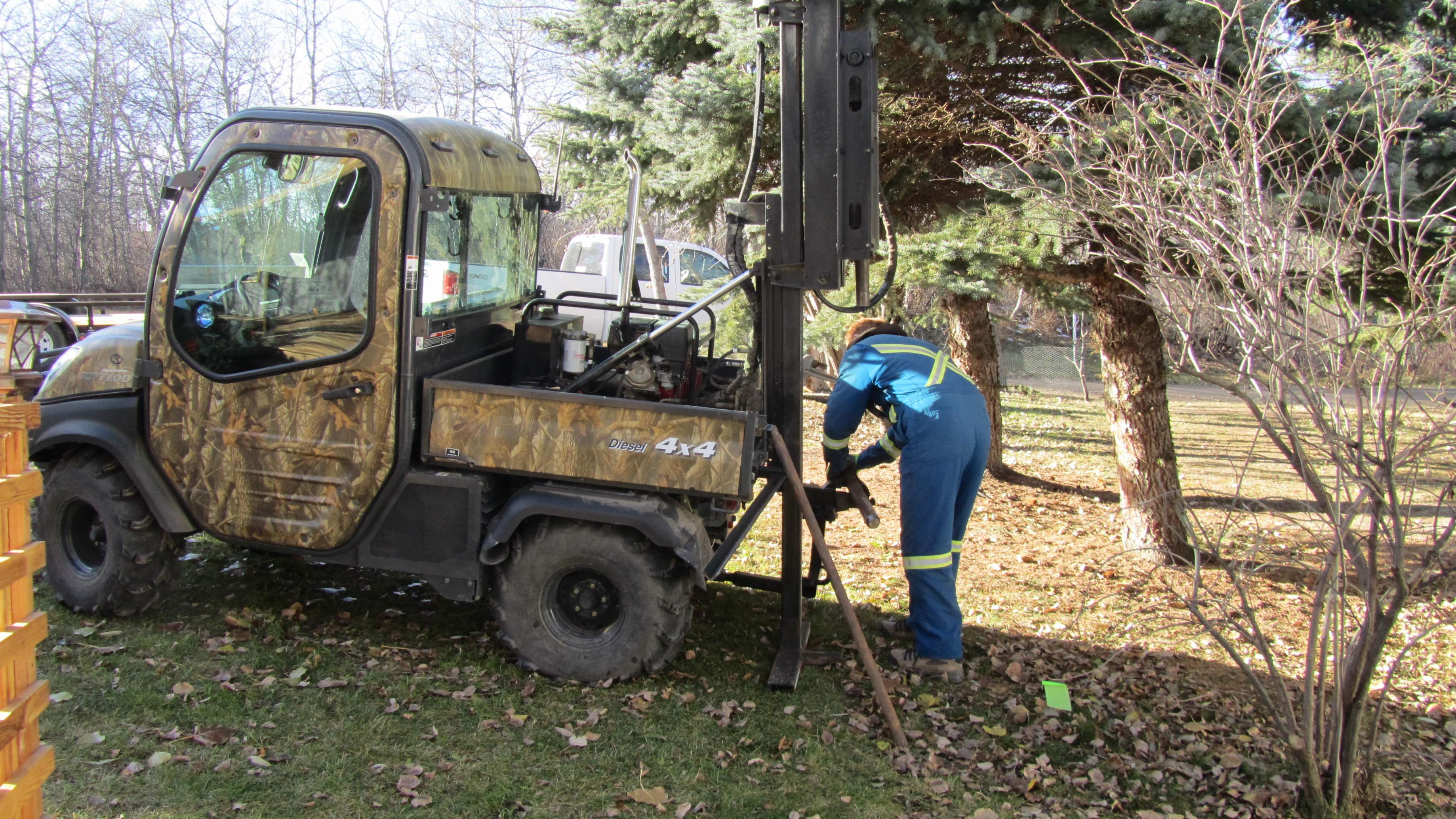

Windshield cover is a must for trailering

Wow it looks like you have quite a load in the back of that thing! When I brought mine home I had heard about the windshield issue when trailering so I just backed it onto the trailer. I have a rear screen to protect the rear window. What size winch do you have on yours and is it strong enough?

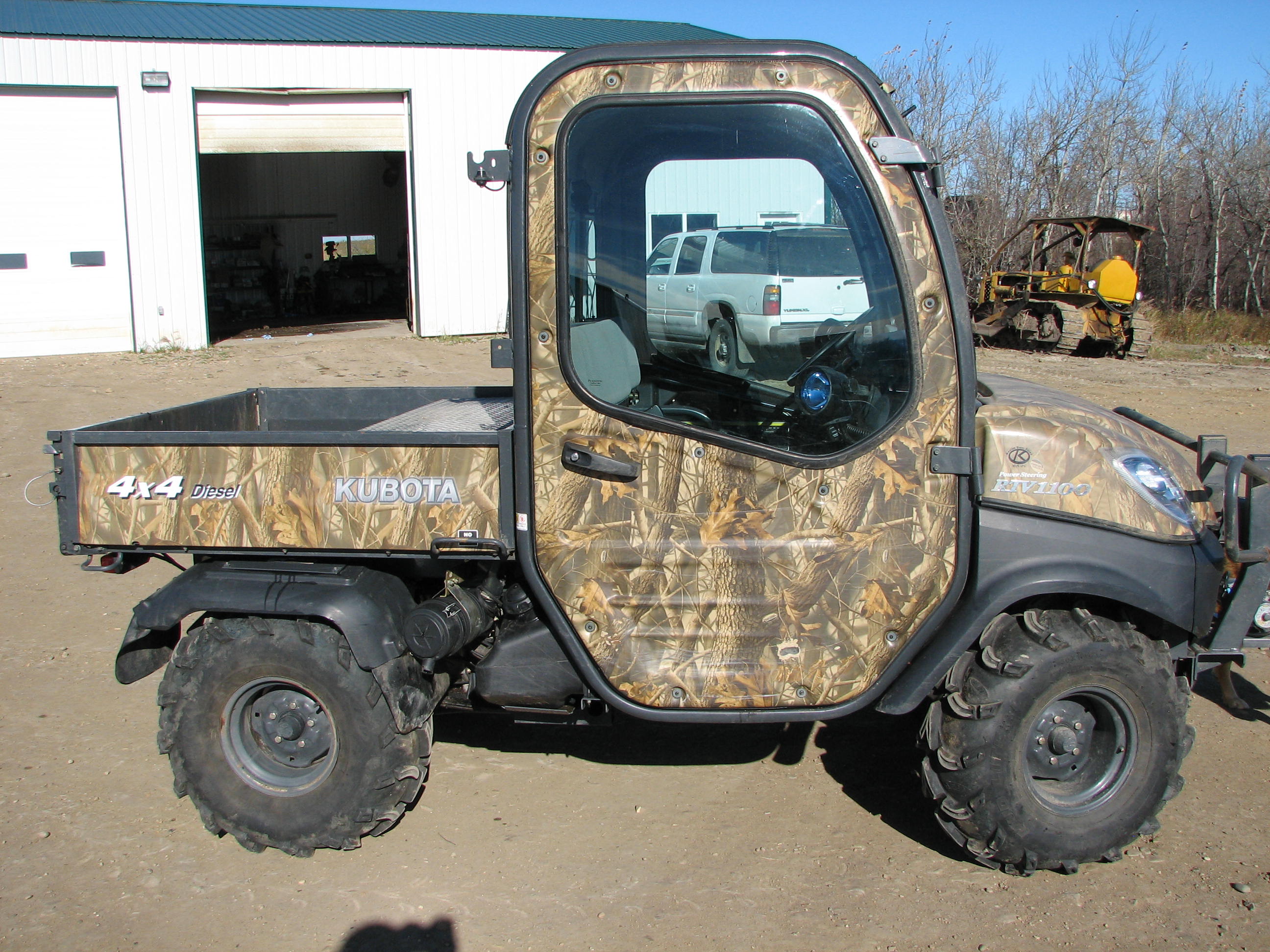

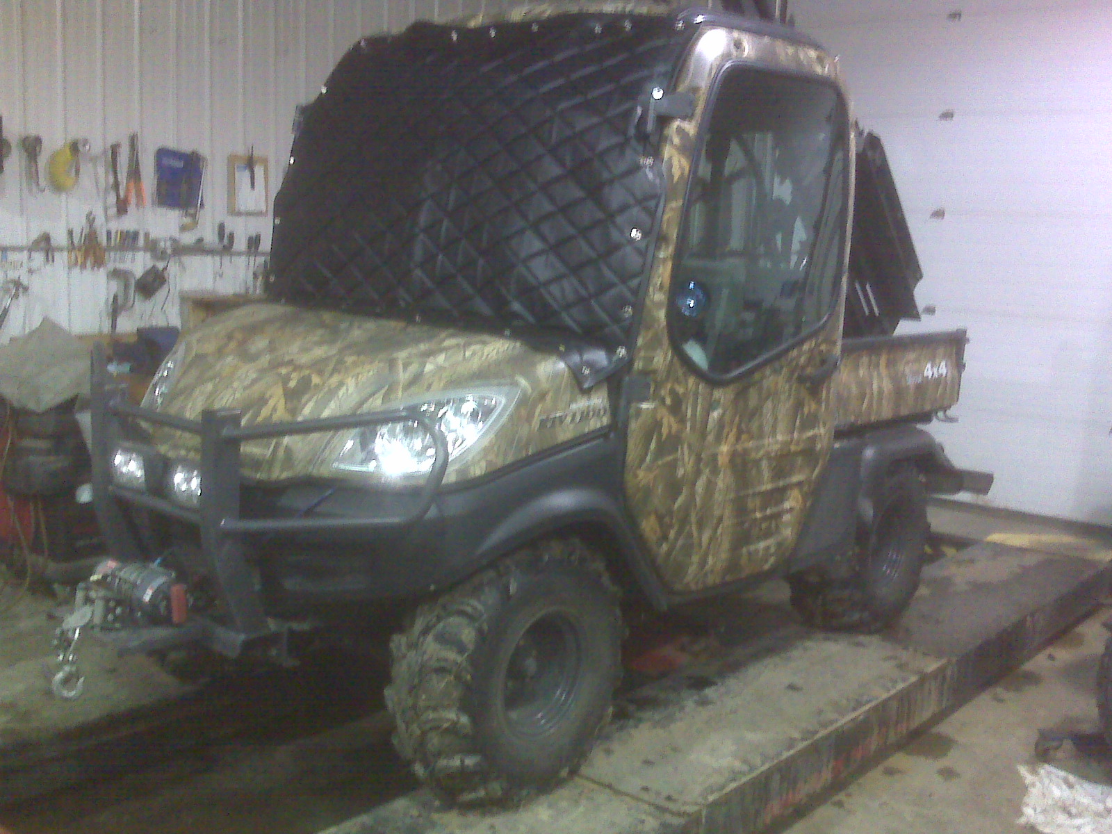

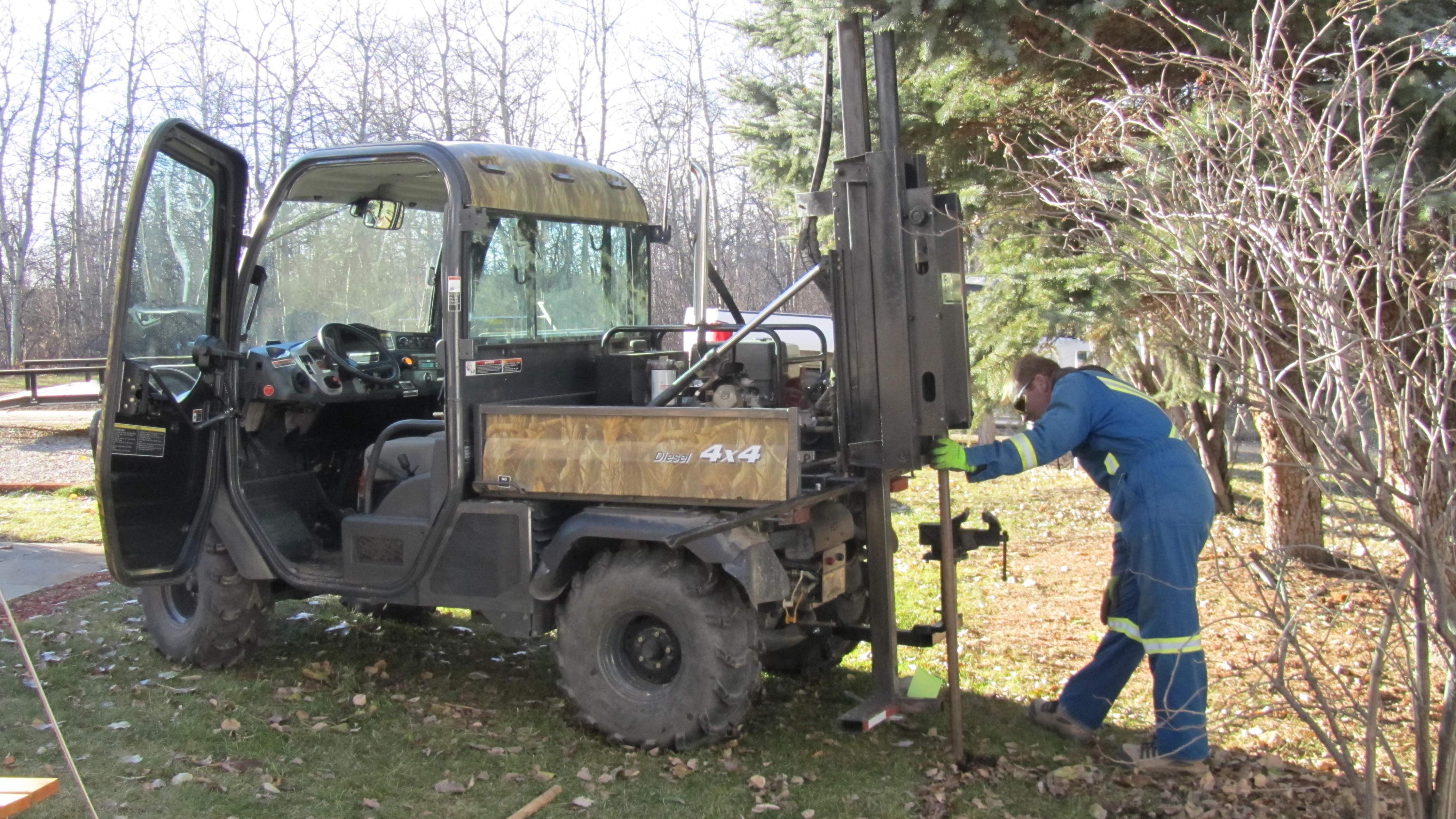

total machine wieght is 3900 lbs, winch is 2000 lb warn and use a snatch block to double the winch power. Can not load it onto trailer unless it in low range. A true test for the machine. I know a guy who carrys more wieght than we do with his.

How in the heck did you gt those tires under that thing!!? Do they rub when you turn? It looks awsome.

Thanks and yes the tire do rub on extreme truns>75% left or right. You will will have to take off (tear off)the front mud flap mounts or your tires will get cut. I took an Air chisel to the spot welds on the flap brackets and siloconed the small holes left in the floor pan. As shown in the photo, that about as far as you can turn the tires befor you hear the lugs rubbing on the inner front fenders, Not a big deal IMO but the tire size destroys the overall performance of the HSTAT tranny.
