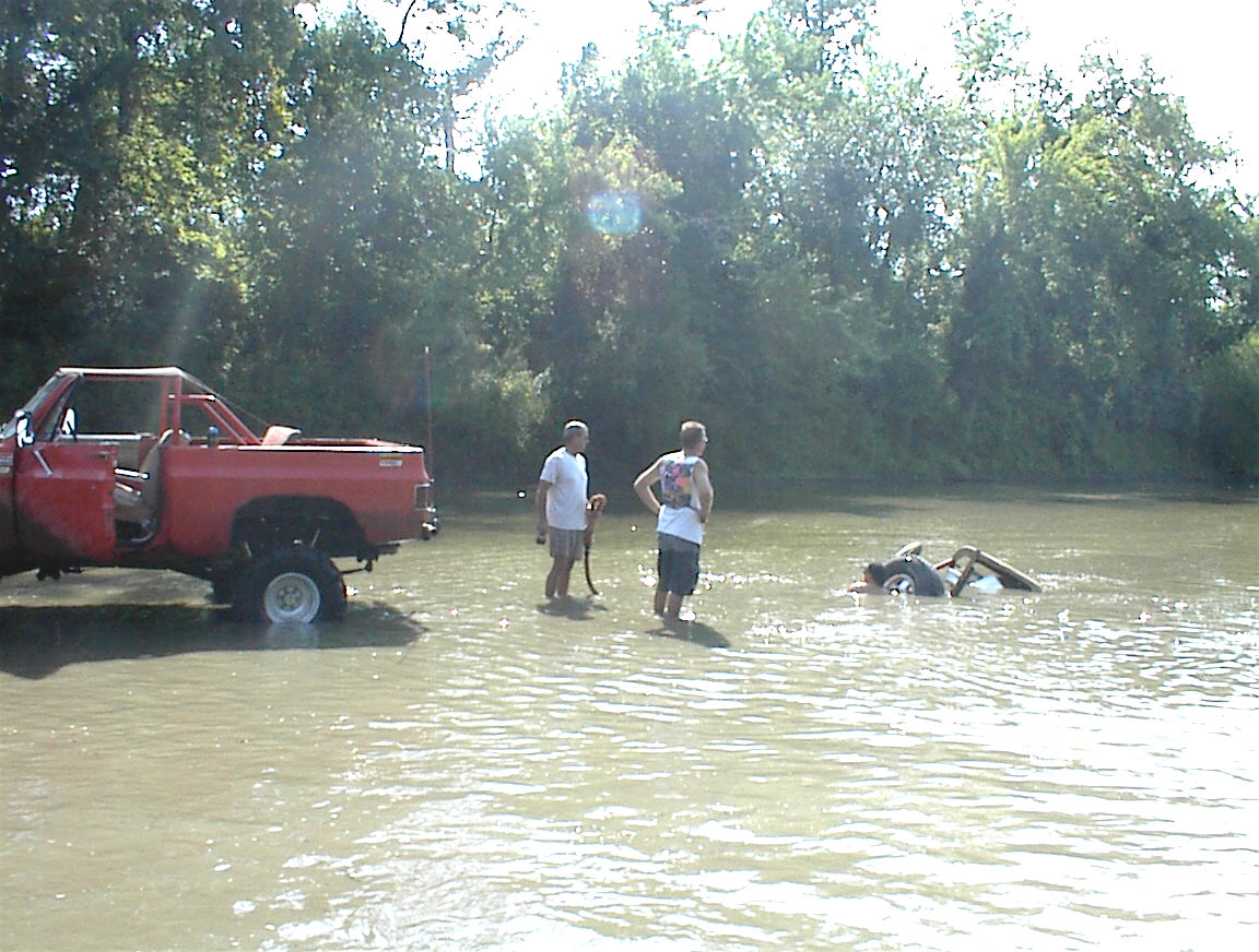

My family/friends and I 4wheel with caged buggies, mostly originating from Jeeps. We get into deep water a couple times a Summer. Requires diligence to touch everything that got wet and shouldn't.
Here's a pic of my Jeep sank in the river. Spent a couple nights in the shop drying everything out and changing fluids. Good as new. :)

Holy moley Richard . . . you got into a pickle there . . . .

OOPS!

A picture like his really should come with an explanation. Did he drive in head first, or go in slowly like stepping into a cold lake?
   / Kubota RTV 900 can swim #40
I wonder if the boat trailer is still connected to the hitch?
