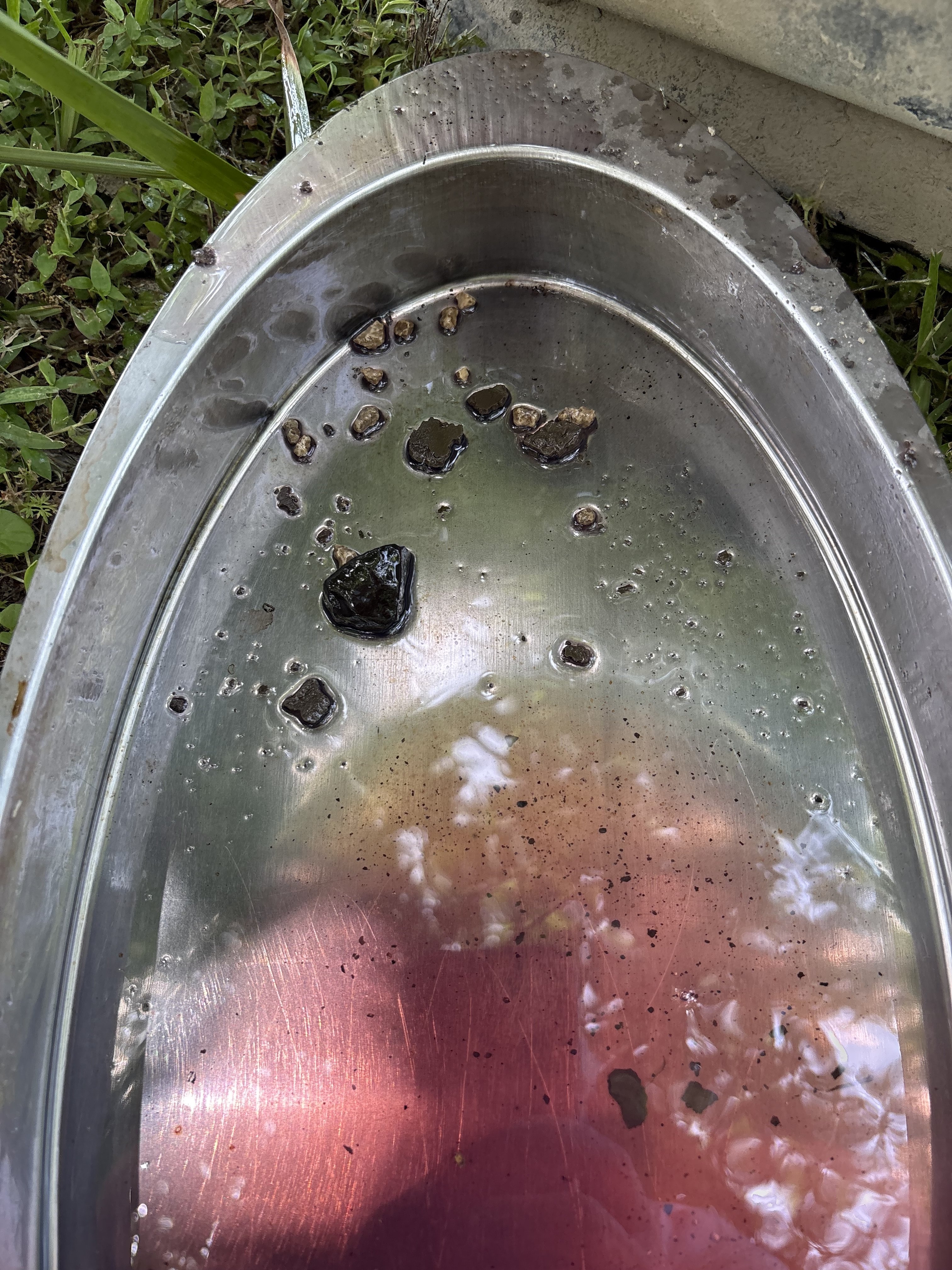

While out driving the utv(work machine) which has always had 22-25 mph speed capability something happened....Going along and cart instantly lost power and will not go any faster than 12-14mph now. UTV always run on flat ground, gravel and asphalt paved roads. Kubota D902 engine
Removed fuel tank and cleaned(there was actually rocks in it)
Removed fuel hose and fitting out of tank and removed rocks out fitting.
Replaced fuel filter
Replaced one fuel injector
Replaced air filters
Removed muffler to check for plugged spark arrester(none found) but ran/drove with muffler removed with no change in engine performance
After replacing the injector I am still not getting fuel to all the injectors as I believe it should be...One definitely is working correctly and will change how the engine runs when you crack the injector...The other two not so much. Bypassed the LP mechanical pump before the injector pump with an electric pump to test(tank to electric pump to injector pump). Same running condition. I'm beginning to think I didnt have a injector problem to start with and may actually a injection pump issue. Engine doesnt appear to be running up to max rpm's
Any suggestions...I dont want to throw alot of $$$$ at this machine changing parts that may not be needed. We need this machine at work but company not willing to buy us a new one at this time...
Todd

With a sudden loss of fuel at two cylinders, coupled with discovery of dirt and gravel in the tank that has to have been intentionally or unintentionally introduced, it seems almost certain that the two things are related. In theory the fuel filtration would have caught it, but maybe a fist full of dirt was too much?

I agree. Not pointing a finger at anyone. But makes you wonder....I too would have thought the filter would have caught the particulates. But if it was fueled with the engine running and with the known amount of stuff I got out of the tank when I flushed it....Then maybe, just maybe something got around the filter and wrecked the mechanical fuel pump, injection pump(cylinders not working) and plugged a few injectors. I thought i had an injector problem so I replace one with a Kubota one. No change in how it ran. I now believe I am not getting sufficient fuel pressure on two cylinders to get it to fire the injectors

Just a small portion of what was in tank

Wow.!! Somebody doesn’t like you..??
Yank the pump and send me all the injectors..
I’ll find the problem, if there is one..

Update.....It appears it was a injection pump failure. Boss gave me the ok to purchase a new one. Installed it yesterday evening. Cart is running again(kinda) I currently have two cylinders firing...The third has a leak on the injector like I didnt add a crush washer or didnt tighten it up....So I will pull it all down again to tighten or install the washer. On another note the LP fuel pump isnt working as far as I see...I have an electric connected currently with temp power. Guess I will replace the LP pump too. Then its on to a full service and repair the other known issues....

Second Update.....Cart is back to running on all cylinders. I did leave the injector loose. Also replaced the LP fuel pump and gasket. which was not working either. Can those pumps be rebuilt?
