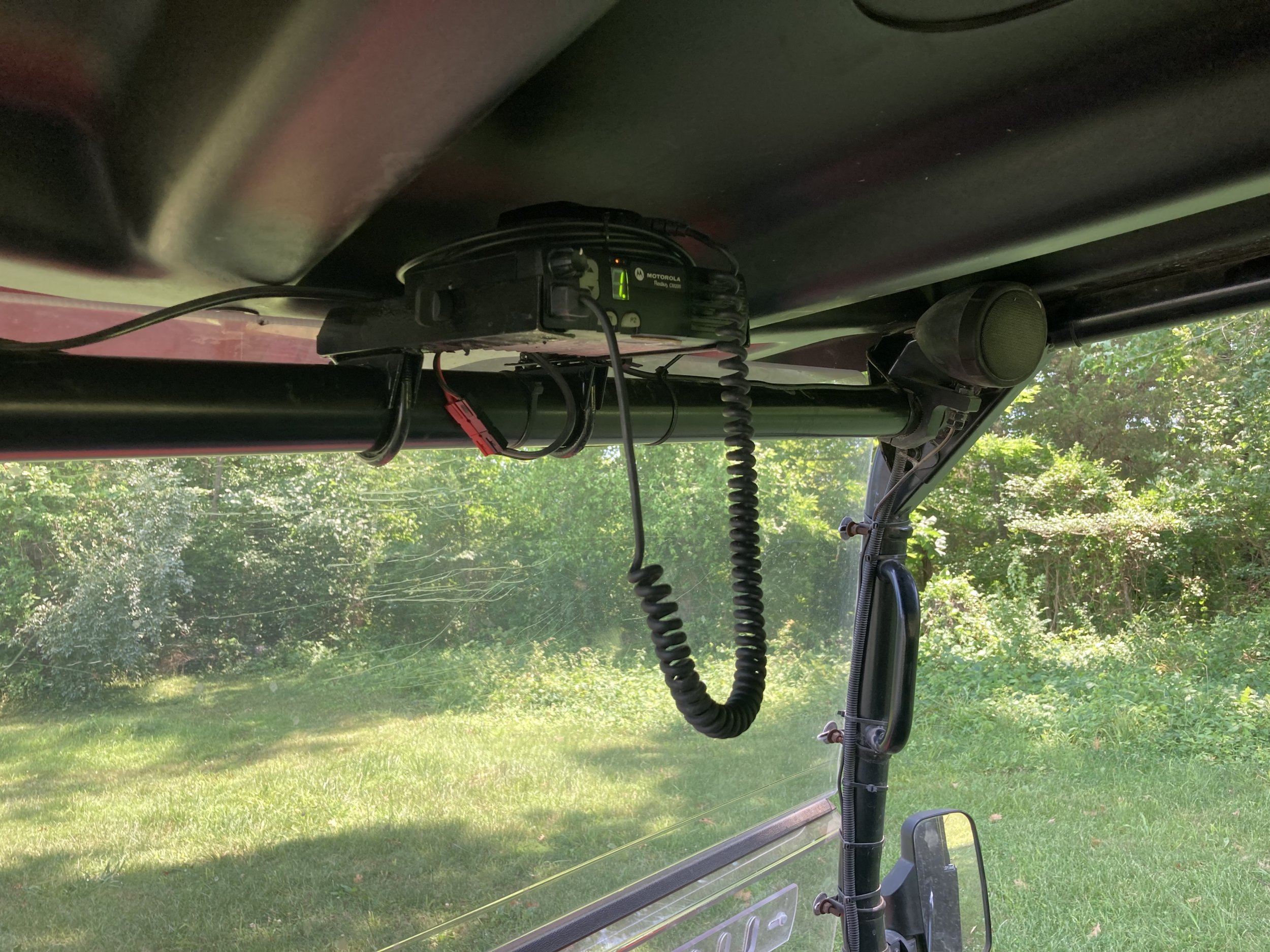

Here’s the CM200. The mount was made with 2” exhaust clamps welded to angle iron. Used power pole connectors

Wife and I got our license a few years ago. Have some dead cellular spots on the farm. Several good local repeaters. Station to station works good. Use HT Yaesu radios work well in the wooded, dusty tractor environment. Hooks on the ROPS. Can be hosed off.
