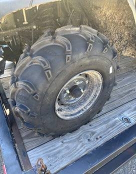

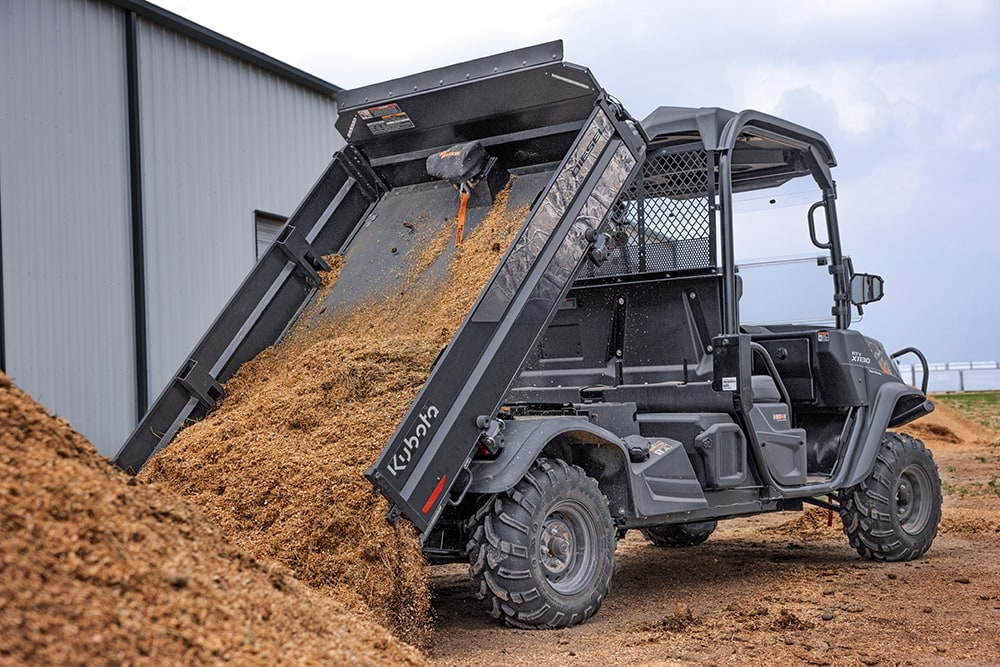

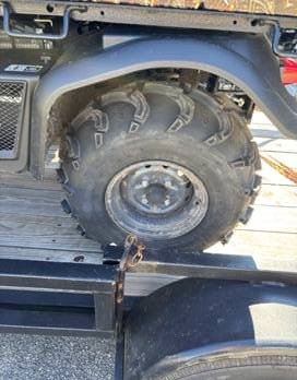

We have a Kubota RTV-X1100C with a 25 HP Kubota D1105 3-cylinder diesel engine. This engine provides the power for the utility vehicle, which is also equipped with a Variable Hydro Transmission (VHT-X) and standard 4-wheel drive. We live in North Florida on about 350 acres, and I traded a Polaris 900 Ranger for this Beast. It is a workhorse; a slow workhorse, but slow and steady wins the race! The hydraulic dump trailer dumps anything from Firewood to 5-7 rock. Look at the pictures @Paystar posted. It's great for taking material to our trails. We have a lot of uplands and lowlands. The lowlands and the stock turf tires didn't get along together, so we put a set of 29" ITP semi-aggressive tires on the stock rims, and it did not need a lift on it. I also saw a picture that I attached with one that had a winch in the bed. The tire pictures are the actual tires on our 1100c and have not gotten me stuck yet....fingers crossed.

No. Not good in the mud at all..
Mine does fine in the mud with the ITP tires, they are larger than stock, 29", and pretty aggressive.
Very cool! Are you running stock rims? Any lift or suspension adjustments? Do they clear easily at the full extents of steering? Thanks.
   / Kubota rtvx1130 #17
@otlski , Yeah, they fit on the stock rims. I was trying to find some aftermarket rims, but Kubota made the bolt pattern on these difficult since it has two studs and two bolts that go into the spindle. No need for a lift or any adjustments, and it has full range on steering.
