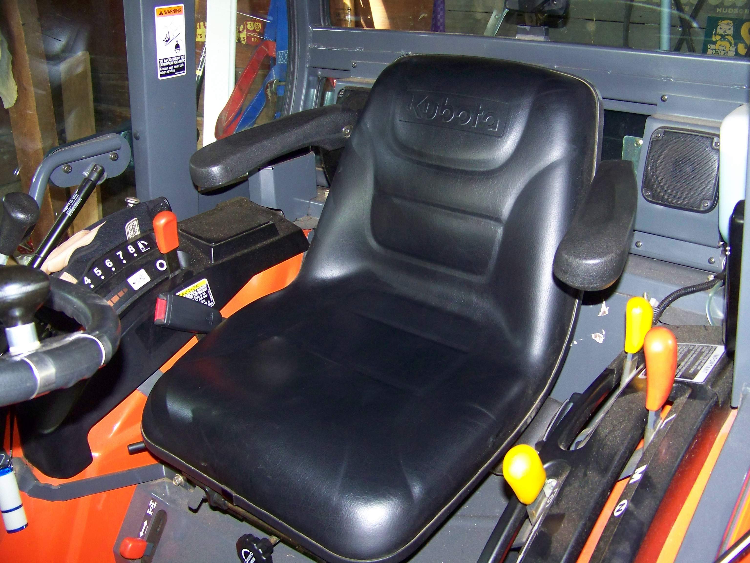

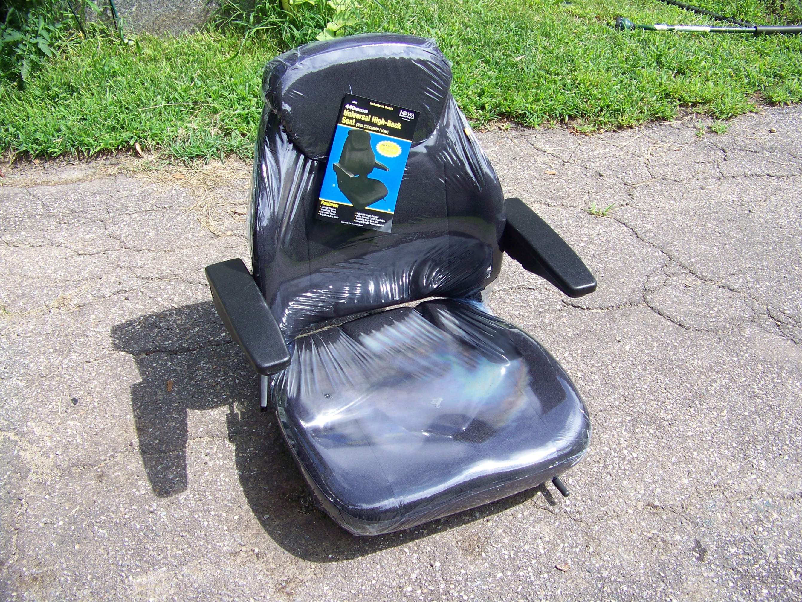

My B3030 had one of the old unpopular factory seats in it and was in need of an upgrade. Though the new seat Kubota offered is substantially better, I was looking for a few features it didn't have. I found a decent looking seat at Tractor Supply that seemed to fill the bill. Priced at $199.00, but I had a 10% off coupon which brought the cost down to $180........ add to that I had a small gift card, bringing my out of pocket expense down below $150. The Tracor Supply seat has a nice cordura cover, ADJUSTABLE (!!!!) armrests, ADJUSTABLE (!!!!) seatback, adjustable lumbar, adjustable headrest, and came on its own tracks. It even has a nice mesh pocket on the back should you want to leave a manual or perhaps a tractor magazine attached.

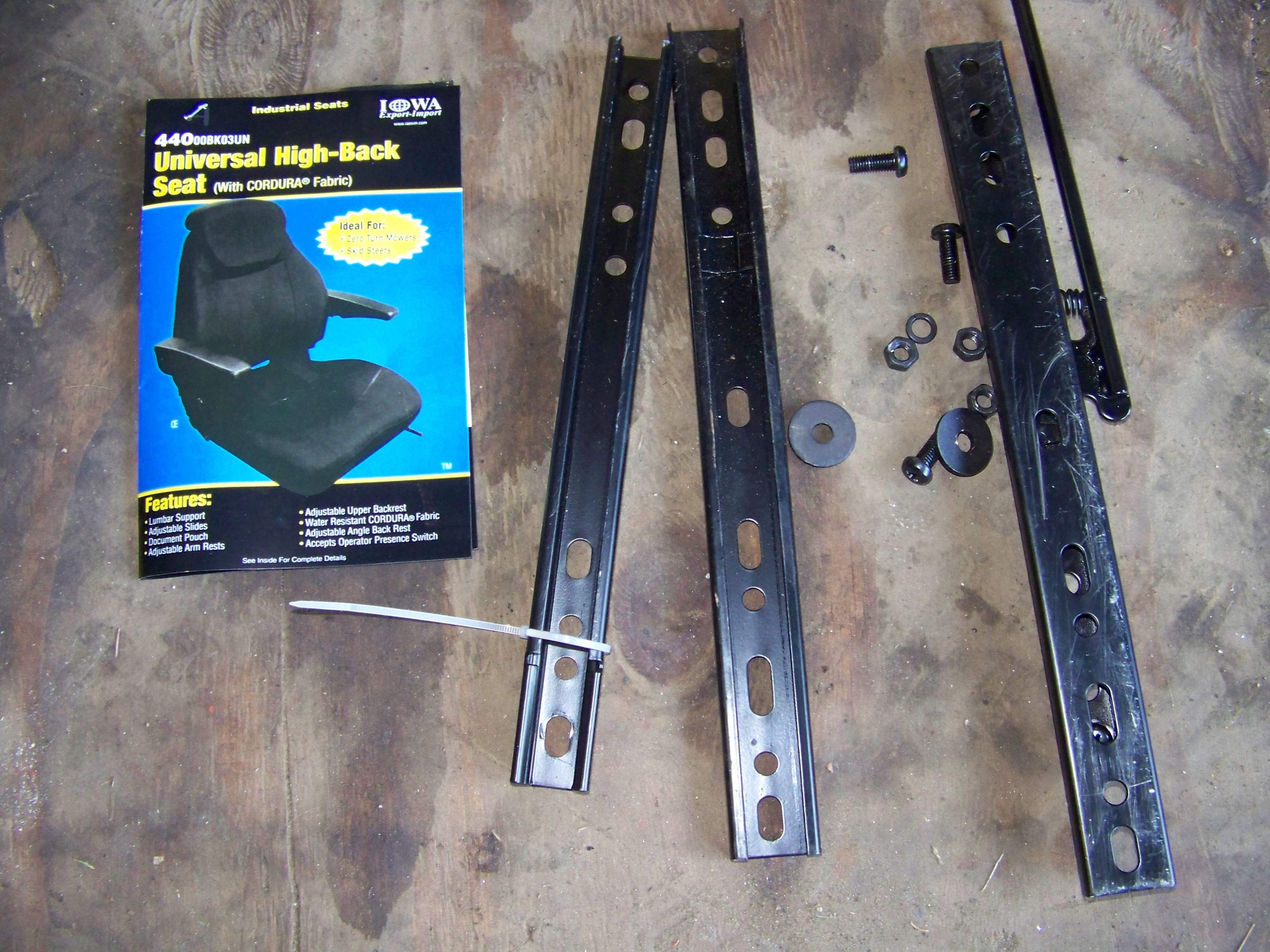

Fitting the new seat was fairly easy. Since my Kubota has a suspended seat with the seat track built it, I removed the rails from the new seat.

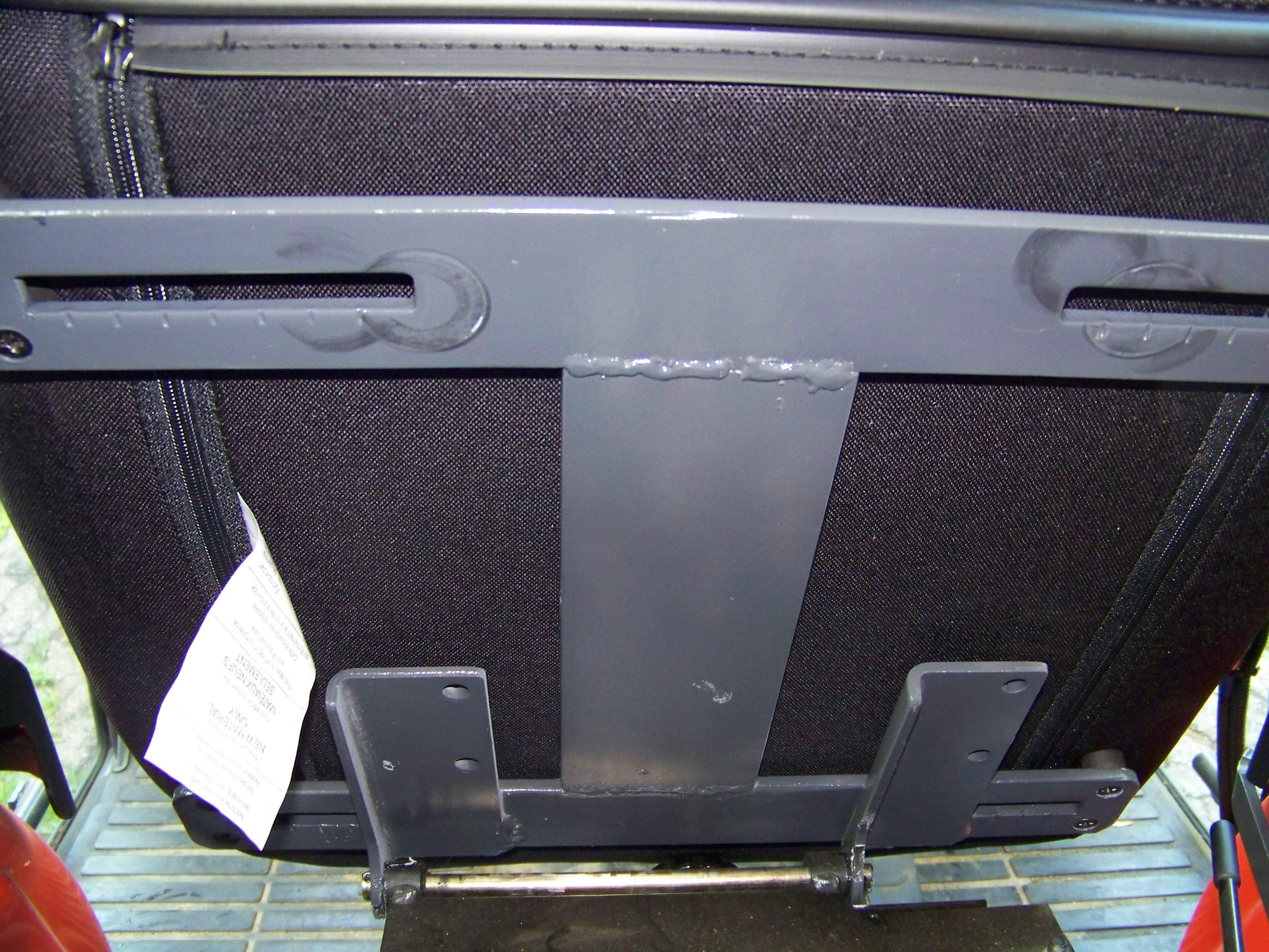

I unbolted and removed the old seat and simply clamped the new seat to the original 'hinges' (which allow the seat to be flipped forward) with a couple of vicegrips. Cleaned a couple small spots and tack welded the new seat bracket to the hinges. Using the original hinge brackets will allow both safety switches to be retained. I made one new brace to run between the forward and rear seat brackets, and welded it in place. This will do the job of the rails I removed from the seat and add reinforcement, as well as hitting the button on the operator presence switch. I gave the new seat bracket a quick shot of Kubota grey paint.

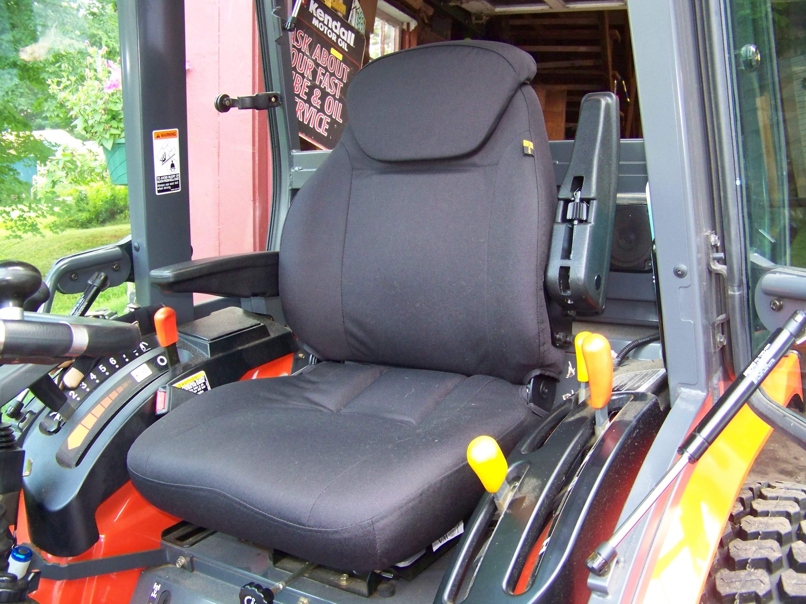

And...... the new seat is in ! The comfort level is in a different world compared to the original seat. All those threats of me having to sleep in my tractor by my wife don't look all that bad right now. :D

Nice upgrade! I like the "tip up" armrest photo, and the fact that there is all that additional adjustability!
Are the controls fairly easy to operate?
Nice, even "elegant" adaptation on your part, to preserve the function of the Kubota interlock switches, hinges, suspension, etc....
With a cabbed tractor, I agree--why not enjoy the comfort of a "cordura" seat cover?
The factory Kubota grey is a nice touch. Very slick "hack," overall--wish I could just order it that way! LOL
