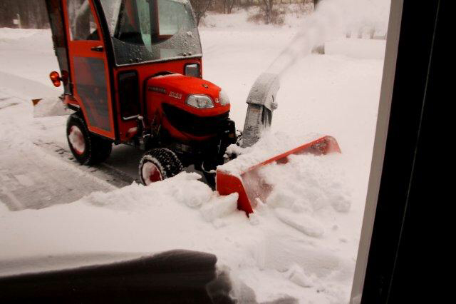

If you're handy with tools, welding, etc, it's easy to fabricate a bracket to mount a car power window motor for chute rotation (eBay, about $30). I used a short length of rubber hose with a couple of hose clamps as the "coupling" between motor gearbox and chute rotation worm screw. Chute deflection is by 12 volt 4" stroke linear actuator (eBay - around $80). I used a joystick switch mounted below the loader joystick, but a couple of toggle switches would work just as well. The 2750 is a great snowblower on the BX.

Any pics of your setup?
