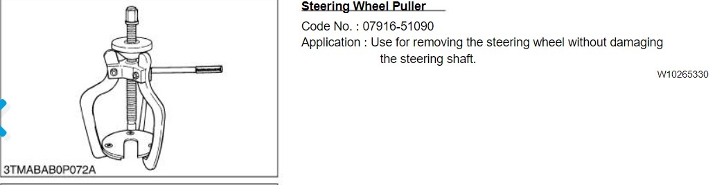

Kubota made a steering wheel puller, part no.07916-51090, but it has been discontinued. Saw a price for it as slightly over $1k. Probably did not sell many of them at that price.​
   / Kubota Steering wheel removal help needed. #18
Doesn't look like it should be $250 / pound:)
