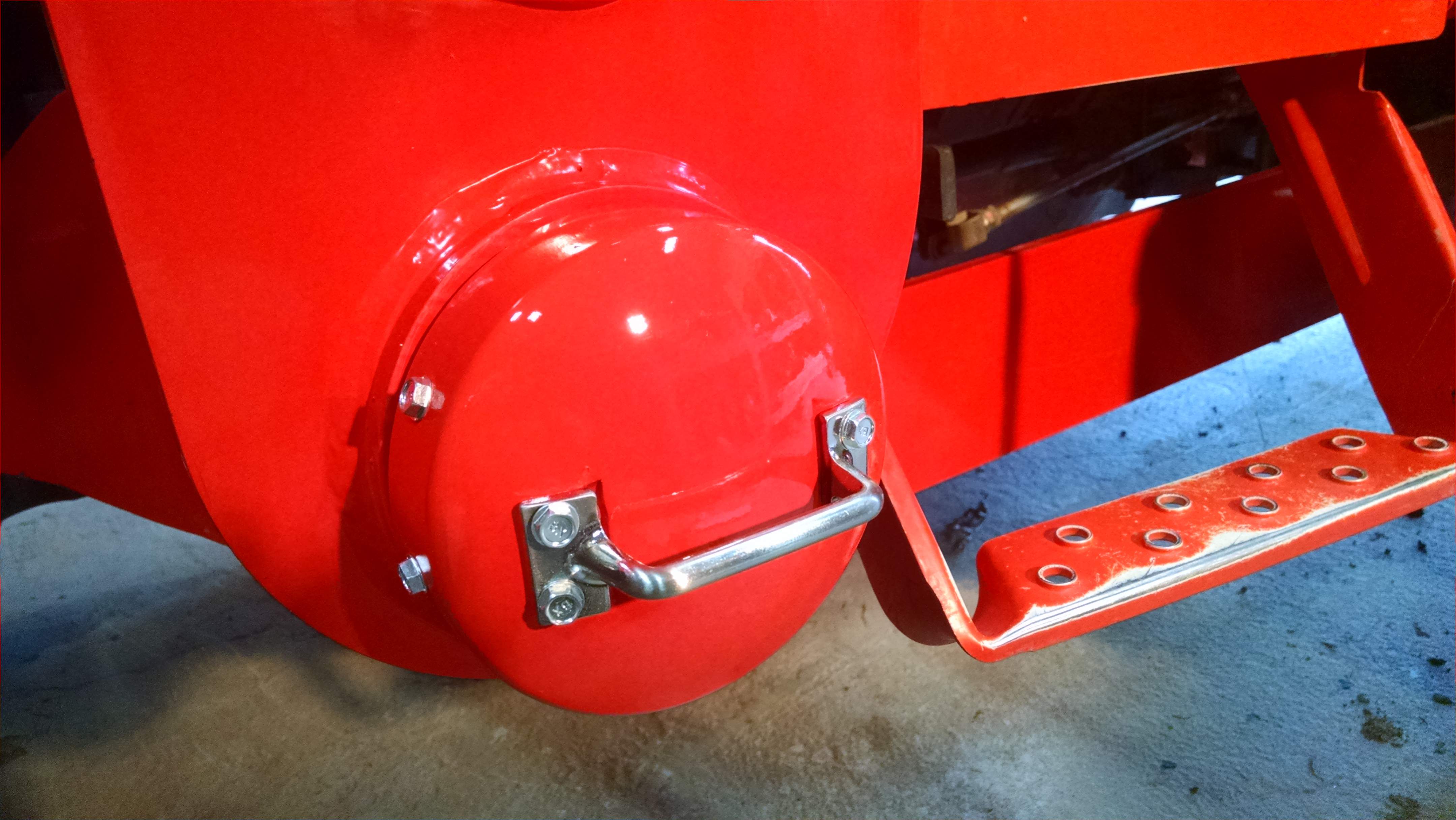

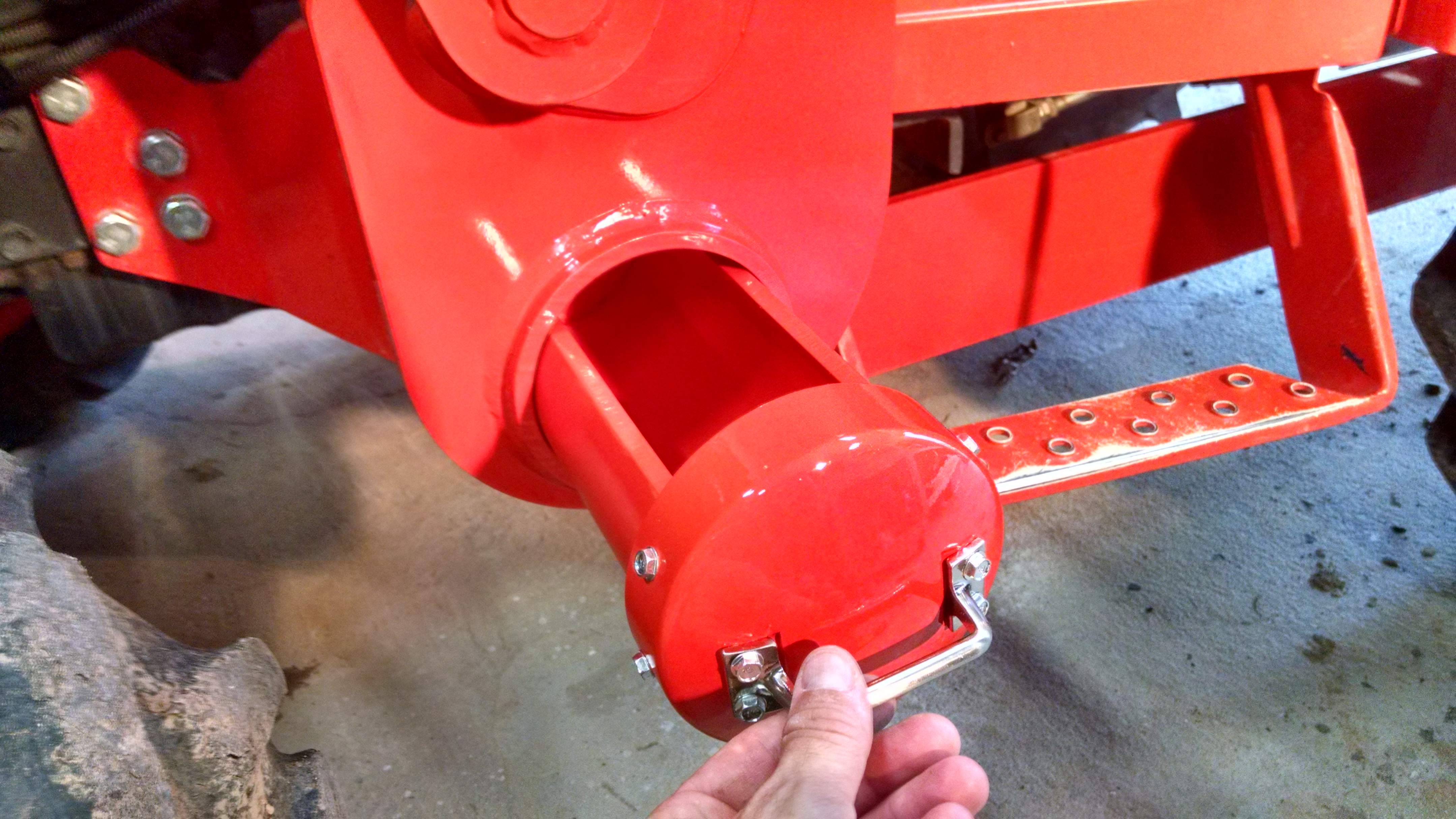

Made these storage compartments out of 4" PVC for my L3200. They worked out great and I have tools, and misc. stuff in them. What do you think?

That looks really neat. How is it closed on the back side? And what holds it in place while you are working?
/ Kubota storage comparment

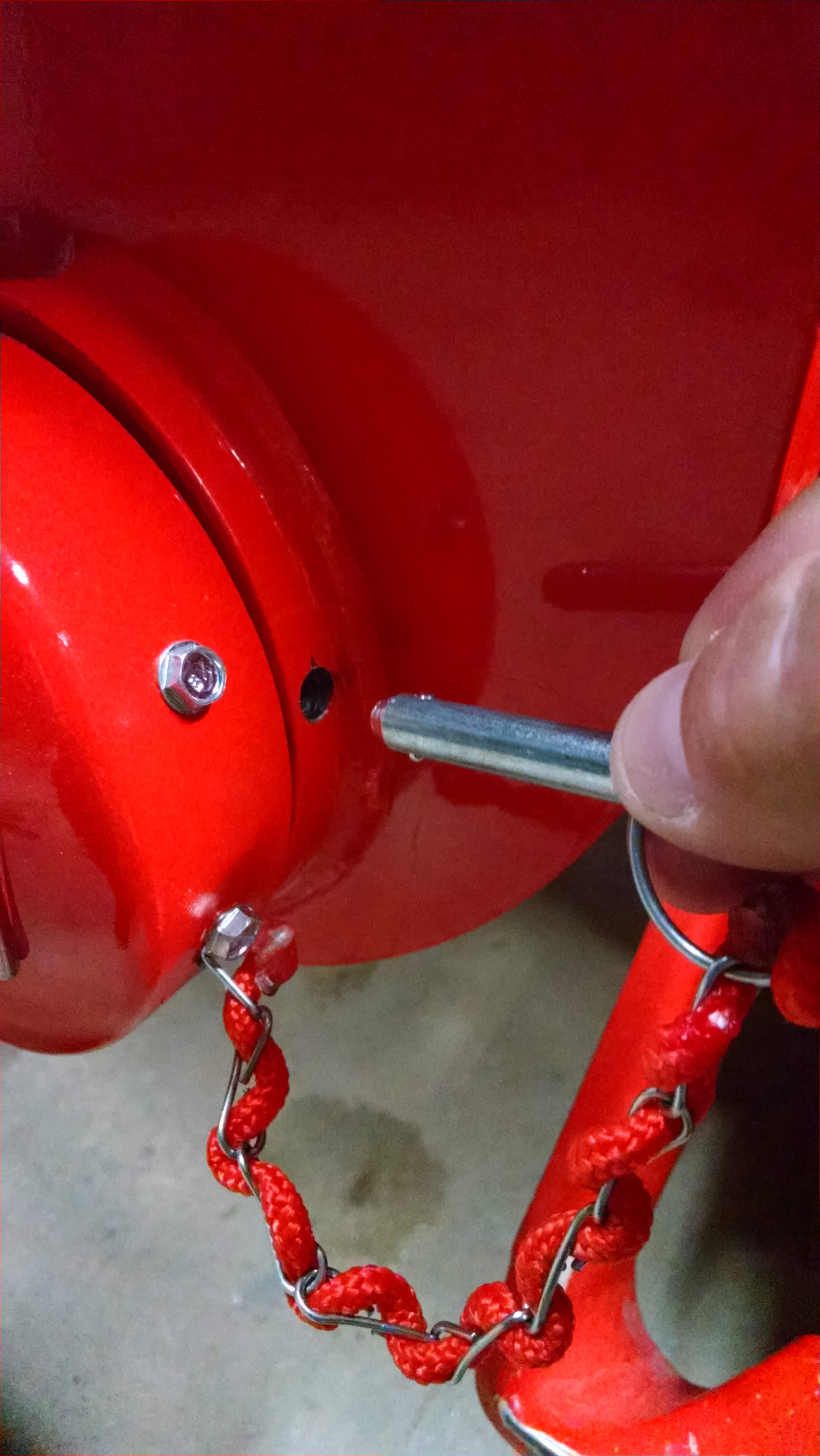

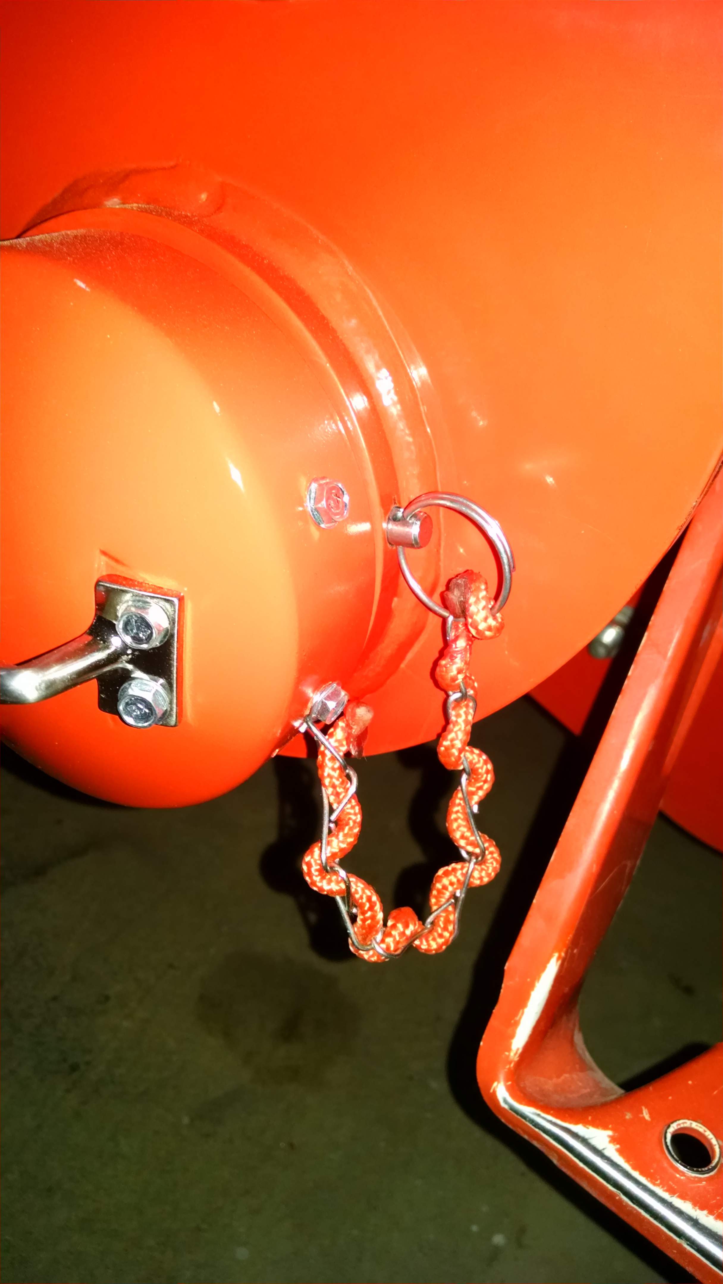

A 4 inch cap is on the other end. I drilled a 5/16 hole in the protruding portion of the round support bar, and through the wall of the PVC compartment. A coupler pin snaps in the hole which holds the compartment in place. I will try to add some pictures soon. Thanks for the compliment !

What was used at the end to box in the end of slide in and out porcine.

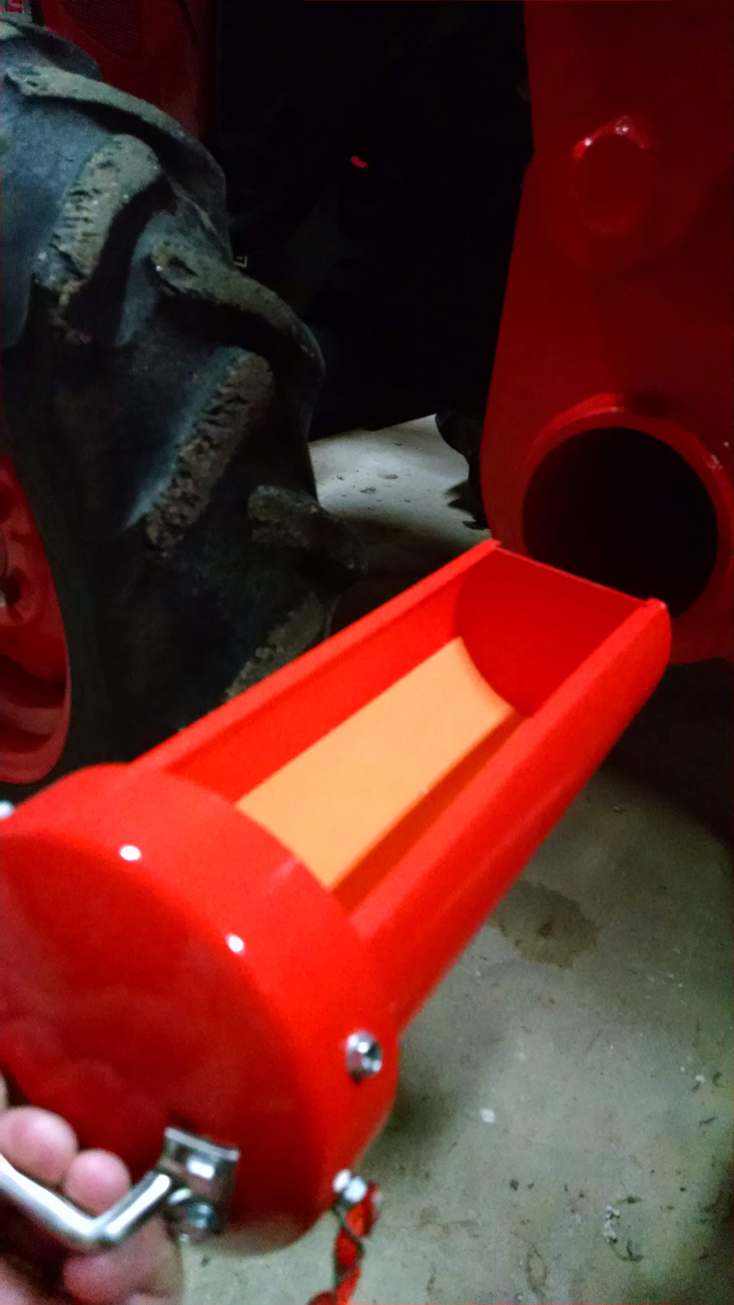

Did you scuff up the PVC before painting? Are you seeing the tube get scratched up as it comes in and out, does it have a lot of friction as it slides?

Great use of an unusual space! I may adopt your PVC idea but affix it to the ROPS (for longer tools). I guess that water could penetrate if it were left outside and it rained. Perhaps you could, "incorporate an O-ring into your ingenious invention". One that would slip over the 4" PVC and would be retained by the cap, A Dremel tool to divot the circumference of the cap to get that snug fit.

Is yours deep enough to hold a chainsaw file? That was the first thing that popped in my head for a use.... that and spare chainsaw chains/rag's.

A thought, instead of screws PVC glue could have been used.
Someone suggested using an O-ring, if the ring was about 1/2" in it would create a snug fit and possibly eliminate need for the PIP pin.

It's exactly 1 foot long, so yes a chainsaw file and extra chain will fit. This tube does not go all the way through to the other side, they are only about 1 foot 2 inches on each side so it worked out perfect. I have a tie down strap (ratchet type), 3 wrenches, two screw drivers, vice grips, chain saw tool and file, and pliers in one compartment!

Not only do I like the clever idea of doing this in the loader frame tubes, but think of cases where you could simply strap on a big PVC pipe and then make a smaller PVC pipe drawer that slides in and out. I think the circular cross section would have many advantages on a tractor. Makes a real convenient drawer shape for tractor use.
PAPPASMURF, how did you slice the pipe lengthwise -- table saw?
Band saw with a guide. :)
The caps are glued, and screwed I was just making sure the cap would never pop off! lol :cool2:
