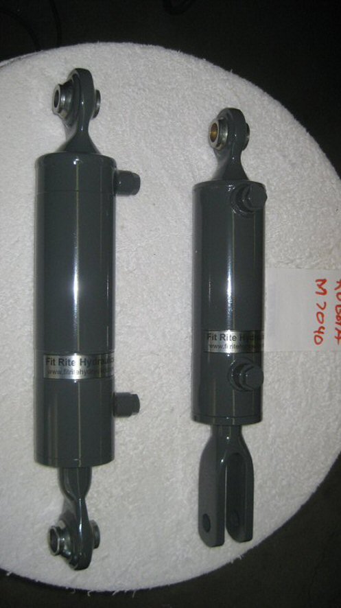

   / Kubota Top-N-Tilt concerns #14
Run the stock manual top link all the way in & all the out. Those measurements should match more or less for the hydraulic cylinder.
The cylinders (3 tries) from the dealer were leaky mis-sized pieces of crap. My FitRite toplink came in Wednesday & the sidelink came in yesterday. Toplink is working great in the 2 minutes of testing & getting the air out I did. Might get the sidelink in tonight.

so would you say it looks like both my cylinders are too short?

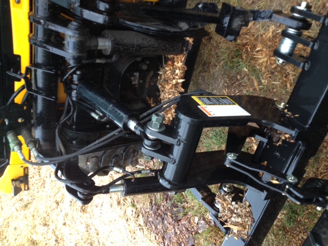

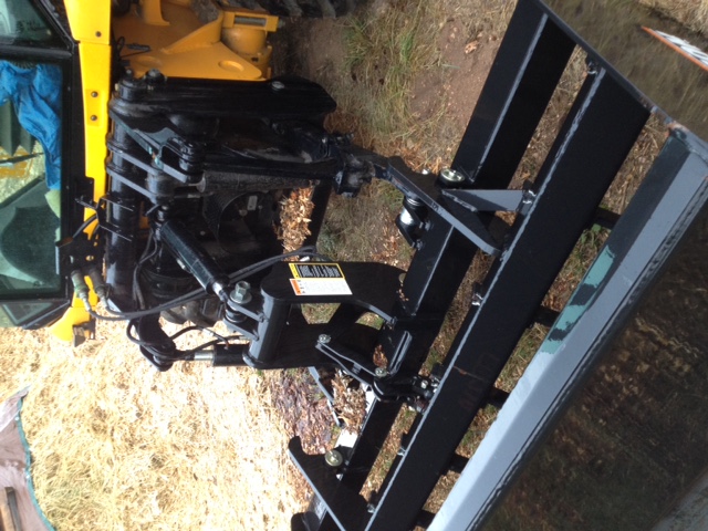

I have a similar blade with hydraulic rippers and factory T&T on my JCB. I use this all the time for snow removal and driveway grading and my factory T&T does not have float. I simply lengthen the top link and put the 3 point in float to smooth out gravel roads in forward and opposite in reverse as I shorten up the top link. I can see implements that having a floating top link would be nice but the box blade works fine without IMO.
Here is a factory T&T setup. Cylinders are over 1-1/2".

You are correct, I have found that the cylinders provided are from Gearmore.
A little more info my side link has a 4 inch stroke...2 inches too short. My top link has a stroke of 8 inches...I guess one little inch will make that big a difference? I feel I should go with a ram that has a working length of 10 inches...
Either way, my salesman came out yesterday and took some measurements & part numbers and said he'd get me the correct ones...I'd rather give these ones back and get what I paid, and get em from you. But, if they replace them with the correct units guess I'll be good that way too. :thumbsup:
I appreciate everyone's input. Thank you.
