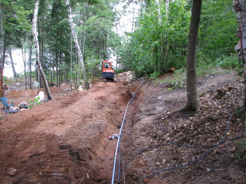

Well have a couple of more pics of the ongoing project. We have spent a lot of time cutting trees, chipping and splitting in the last month. Finally have been able to get back to the drainage ditch and power supply. The first pic shows the ditch with the tech cable as well as the light line, which has conduit added for protection.

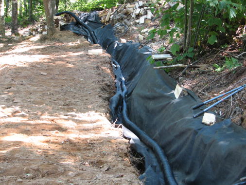

Same ditch with the geotextile and big O pipe.

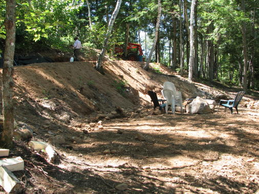

This pic gives you a view of the firepit area along with the amount of drop from the above road. We had to do quite a bit of excavating to get the area level and that size.

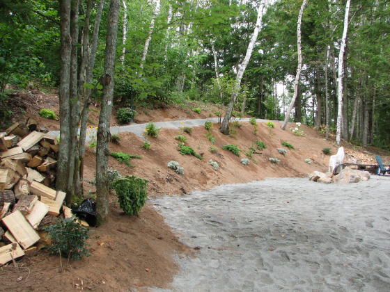

Finally got to the end of this project. We geotextiled all the road and fire-pit area then put between 3" and 8" of crusher dust on all, about 80 tons. Planted 60 plants on the two slopes with the timing of colours and locations to the seasons. The customer wants this to grow back in natural except for the plants therefore no mulch applied.

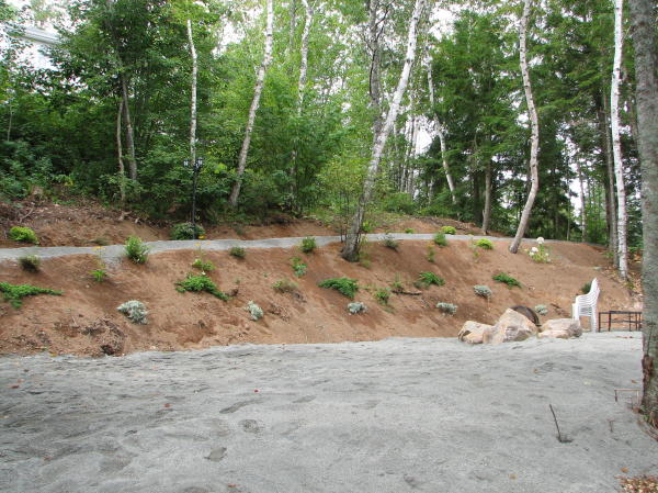

Another

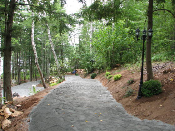

Last one,
Notice the light post, this is one of 5
