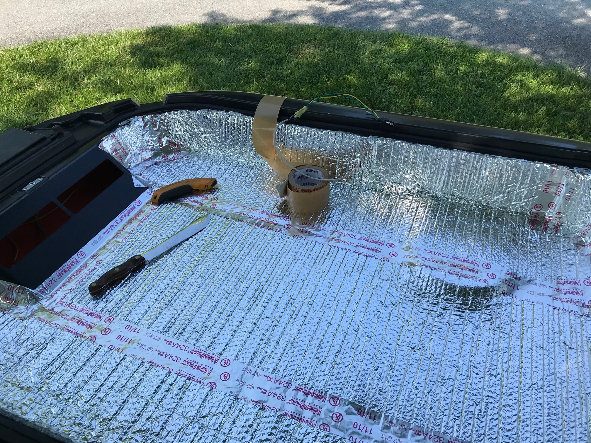

"I have insulated the floor with Kilmat everywhere I could on the floor, tried the roof but it interfered with the flow of return air so had to remove it. "
While my lid was off to replace the TX valve on the A/C, I lined it with the double-foil bubble Reflectix insulation. It's fully glued and the seams taped with some quality foil tape. I also glued some spacers in a number of places made from dense closed cell packing foam to ensure clearance in case any glue failed. So far, so good.

I really like that, we may try again this winter like you did. Mine has a different roof system and the least little interference with the air flow kills the return air. I haven't given up completely tho, yours is worth a try. TY
