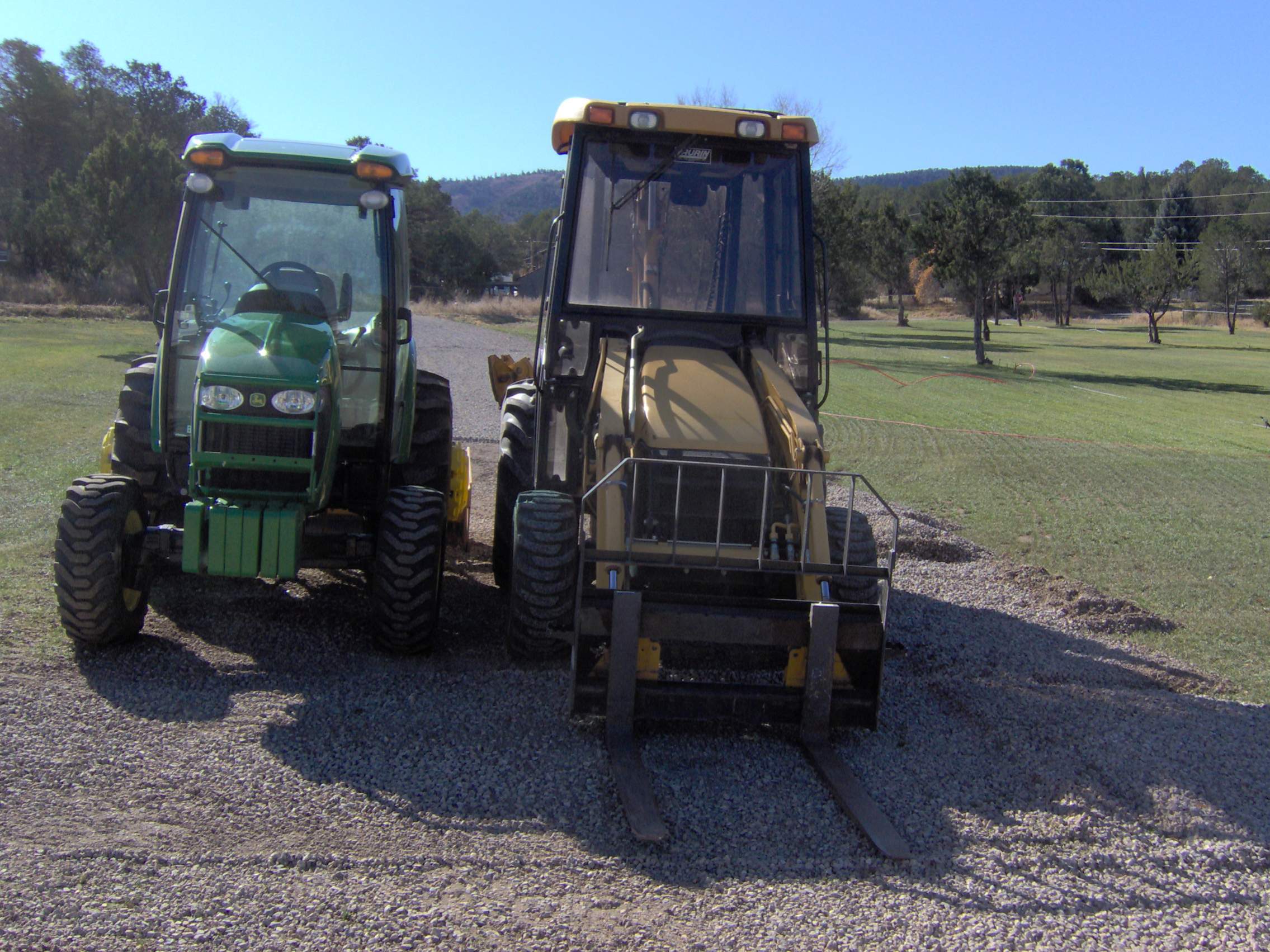

There is a pretty big physical size difference between some of them tractors. Like the 3430 and Deere 4120. But when shopping the used market, makes it really hard to keep comparisons apples to apples. And when it comes to lots of ground clearing, stumps, roots, etc. A compact tractor and fel wouldn't be my equipment of choice. And definataly not for trenching anything.
Yes. Its very hard to tell from pictures as there arent many pictures with the right angle and with a frame of reference, like an average size guy standing next to the tire. Who knew nobody wants to be seen next to their cool new tractor! :thumbsup:
