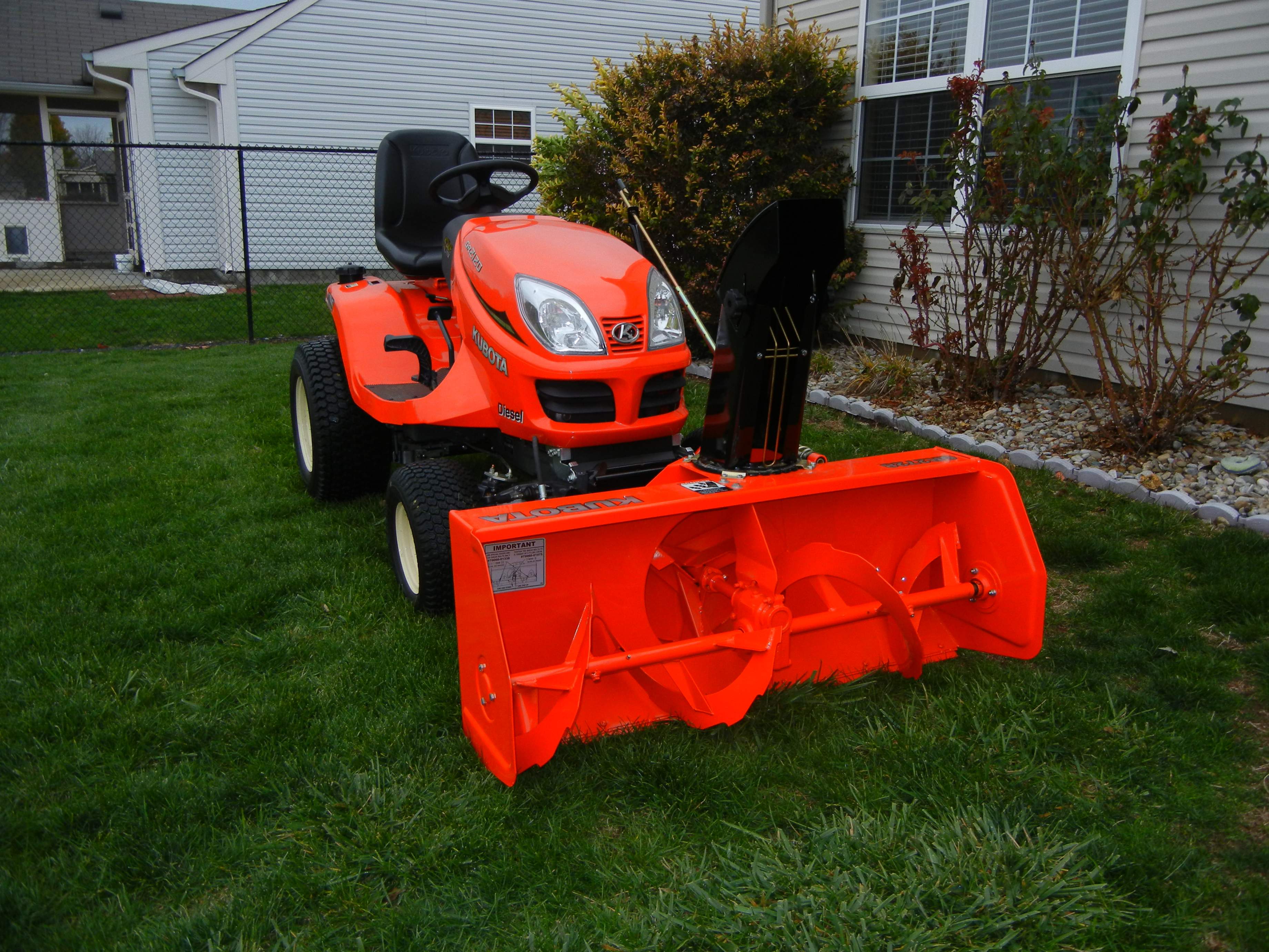

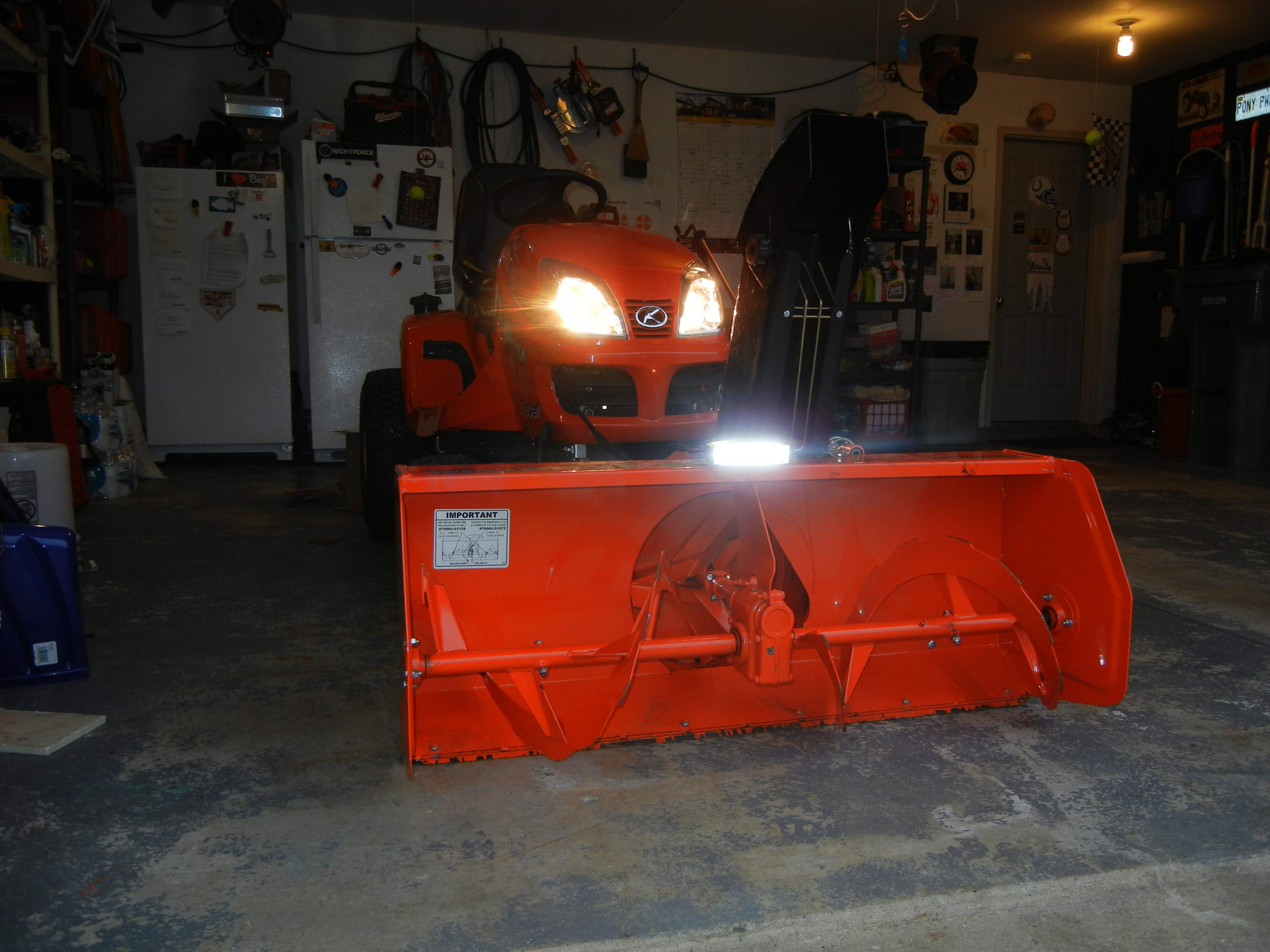

The 4WD is definitely an attractive feature. Not totally encouraging that the Deere went through several transmissions. I plow snow from my driveway...not a long driveway but it gets drifted in really high - like 4-5 feet at times. Wonder if the snow blower would do the job on something like that? You say it works real well. The issue I have here is that there is no room to plow the snow and push it in the direction of the side of our yard - so for the past 37 years I've been pushing it across the street (all woods and field...no problem in that regard) but, still, it's back and forth many times - have to watch for traffic and then I sometimes wind up having to shovel out the stuff I plowed to make room for more! Wonder if the snow blower (if I get the KB) would be a good investment instead of a blade? The blade the guy wants to sell me is the 48" - really about as large as I have comfortable room to store.
   / Kubota vs John Deere x570 #12
I had a blade and a snow blower for the JD LX188. When I got the GR2120, I only got the snow blower. With the snow blower, you can move or displace snow to another location. With a blade, you are only pushing it aside, turns to ice, snows again, push it aside into an ice pile, and the trend continues (from my experience). With the blower, I displace the snow 20 feet away to another location and do not have to deal with it again. I am not sure how well a tractor this small and light would handle a 5' drift? Probably not. Philip.

Looked at your pics...I see what you mean...that blower looks quite impressive! How does it do with the various mixes (snow/sleet/rain/ice)...which is the stuff I hate the most to try and plow. Does it blow heavy, slushy stuff like that? I have an old Bolens snowblower that just never worked very well to begin with, but especially not with anything other than pure snow.

The snowblower does not work well with rain ;) Sleet, cannot really comment. Snow, dry or wet, does a great job as it is a 2 stage blower. The only time it does not work well, as with all other blowers, is when I get to the end of the driveway and I am dealing with a slush that the salt truck created when he was plowing. That salty slush does not blow well and can clog up chute if not careful. Philip.
