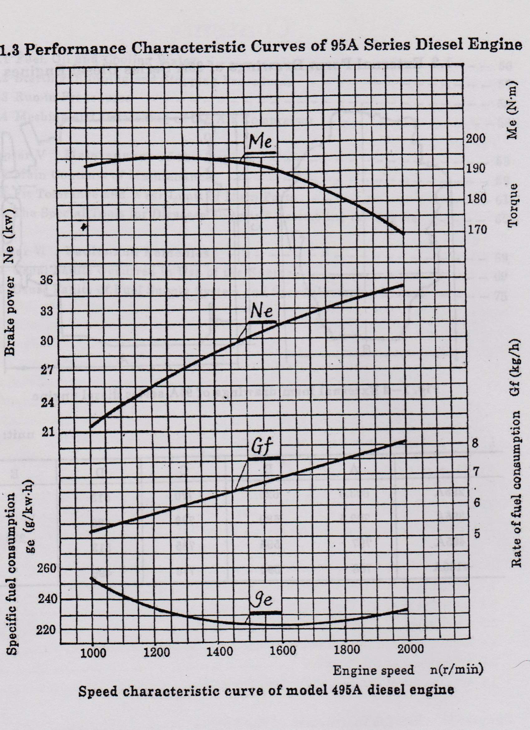

View attachment 372140 View attachment 372141
Here's an interesting comparison- the Kubota graph posted and one from an older lower revving and larger displacement tractor engine
two tractor engines with equal peak rated horsepower- which one has more average horsepower and will do more real world work when run at non peak rpm... as in pulling a plow or other heavy implement from a dead stop in a geared transmission tractor :stirthepot:
I believe a higher torque / lower peak rpm engine is better suited to tractor work.

I avoid major math because it doesn't suit me ... but just out of curiousity, I don't suppose you'd be able to find & post the graph for my engine, or to see how it rates here in this test???
Iseki E4CG, 4cyl, 2.2L, 134.05ci, 21.8:1 compression, Bore/Stroke=87mm/92.4mm, Max Torque=103.6 ft/lb (or 140Nm) @ 1500rpm, torque @ 2600 rpm = 95.1 ft/lb (or 128.9Nm), torque rise= 9%, Engine HP (gross) = 47.1 (or 35.1kW) @ 2600rpm.

Sorry TSO i don't have a graph for the Iseki
I should say that i don't believe there would be much of an advantage for the engine I posted when used with a Hydrastatic drive tractor- when the tractor is operated at rated speed/power all the time.
