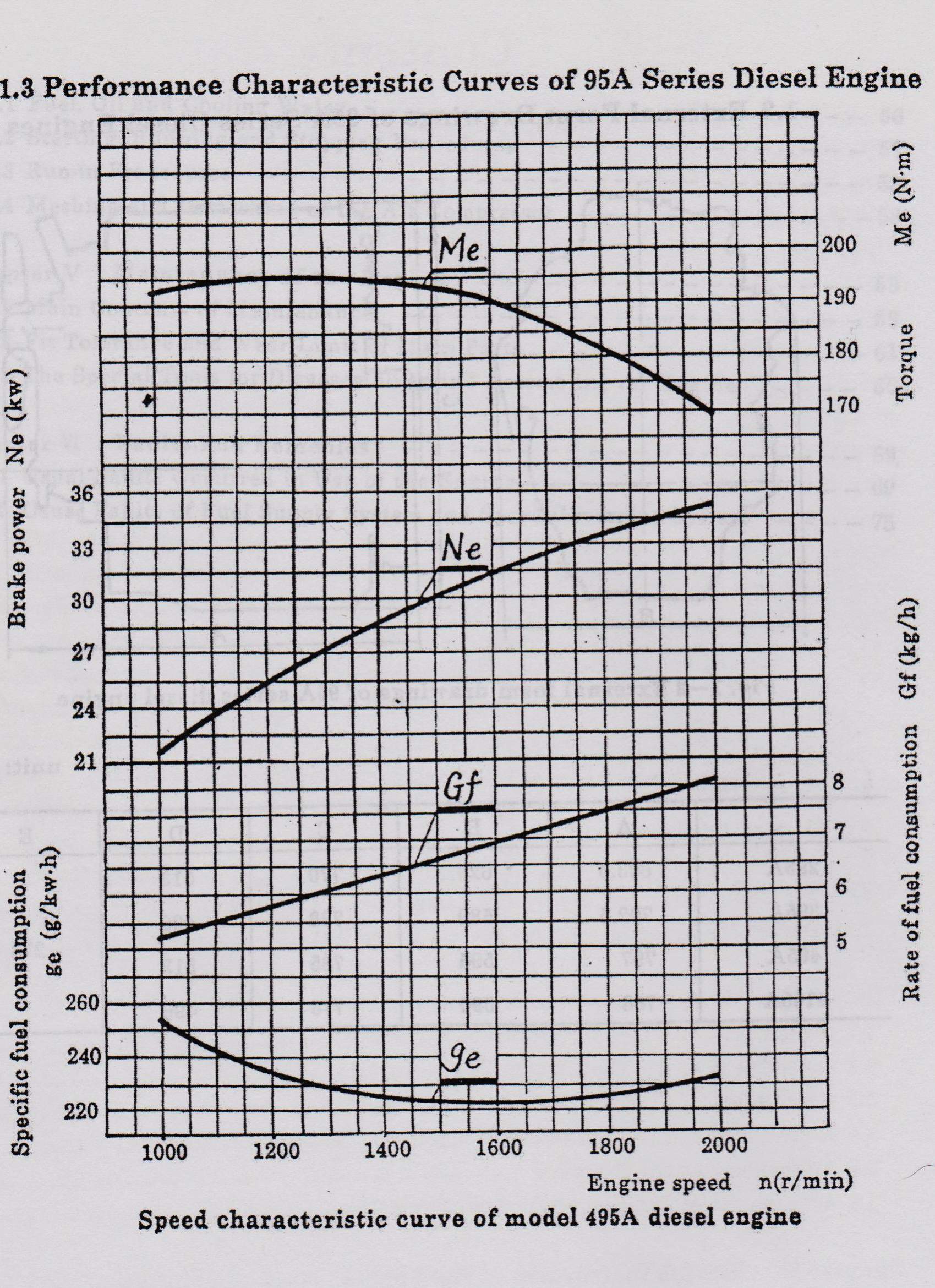

View attachment 372140 View attachment 372141
Here's an interesting comparison- the Kubota graph posted and one from an older lower revving and larger displacement tractor engine
two tractor engines with equal peak rated horsepower- which one has more average horsepower and will do more real world work when run at non peak rpm... as in pulling a plow or other heavy implement from a dead stop in a geared transmission tractor :stirthepot:
I believe a higher torque / lower peak rpm engine is better suited to tractor work.
attachment problem? View attachment 372157
I'm not quite sure what situation you're proposing here. Are you talking about getting the engine up to full operating RPM quicker, or are you talking about intentionally running the engine at lower RPM?
