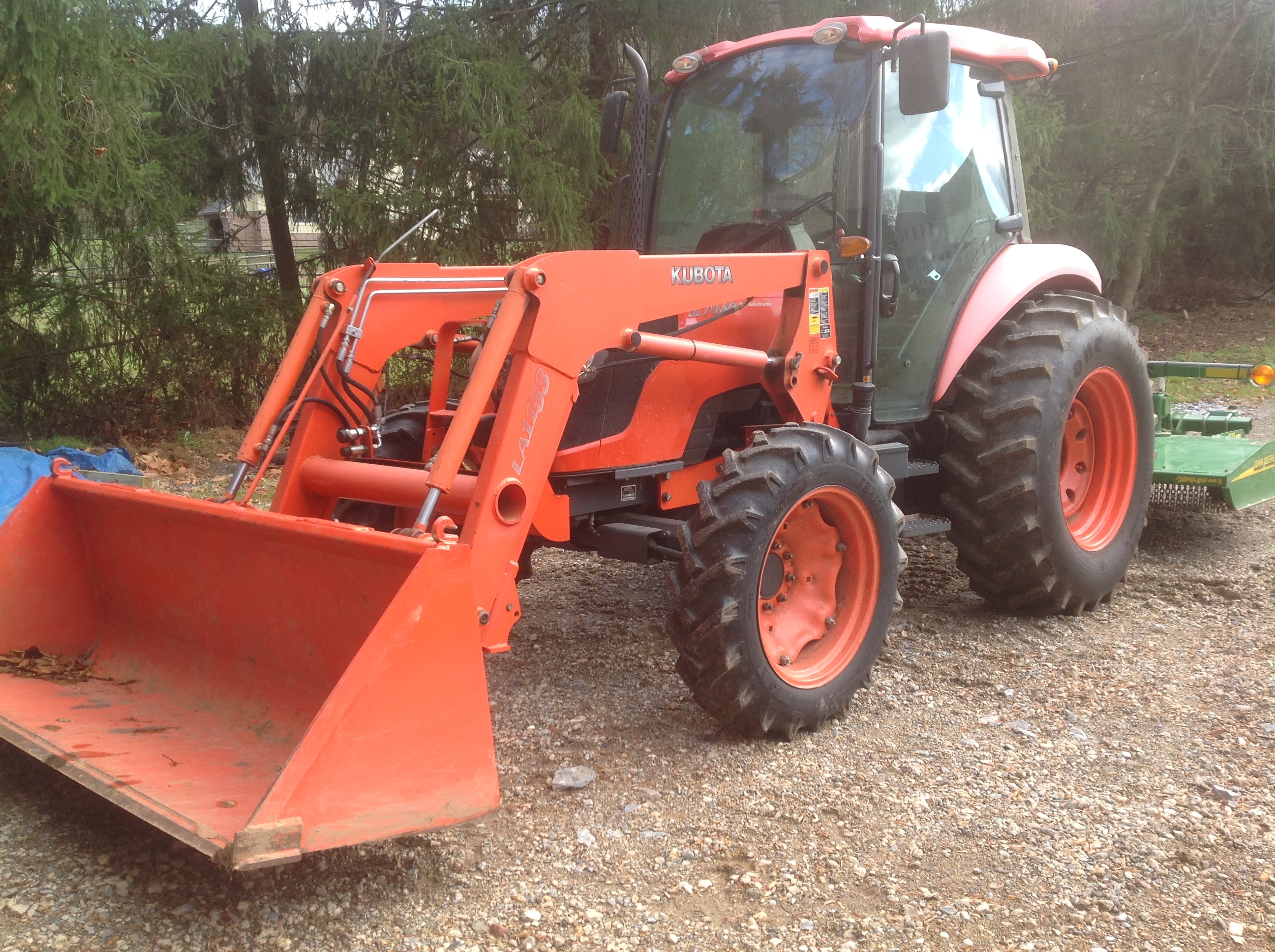

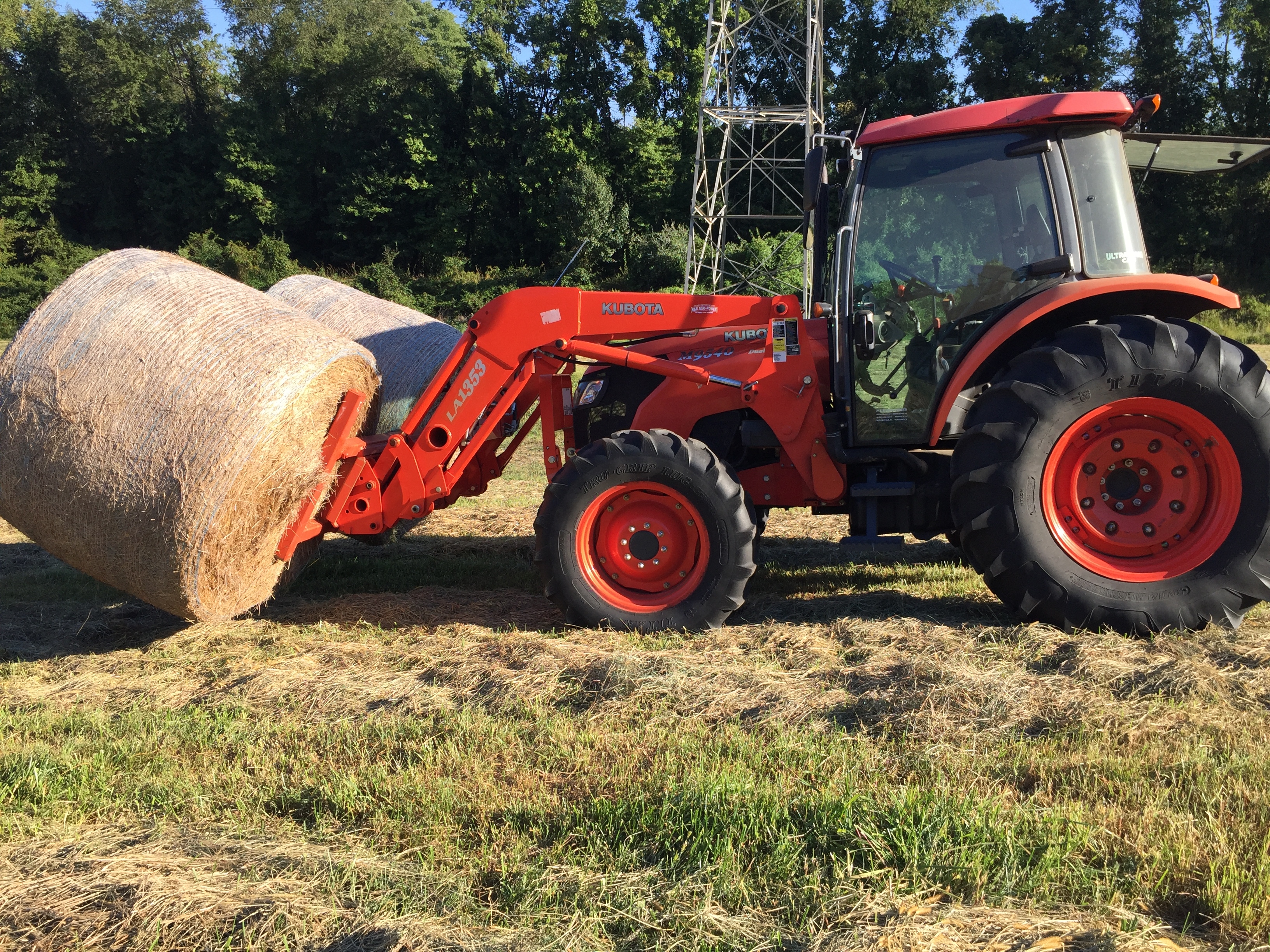

I owned a Kubota M9540 “Dual Speed” for a few years about 10 years ago. It was a nice little tractor. I bought it used from Indiana with very low hours. But the only version I liked was the “Dual Speed” version because it was loaded with extras, had the 24 speed transmission, and had the rear wheel weights cast centers. Also had extra remotes and 3rd function on loader. You can see mine here handling 2 round bales. It struggled with them. Those bales are about 900lb each. I owned this tractor for 2-3 years before I knew it was too light.

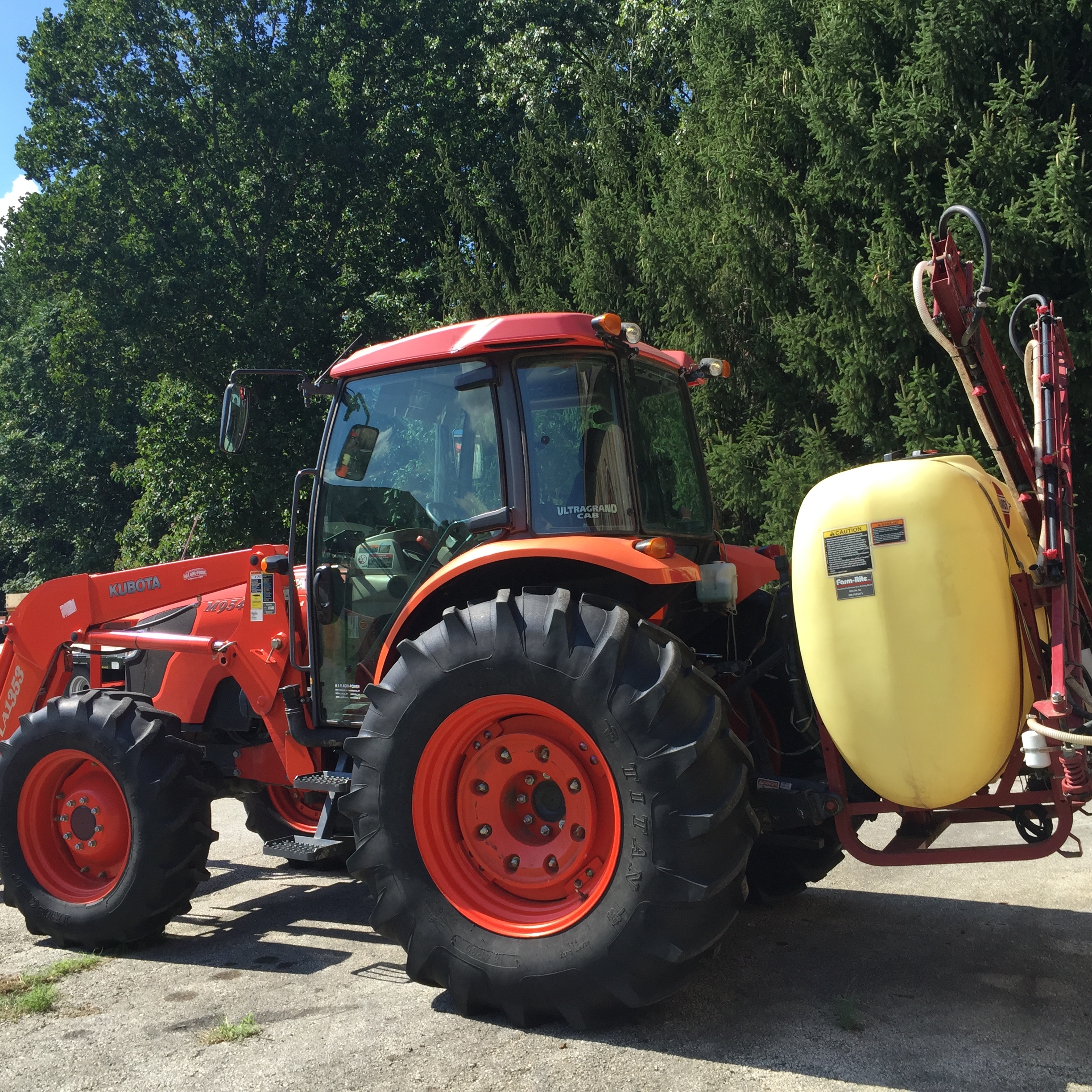

Here it is with my sprayer. Easy work for it. Dual Speed transmission was nice, but nothing like a full powershift or CVT.

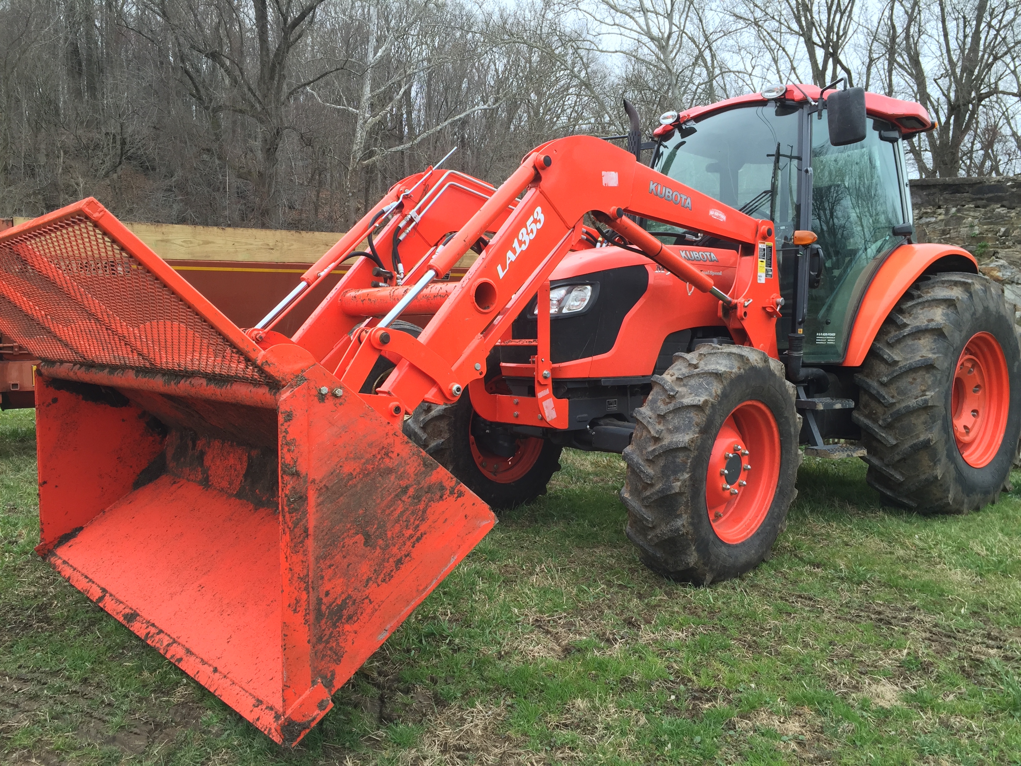

Here it is doing loader work.

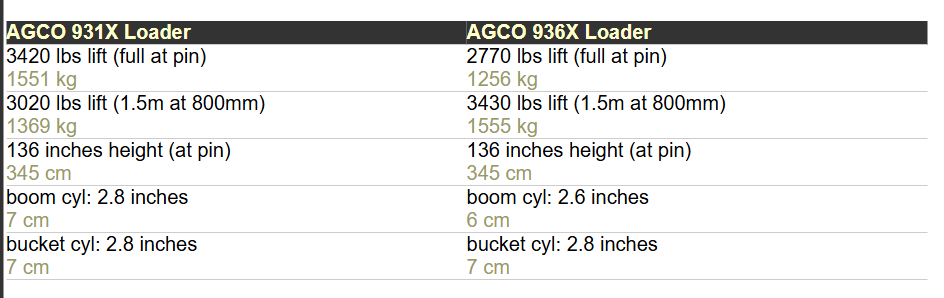

Here’s the Tractor data comparison:
The Massey 4709 is similar HP, but weighs a lot more. That extra weight would have made carrying heavy objects in the loader easier. On the Kubota side, I do like a 4cyl engine over the Massey 3cyl, although I heard that little AGCO 3cyl is a beast.

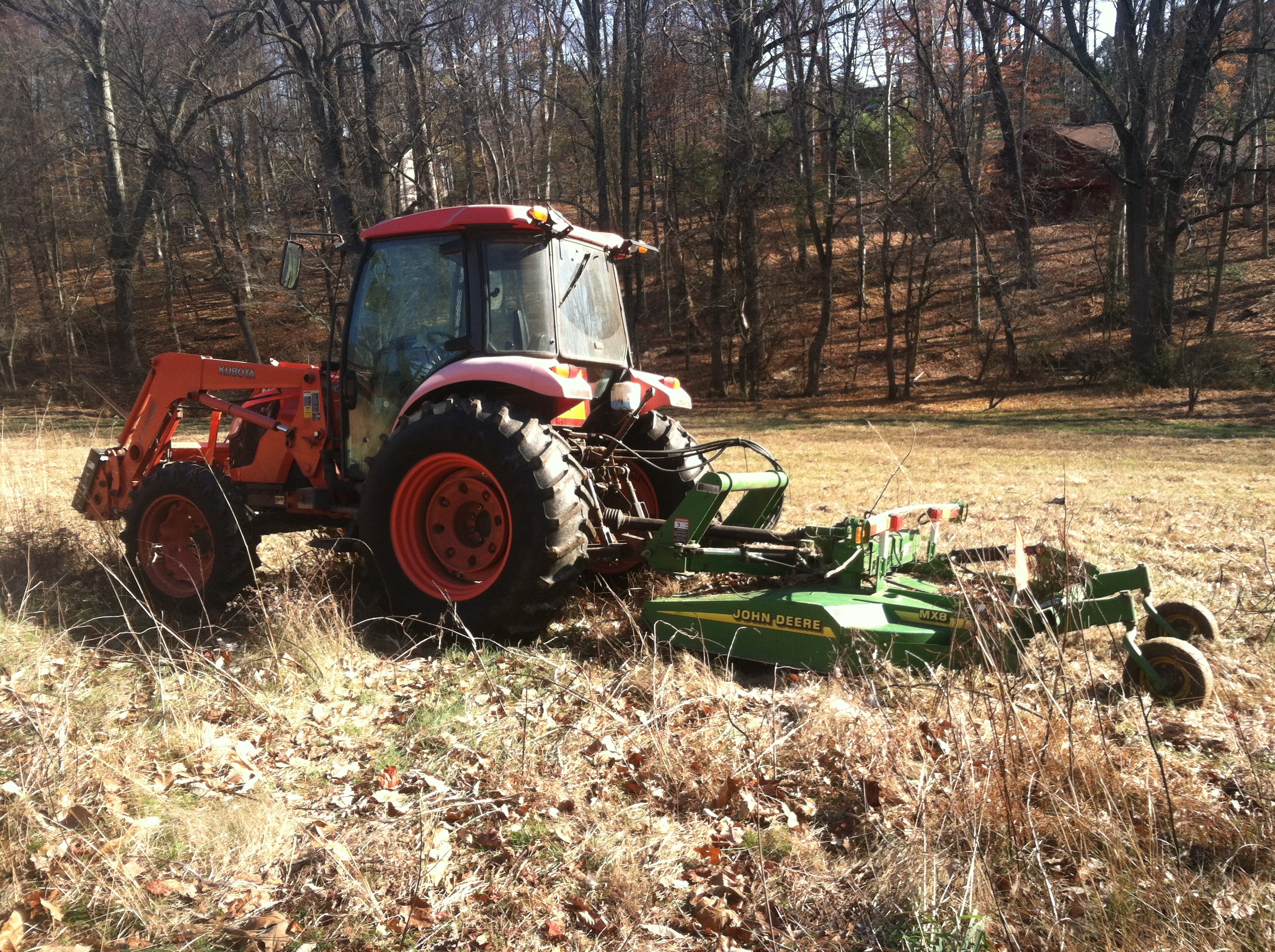

I also owned a Kubota M-7040. It was the non-turbo earlier version. Again, good little tractor, but built light for light work. Very reliable. Here I am mowing a field with it 12 years ago pulling a 8’ dual spindle mower.
