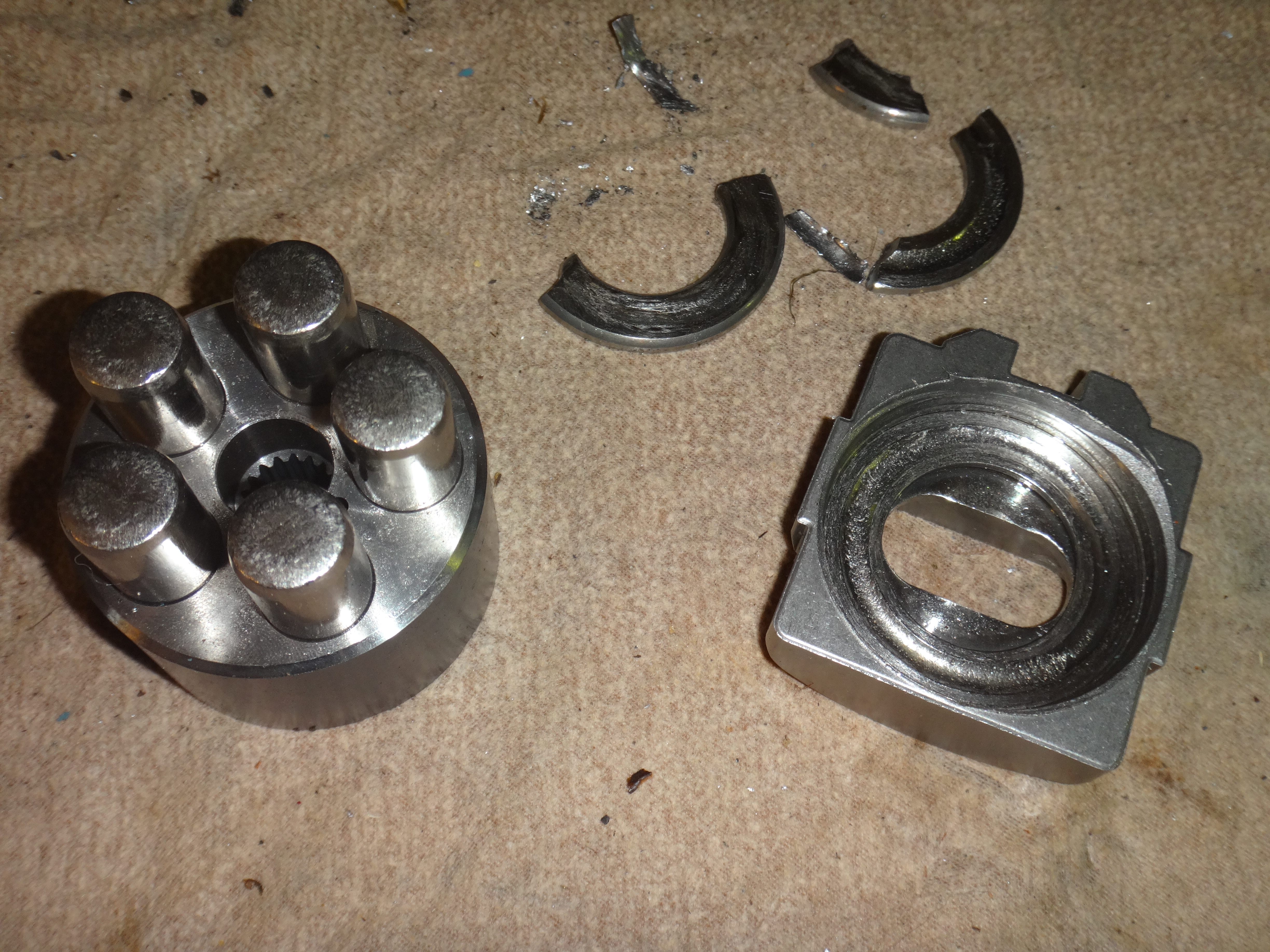

A year ago bought a GZD21 high rise that had done 720 hours. Had been going well and thought it was time for an hydraulic oil change - Kubota Oil, new filter.
After ten hours running, a loud metal on metal noise from LHS drive meant the mower went on the trailer into the workshop and now six months later have stripped it down to clutch/transmission component parts. Initially thought it was end float issues on the rear axle - some wear but the jammed transmission drive shaft lever necessitated further exploration.
On stripping clutch/transmission discovered totally destroyed - thrust ball bearing race. In NZ Kubota parts are horrendously expensive. I can get the HST Assembly (K2011-10122) for $3500 shipped from Japan or could possibly get away with replacing just the thrust ball bearing (K2011-01540)
Before I make a decision which way to go I'd appreciate forum members ideas on what may have caused the ball race to fail. I can't afford to have this happen again. My time doesn't cost me but the parts sure do.DSC04571.JPG

That rotating group is trash. I壇 say insufficient oil quality contributed to the failure. Either the wrong spec oil to begin with or the proper oil left in beyond the service life of the additive package. Or a plugged filter, low charge pressure or abnormally high oil temperature. I壇 think real hard about putting the complete unit in it.
