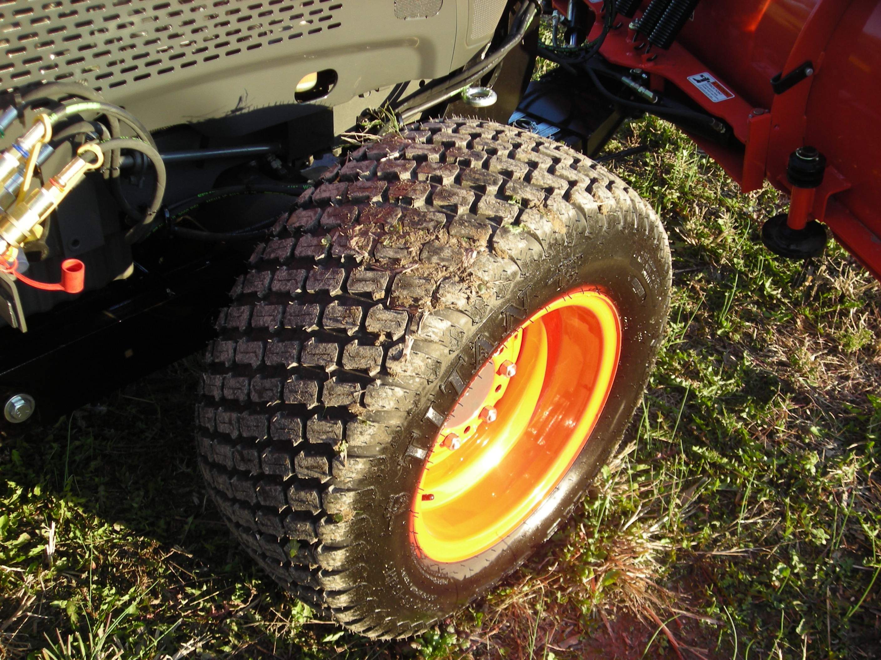

Just Bought a New Kubota B2920 with Turf tires, it got delivered with Kenda's Turfs in the front and Goodyear turfs on the rear both with different treed's too! Not that its a big deal, but I figured a new tractor would come with matching tires, the dealer says thats how kubota's B series are coming out with, any input will be appreciated!!!

What is really important in any 4wd is getting the ratio of the tire's rolling circumference correct to match the internal gear ratio in the transmission. That needs to be correct between the front and the back tires. If they need to go to different brands to accomplish that then so be it. You can check that by shifting between 2wd & 4wd.

Mixed brand tires on all tractors is very common. As was said, the manufacturers change brands depending on supply and pricing. The size is all that really matters.

I have Titan 'the Grizz' on mine, and they all match! End users, dealers, and reps need to complain up the chain until they solve this situation. I feel for you. If you wanted to do some more research, check the Titan catalog, they have lots of sizes in there. Philip.
   / Kubota's Turf tires #17

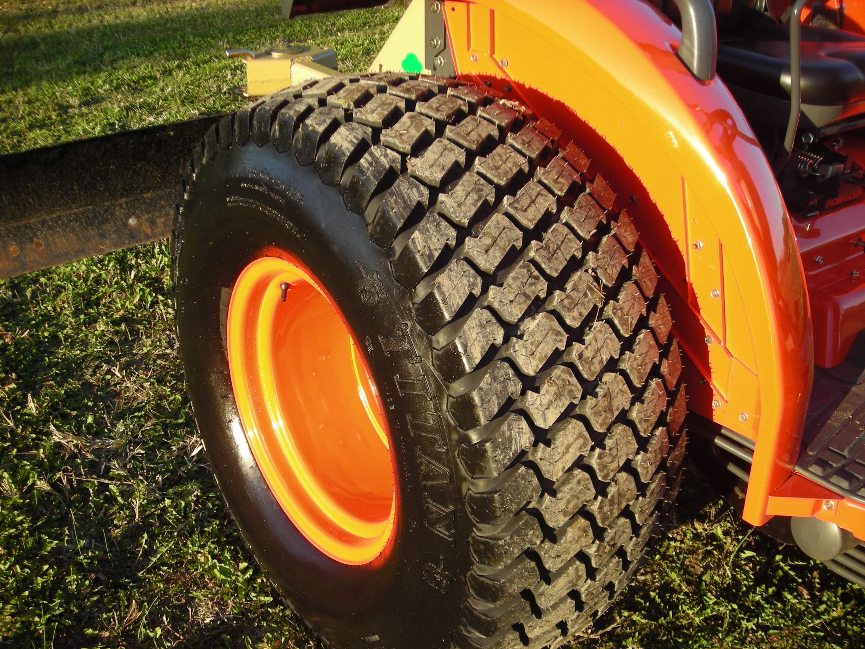

See if this helps any. Here are Titan's catalog pages for turfs. I have the Multi Trac tire, actually says 'the Grizz' on the side wall. My tires are marked in red. Good luck. Philip.

On-road vehicles like cars & trucks are a completely different situation than tractors as far as tires go. On-road needs matching tires to maximize overall handling at speed.
Turf Tractor tires can get away without having matching treads, and in some situations, can even improve traction with slightly differing tread patterns between the 2 very different sized tires front & rear, so I wouldn't lose too much sleep over it. Tire availability has been a big issue for years, and a tractor manufacturer has to do what they can to keep machines rolling off the assembly line. I'm sure they'd get a lot more complaints if buyers had to wait months just to get "matching" turf tire brands.
