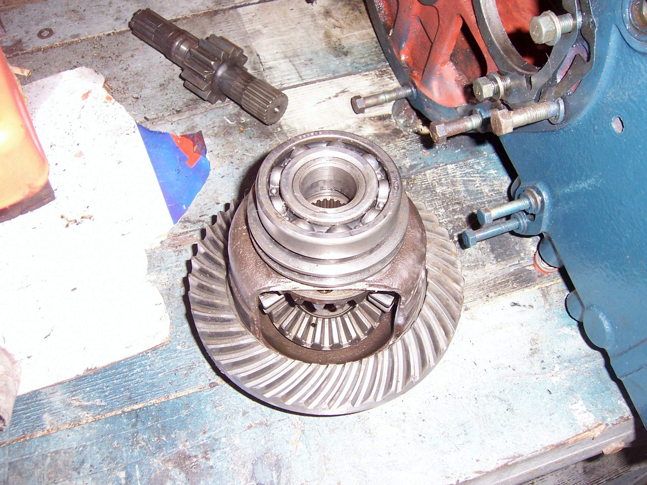

Well, I think I found the problem today. I popped open the rear end, and low and behold - the spiral bevel gear is all chewed to bits. I pulled off the right axle case, and the shaft differential gear bearing is totally shot. So at least it's new bearings for the shaft differential, and a new bevel gear. If you check out the link I have above, I've added pictures showing this. I reckon it will be monday before i can call around for parts.
To whomever suggested the spur or buldog gear (which I'm assuming is the same as the differential shaft gear) - you were the closest! I don't know if the bearing went first, and that caused the bevel to get chewed up, or the other way around.

Good grief, that looks nasty. Hows the pinion look ?
   / L-225 Clanging noise in transmission
#14
Willl, the pinion looks in really good shape. Really, the only thing that looks bad (so far - I haven't pulled them out yet) is the bevel and the differential shaft bearing.
   / L-225 Clanging noise in transmission #15
That much damage to the ring gear usually means damage on the pinion too. Look close for cracks and worn profile. It's a lot of work to do twice.

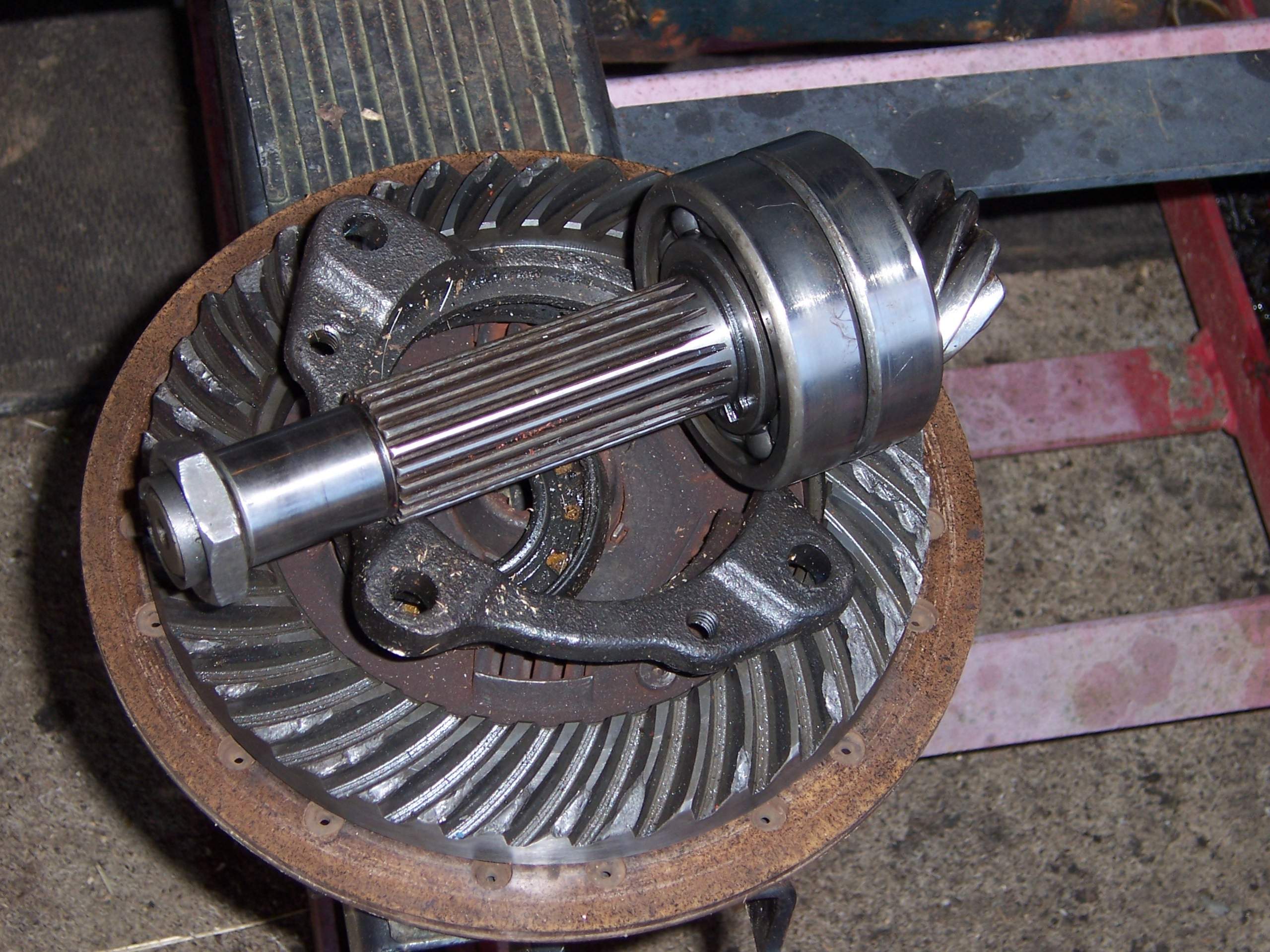

yeah. I went in and ordered parts today - new bearing and oil seal for the differential shaft gear; new differential bearing race. What I cannot get is a new ring / pinion, so I'm going to have to hit up the salvage yards. Anybody have a recommendation? I hear there's a place out in kentucky or somewhere that has a lot of L225's. I kinda hate to use salvage parts after all this work to get here; but I'm open to options.
I've updated the link (http://www.facebook.com/album.php?aid=60021&l=6180b&id=577472985) with a few more photos. I haven't pulled out the pinion gear yet, I'll wait to see how things go trying to find a matched set pinion / ring; I'm hopefull that I'm done dissasembling, and all there is now is cleaning, painting and reassembling.

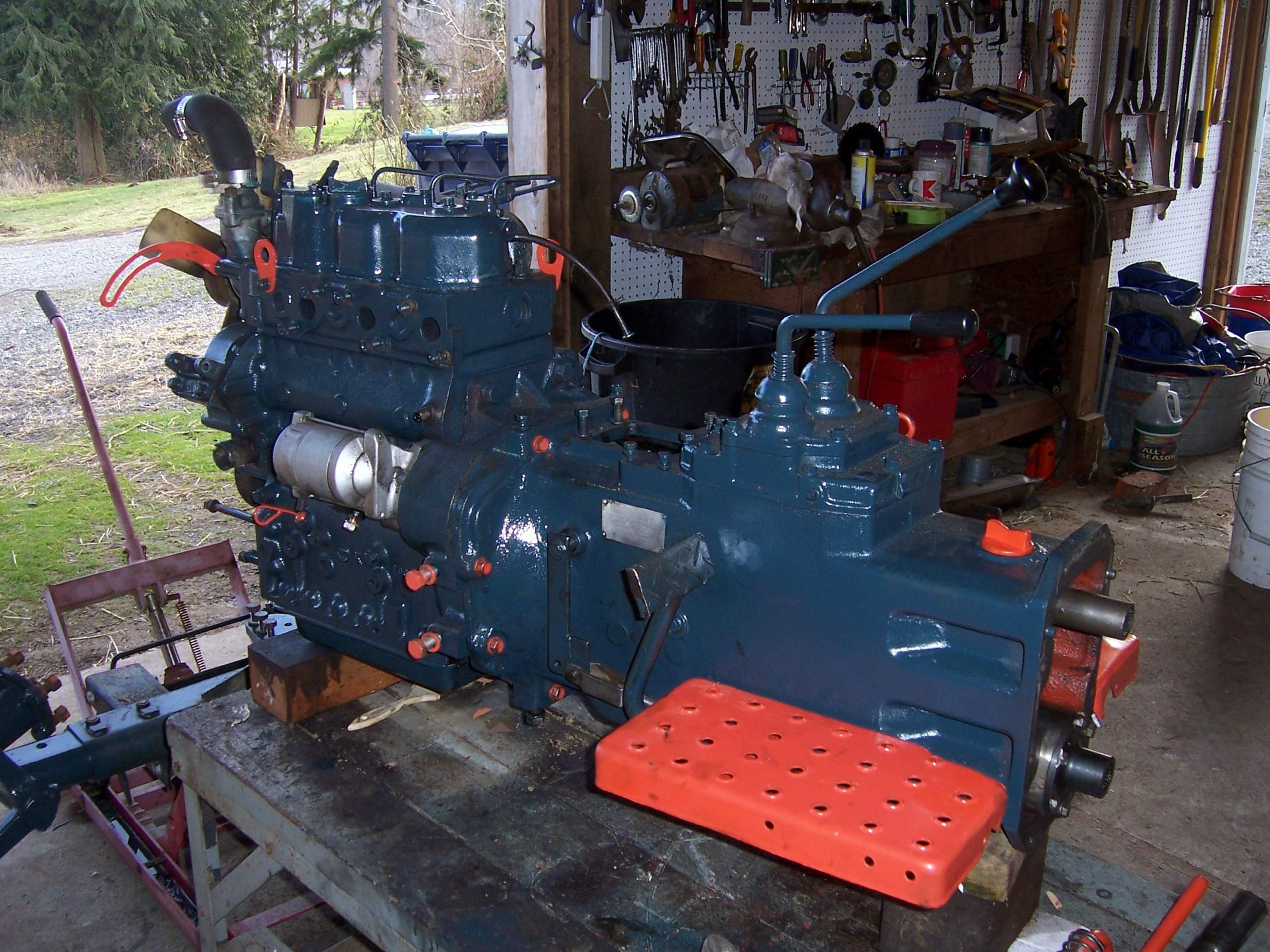

Thanks for the thoughts! Coupla things - cancer treatment is going well. More of an annoyance than anything else, but I'm bald as a cue ball.
Got the new ring and pinion, and have assembled them. I've put the engine and tranny back together, had to re-jigger the clutch a bit - the new clutch is more "inset" than the original, resulting in a lot more release bearing travel, which messes up the linkage.
I'm still waiting on some bearings, seals and o-rings from the dealership. I'll probably pick those up this tuesday, and get them on on wednesday. My HOPE is to have it all put together by this weekend - it depends on how much screwing around I have to do to ensure the ring & pinion are meshing properly. New pictures are up on my facebook site at the link below.

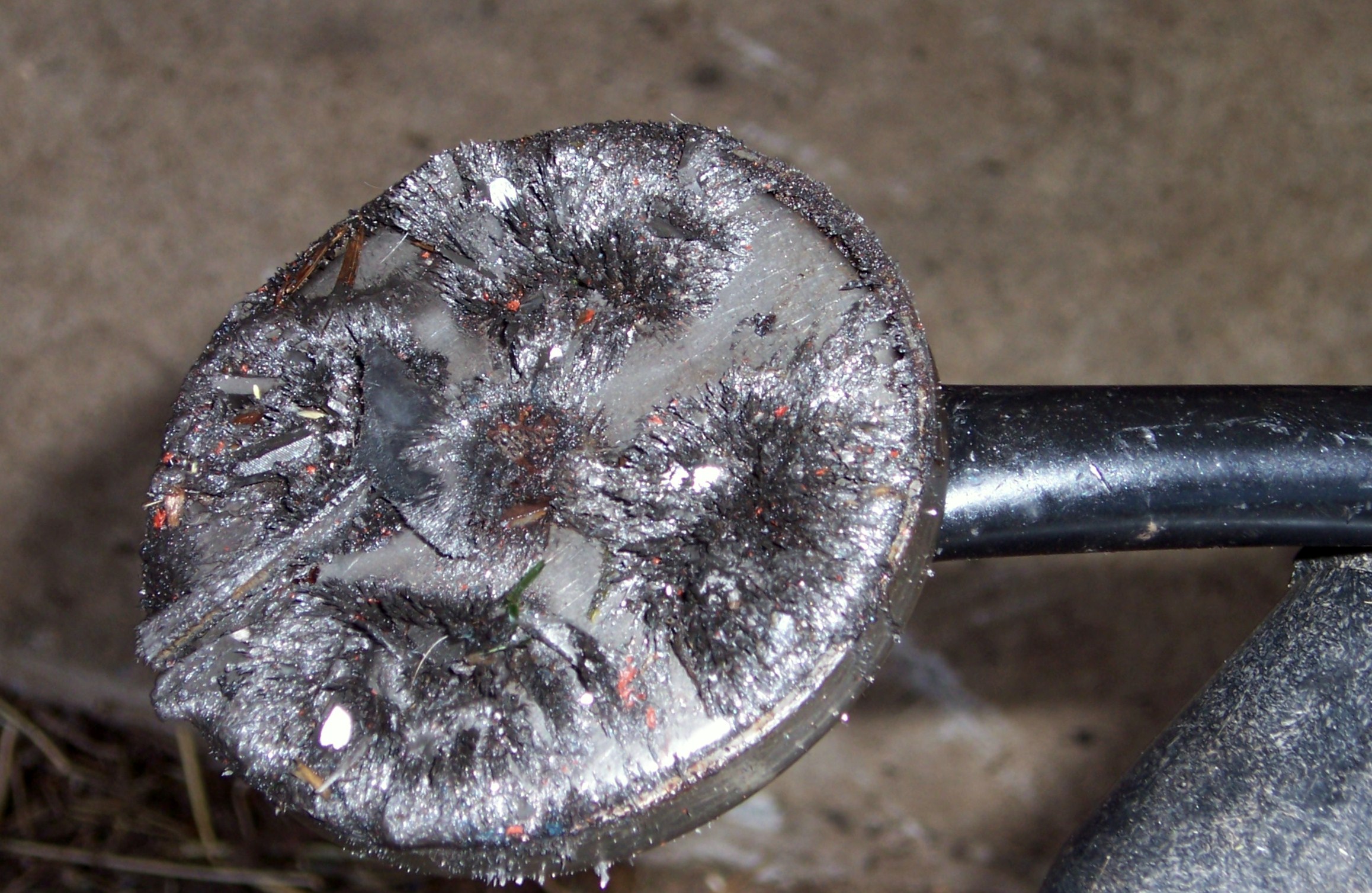

I'm taking the opportunity to make this look purdy, doing a lot of cleaining and painting. I'll be doing a lot more. I've attached some pics - also one of all the broken bits and metal filings I pulled out of the differential case.

I'm thankful to hear your health is improving. I am highly interested in your "rebuild". The engine and transmission look good! It's amazing what cleaning and painting will do.
