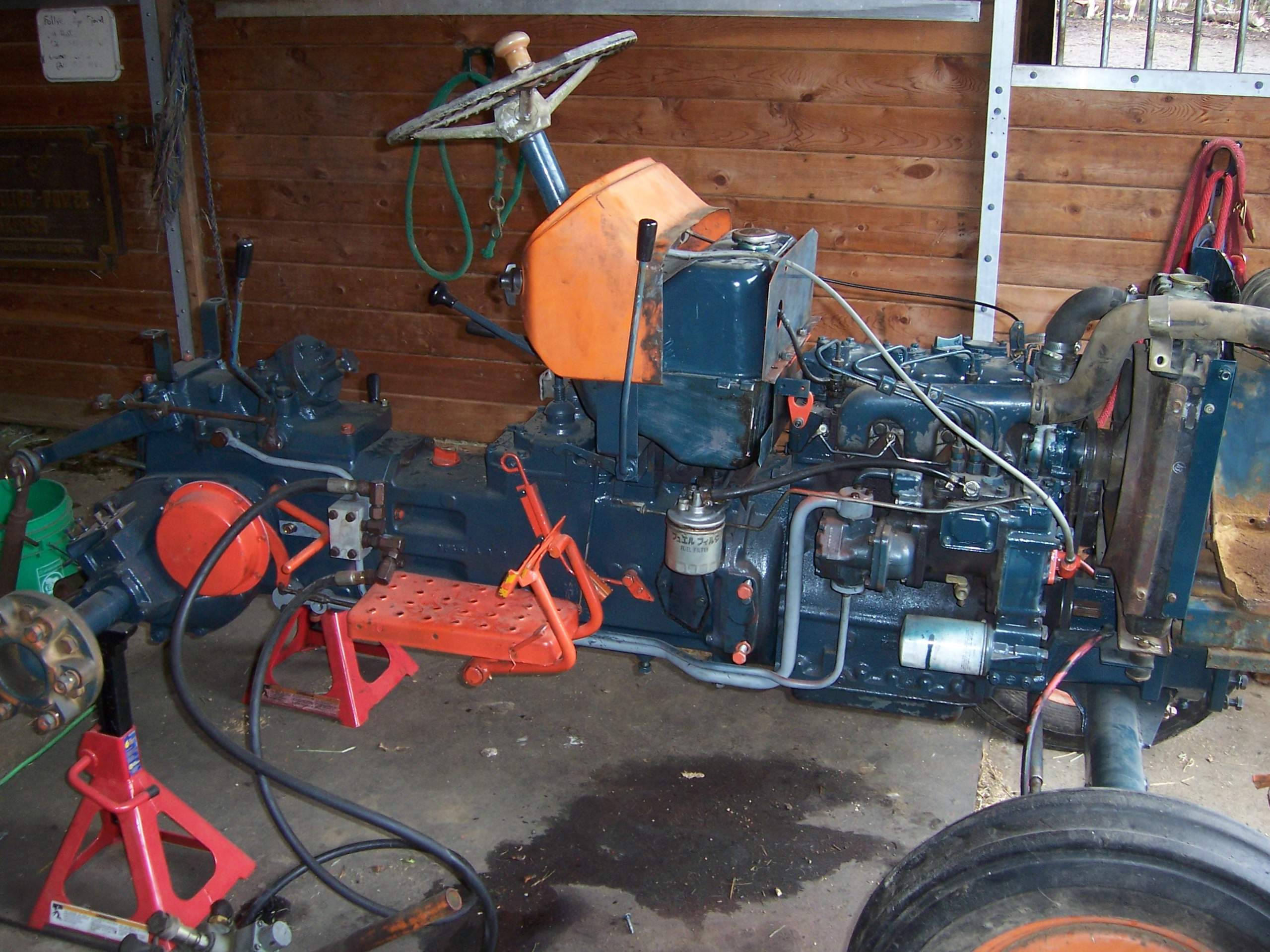

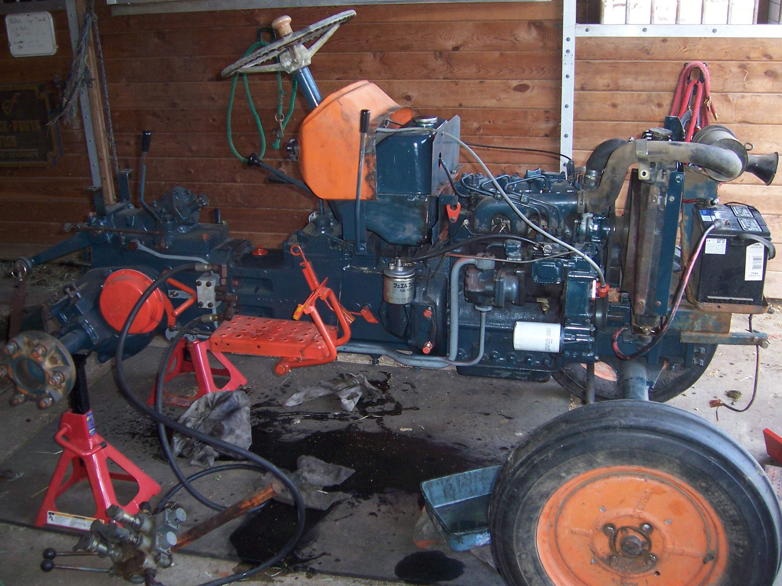

Fun stuff all around! As for me, I finally managed to spend a few hours today putting things together. It's starting to look like a tractor again! One thing I noticed that I hadn't before, was the stamp on the right side of the differential casing - it says L225-13157, with 13157 being the sn of my tractor, matching the sn on the tag on the front left of the transmission. So you can tell if your differential belongs to your tranny!
I've put on the left axle. I still need to get in and pick up the oil seal for the right axle, and I'll have that on. Getting closer...

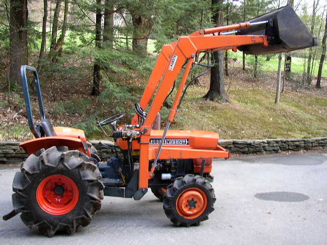

Wow, Rbargeron, I have excatly the same FEL and rollbar on mine! Your tires are in better shape, though.

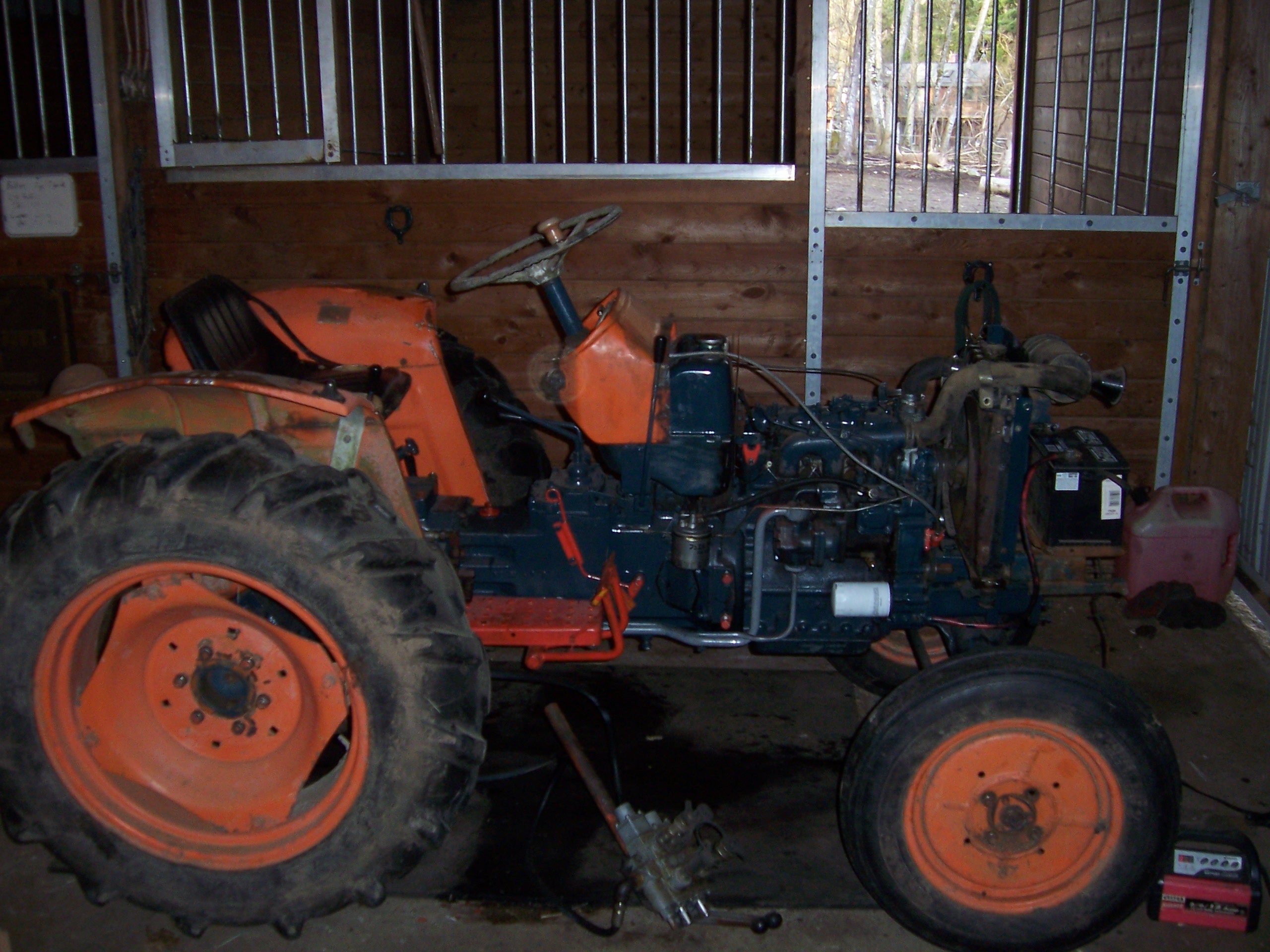

Been a while - but you guys appear to be having a nice time! I too need a new front hub, one of the corners is broken off, so the wheel has 3 bolts.
Great news - I've got it all back together, finished wiring it up last night - turned the key - and it started right up! I couldn't believe it. I've had it apart since Jan, and while I didn't do anything significant to the engine, nevertheless it's always a nucklebiter.
It turns out I mashed the o-ring on the hydraulic screen, so I didn't put it in gear or try to move it. I just finished tonight putting in the new O-ring, and over the next few days I'll get it done up.
There is some electrical weirdness. I know the alternator is shot, so I'm going to replace it with a 1-wire alternator, and rip out the unecessary Wiring.
Here are some pics -

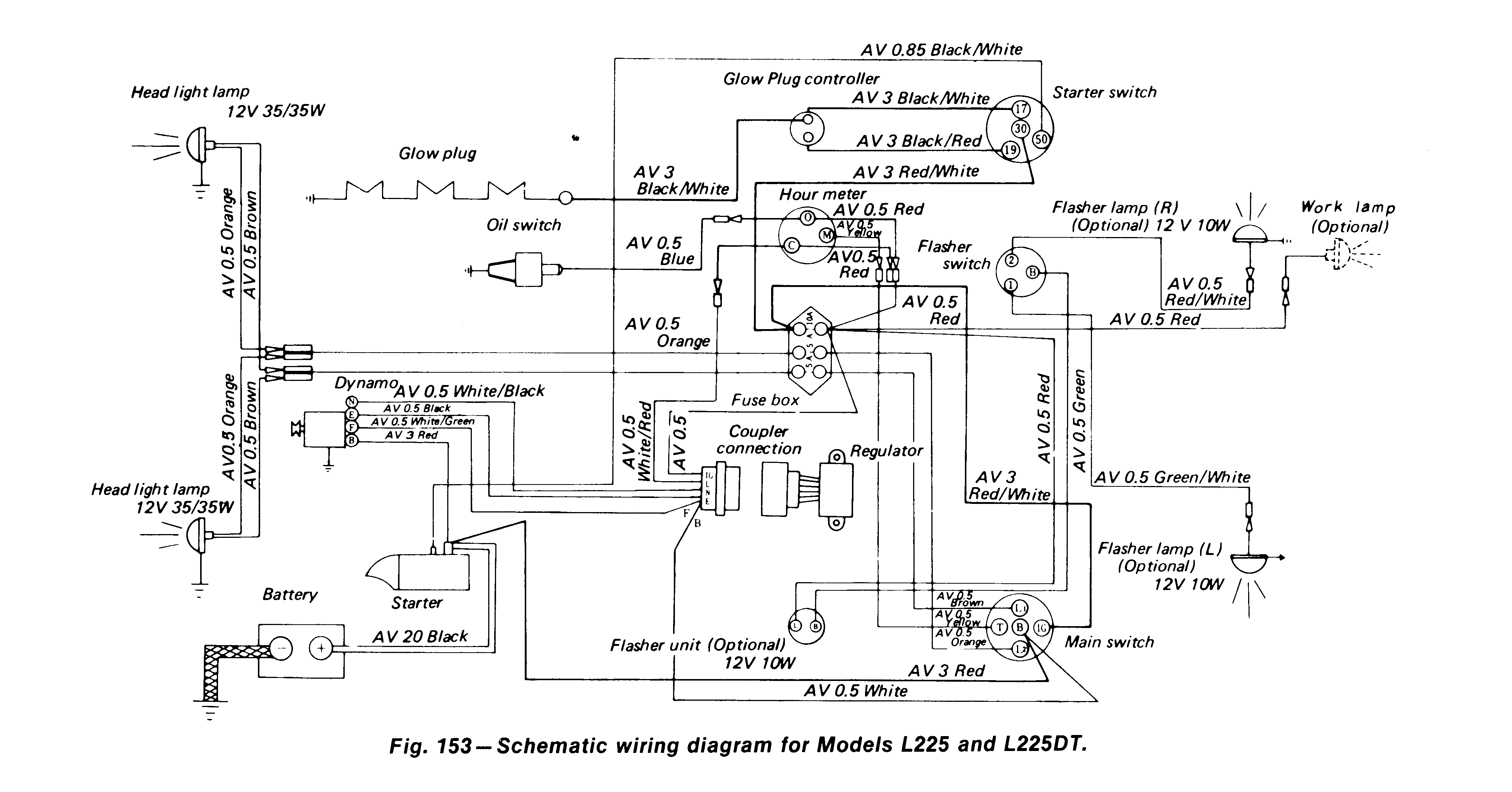

Oh, one more thing - in case anyone should need it, here's the wiring diagram for the l-225.
