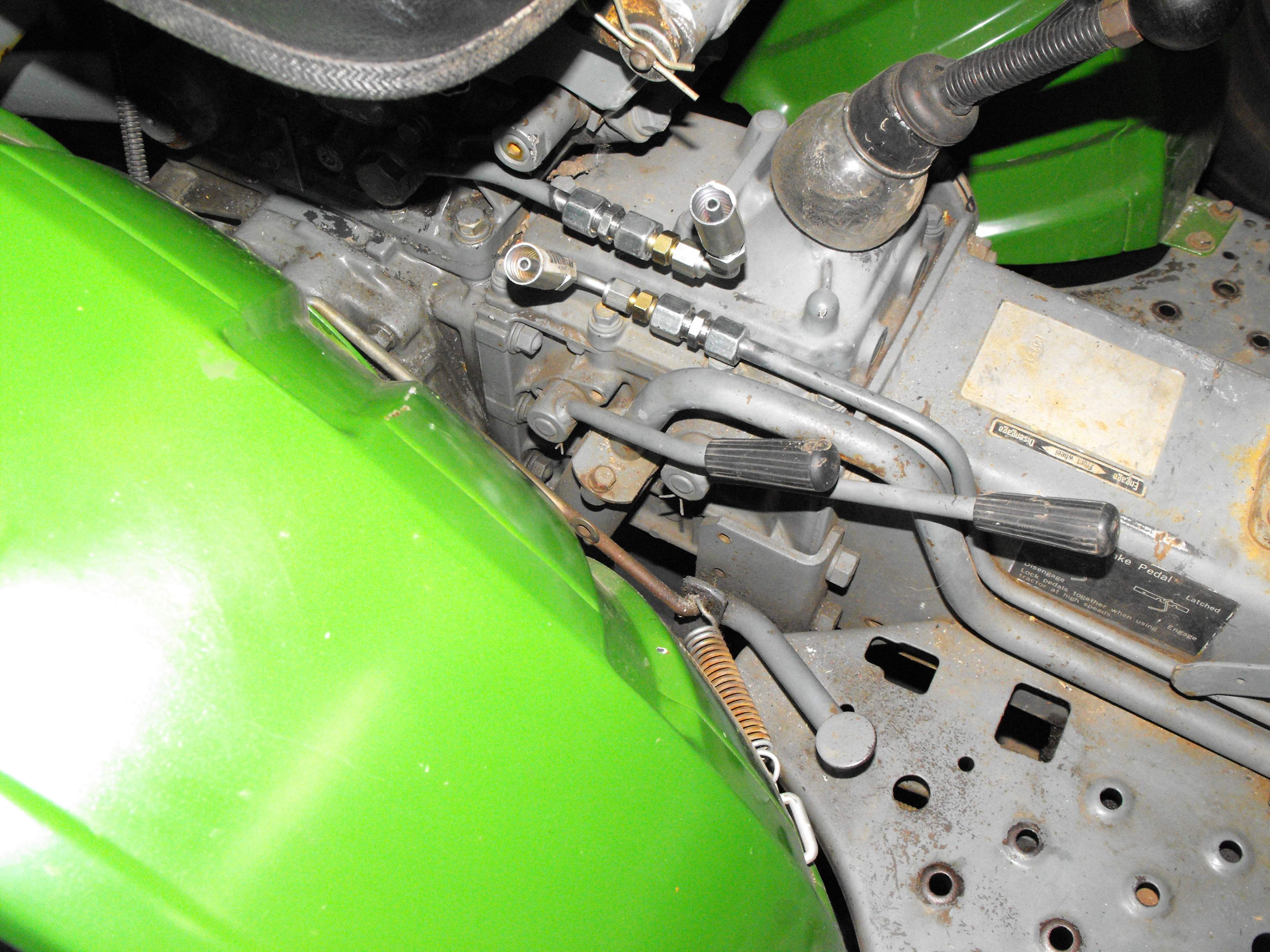

kuboman,
I would suggest mounting one of those gages before the FEL, to monitor and trouble shoot the hyd system.
You could cut your pressure line and do something like this for a pressure gage extension. Just use a tee at the union and run a line up to where you can see the gage while operating the tractor.
