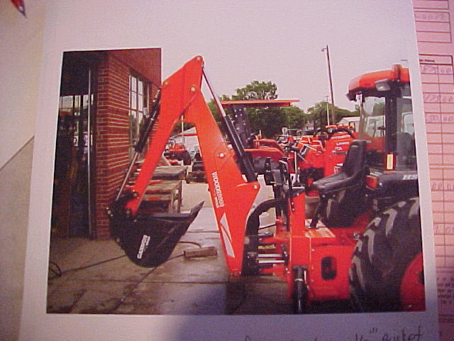

If it works I have a picture that another dealer mailed me of a woods 9000 on a 5030 cab model.
   / L 5030 #30
DDT, uh rats! Your dealer is too far from me, and my dealer says it won't work. Obviously it will work. I'd just like to see how well it works etc. I assume that one would have to open the rear glass of the cab first in order to run the throttle and loader. I just wonder how practical that would be. In other words, I wonder if it works great, or it just works. /forums/images/graemlins/confused.gif Thanks for posting the pic!
