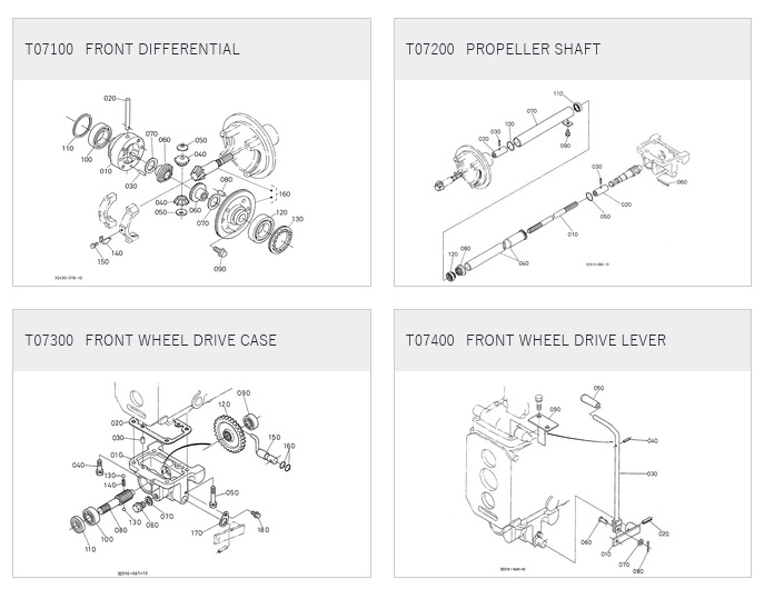

I bought a Kubota L2350 but I can't get it to go into 4wheel , the lever works goes up and down but I don't think it's in 4wheel. Any help appreciated

Take a look at this thread from last week. The L2350 is a similar setup with similar issues - but easier to work on with the front driveshaft tube running below the clutch housing.
screen shot from Kubota Illustrated Parts List :
L2350 front wheel drive.jpgTTH

Check the linkage for loose or missing bolts.
   / L2350 won't go into 4 wheel drive #4
How are you determining that it's not in 4wd?
it can be hard to tell with a tractor; it's not like a truck.
before you "fix" anything, I'd make sure that it's definitely not working
The second post in this thread describes a way to check if the 4wd is actually engaged.....
Did like everyone said , front coup;er was worn, back coupler was broken. Hardest part of the job was driving out the back pin that keeps the shaft cover in place
