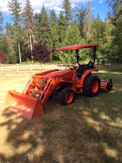

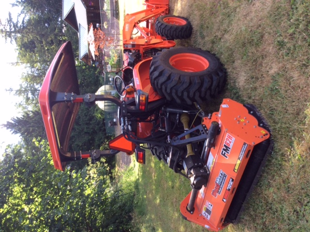

Having the 2501HST now for 2 years, my one small issue is; wishing it had more PTO power for brush hogging; with my 5 ft Land Pride this tractor is right at the limit when mowing pasture grass and I did not want to buy a smaller 4ft mower but might need to or, repair the old JD. Using the flail mower is much easier where I mow the well maintained 3 acres about the house, it's the taller field grass I have trouble with needed to go slower, especially on the slopes which are not much of a grade really. Mostly though, I like this tractor but getting used to the high end whine of the HST, and the fact they need to be run at high rpm, was something I hadn't thought about enough before buying. Were I to do it over, the L3300 or L3901 would be a better choice for my needs and not much more in price. I picked the 2501 because of it not having re-gen and thinking 25HP would suffice where before I needed at least a 40-50 HP tractor. The 2501 does do all I need though except serious mowing, and at a lot less fuel than my old tractors use. We have a half mile long driveway and the 2501 with 5ft Land Pride-land Plane does a great job! Also works great with the forks and QA is awesome too! Comfort and operator space is also great, another plus for us big guys.

You get 7hp engine increase and 6.3 pto hp increase with the 3301. Having mowed several fields with both 2501 and 3301 the difference is worth the extra dollars if doing lots of mowing. My mowing is much less than before and using a flail mower seems to require less effort than my 5 ft brush hog does. Also I don't chip anything like you will be doing. it's my 2 sons who complain because the 2501 won't mow as fast as our old tractors would but there always in a hurry where I am not, any longer. Growing up on 2 cylinder tractors, this 2501 is a Cadillac to me besides, I enjoy my time in the field so not in any hurry. Happy you seem to have made the decision and what works best for your application.

My 2501 has 3 rear remotes that were added after purchase costing more than had I got them when new. I had worked so many years without them I thought to save the money but now think them worth every penny! Top link is very useful, more for me than tilt, but got both because I am tired of making manual adjustments and was worth the price to me. The third valve is for my flail mower that goes back and forth on its own cylinder for mowing along fences as such. Again, not totally necessary but I do use it at times. Were I to get a grapple, it can run off one of these remotes using long hoses and one of three control handle mounted next to the seat. Kubota charges a bunch for remotes so think through you needs totally including any implements you will need that will benefit from remotes. There are cheaper after market remotes but I wanted all Kubota stuff so stayed with them. - Both my top and tilt cylinders will bleed down during use, slowly yes, but enough that I added lock out valves in the line fittings to stop this, they work well too thanks to guys here on TBN suggesting them.. - As far as remotes and implements, I run a box blade at times, a Land Plane lots of the time, both benefit from remotes making work easier. 3rd remote is for the flail during mowing. Implement selection and use will have a big impact on your ability to fully use your new tractor so suggest you think through them very carefully, how they will be used and what for? are you selecting the right one and is it strong enough? how easily can you work with them? including mounting and dismounting? do you need to make adjustments during use? are you buying the right size implement for your tractor? etc. Also, please consider having a fast hitch for the 3-point, best $100. I have spent on my tractor. Get one before you cut any drive lines and size accordingly. There is nothing I hate more than getting on and off a tractor making adjustments or trying to align the tractor and implement! the fast hitch makes it a 2 minute job. I also have the fiberglass top that covers my tractor, great on hot days and rainy days both.
Ricn

Nice Looking Tractor Ricn - that's a nice setup and looks like a pretty spot you live in! Also agree on the 3PT quick hitch - I don't have it, but I only change it out once a year so not a big deal.
