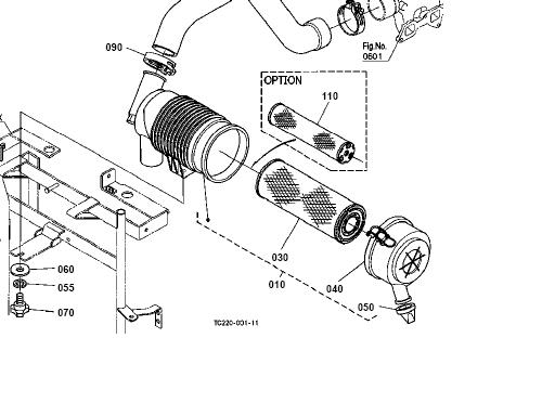

My L2800 tractor does not have an inner air filter, according to the parts book it is an option. Should I buy one of these filters and add it. Will it change anything on the intake side by adding more restricton.
item 110 on the picture.

I think I'll add one to my L3400 at the 50 hour service. I would think that the extra filtration is a very good idea. I've heard that dust in the engine is a major cause of wear. In the meantime, I make sure I clean my filter pretty often. I use an air compressor to blow it out (inside out). I use my 3400 to drag a horse arena, and I'm pretty much in a cloud of dust the whole time. Air filtration is very important.

I sent him a PM in June of 2007 and he said, "Yes I did buy it and there is no noticeable difference in tractor performance." I installed one shortly after that and have not noticed a difference either.
I tried blowing out the inner filter last time I blew out the outer filter and did not see any dust come out of the inner filter. The outer filter was extremely dusty, which seems to say the outer one works well.
/ L2800 Air filter option #7
The inner is just in case the outer fails. I don't they they even recommend replacing the inner at regular intervals...because it should always be clean. An outter only is all you need if you service it properly. If you add the inner I think you need to replace the air filter canister, you will not see any difference in engine performance.

The canister does not need to be replaced, just adding the inner is all that is needed.
/ L2800 Air filter option #9
I guess they have a couple different designs, The parts guy gave me one by mistake once, my normal filter is open at both ends, The dual filter is closed at one end. On mine there is no post for a screw to hold the dual set up.
/ L2800 Air filter option #10
No need to replace the canister on the 2800/3400. The filters are only open on one end and no posts or screws are necessary to hold them in.
