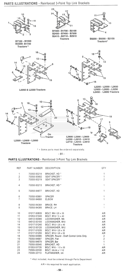

Around February 02 there were some very helpful TBN posts on this subject. Attached is a copy of a Kubota parts manual page posted at the time. It's a shame your dealer did not recommend this upgrade. (I think my total cost was less than $100) My Kubota dealer had never seen this page before but the parts arrived within a week when I ordered them.

I have to assume that he was either unaware that an upgrade was available or felt it wasn't needed or both. However, if Kubota engineered an upgrade, does that imply that there was a known weakness in that area of the machine? /forums/images/graemlins/confused.gif

There are several reasons to add the HD top-link bracket. Beyond adding a BH using an extra heavy attachment. Also using attachments in reverse can put added strain on top-links.
My dealer suggested the HD top-link because I had purchased a Heavy Duty Back Blade.
Here is a thread showing how the top link is installed on a B series tractor. Click Here
Here is the original post on HD top link part numbers. Click Here
