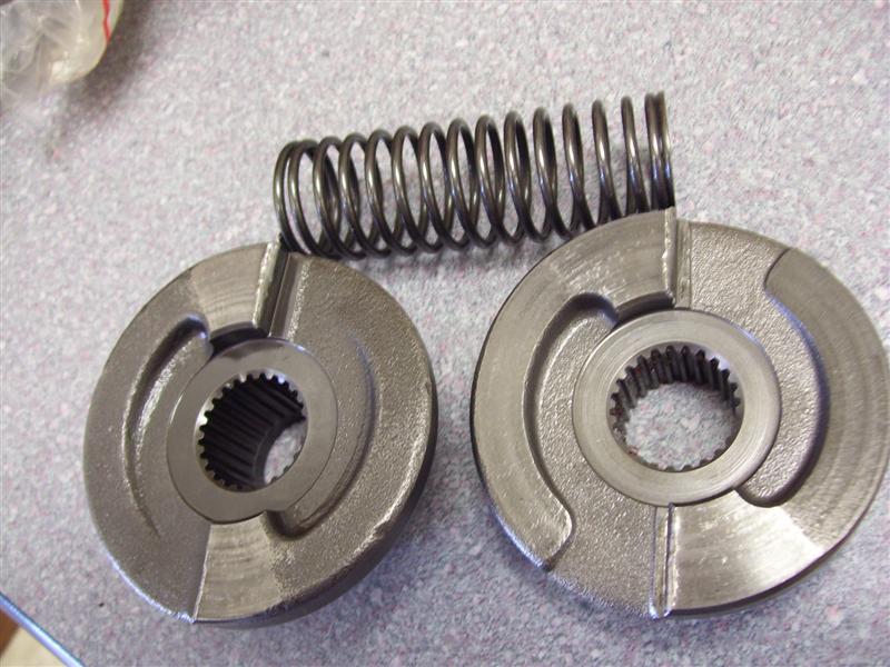

My dealer is picking my L3400 HST tomorrow to install the upgraded pto parts. No qustions asked. I just showed my salesman a copy of the "original" service bulletin posted here and he got the process moving.
Hopefully all goes well. Always makes me nervous having something worked on at a dealer as I used to work in a Ford dealership. I hate being the customer. Brian

For some reason Kubota decided to do the cam exchange on my tractor. I got a call today from the Northern Division and was informed to get ahold of my dealer and they will take care of it.
I hope these new cams take care of my problems and hold up better than the old style. Time will tell. Thank you Mr. Miller at the Northern Division for helping me get this done.

Hello All. I received my tractor yesterday after PTO cam kit installed. All I can say is WOW. What a difference. I put my chipper on and engaged the pto and went to 540 pto rpm. All quiet and smooth. I then on purpose lowered the rpm pretty quickly where in the past the pto would have been making a racket and not a sound. I mean not even a click, clack or clunk!
I will still operate it properly but I really wanted to know how it would react. This is the way it should be. I do not have a brush hog or tiller but I would highly recommend all of you to contact your dealer and have this update performed while under warranty.
I did not get to talk to the mechanic about the kit itself. I wanted to know exactly what the kit included.
My paperwork shows my tractor L3400 HSTF. Serial number 56283. Install update PTO cam kit per PSB-2005-052-A. Part number TC220-9990. Within warranty period. Split tractor and installed updated PTO shifter kit. Reassembled, filled trans and tested operation.
The dealer included free transportation for this repair. I am out of the two year basic warranty and now under powertrain warranty. Earlier there was some question about whether this would be covered under powertrain warranty. It is covered as the PTO is part of the powertrain.
Again, I thank Hamer for starting this thread and the person who posted this PSB number. If not for these people I would still be grumbling about my PTO. My tractor has been to the dealer 3 times only and all were for items I learned about on TBN. First the 3pt. valve, then the fluid level increase and now the PTO update. Hopefully this is it for repairs. Now I have a two year owners survey to fill out and I will rate my dealer highly but Kubota itself could improve.
Edit Here. The tractor was picked up Tuesday afternoon and retuned Friday morning.
If anyone has any questions I will answer as best I can. Brian

Hey Brian, you didn't happen to get a look at your old cams did you. I was wondering if they were like these with one having a slight shoulder at the end and the other not having any. I really think that this was what caused my PTO to fail the second time. There is no way that these cams could have locked up flush with each other, thus causing the actual locking lugs to be only about half seated together.
Good luck with your new cams. I hope they hold up. From the pictures posted here in this thread, they look to be a better designed locking system. They look like they should be able to be flush when locked together. Thanks for posting the feedback on your new cams. It sounds good. I called my dealer yesterday and they said the new cams are ordered and it will be sometime next week before they can install them. I will let you know how things go.

I did not get to see the old cams or even talk to the mechanic who worked on it. Sorry I could not be more help but I think you may be right about the new cams locking together better. They may have changed more than just removing the ramps. Brian
