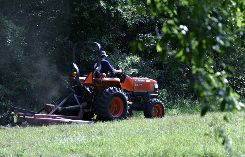

I went ahead and got the L2800 hydro, really nice machine.
Hydro seems to be a heavier machine and the shudder is not that bad. Still somewhat annoying though.

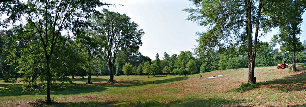

Its not really a power or weight thing. My 5' cutter on the hydro chows down on anything I feed it. Without the implement, the lift goes up and down smooth. Low RPM, the lift, including implement goes up and down smooth. Crank up the RPM, raising a box blade or getting that cutter at the right height has a tendency to jolt the entire machine. I didn't notice that on a JD 790 I tried.
I've been to a couple of different dealers and pretty much they say thats just how the L series pumps are. They also say its a highly reliable machine and shouldn't expect any problems out of it for many years to come.
Picture shows how the yard dwarfs the tractor!
