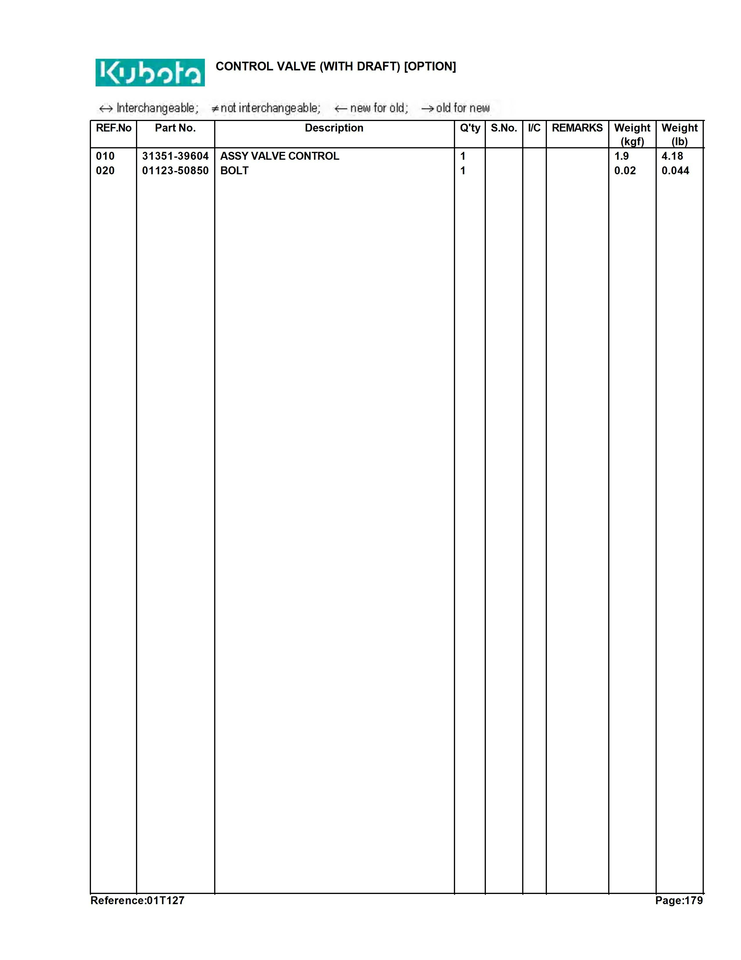

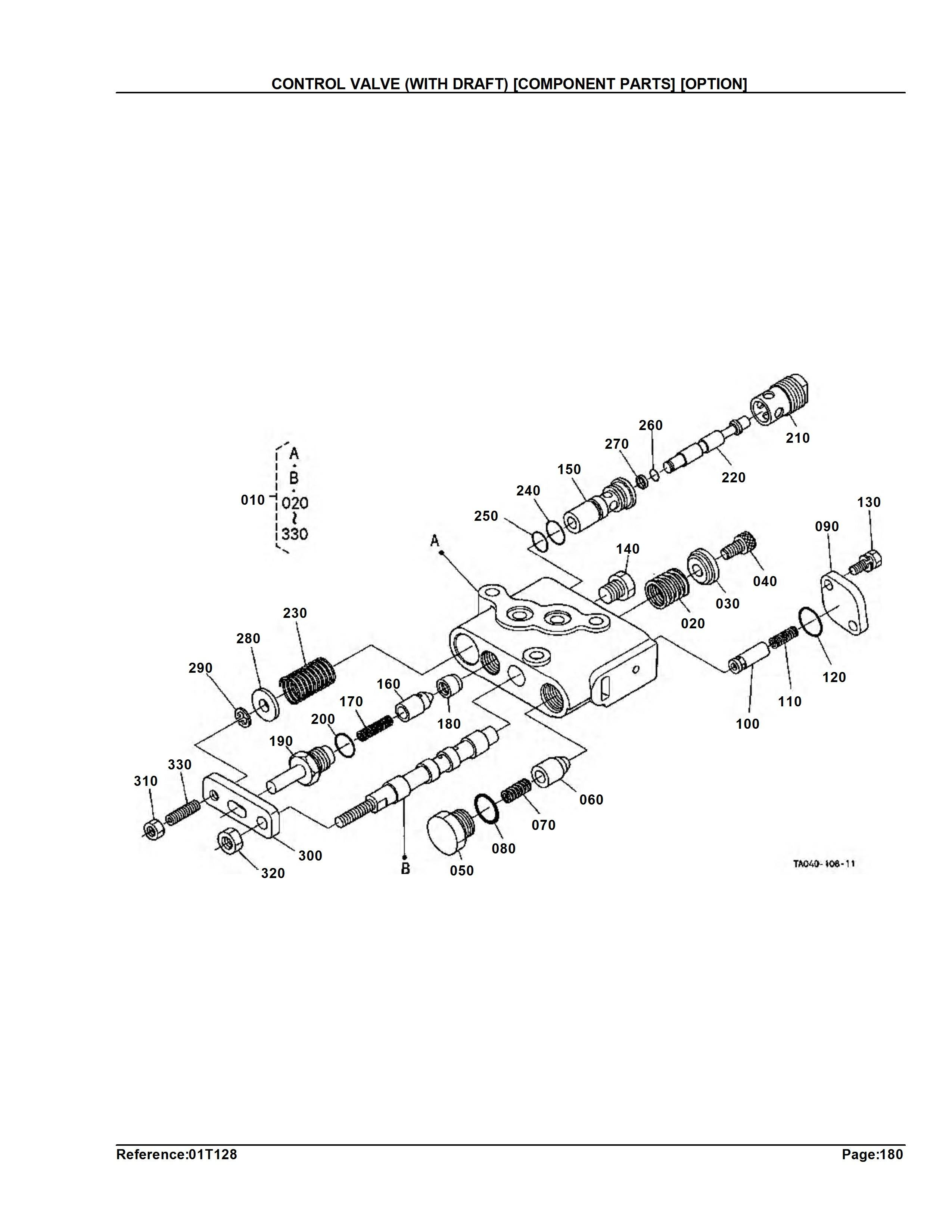

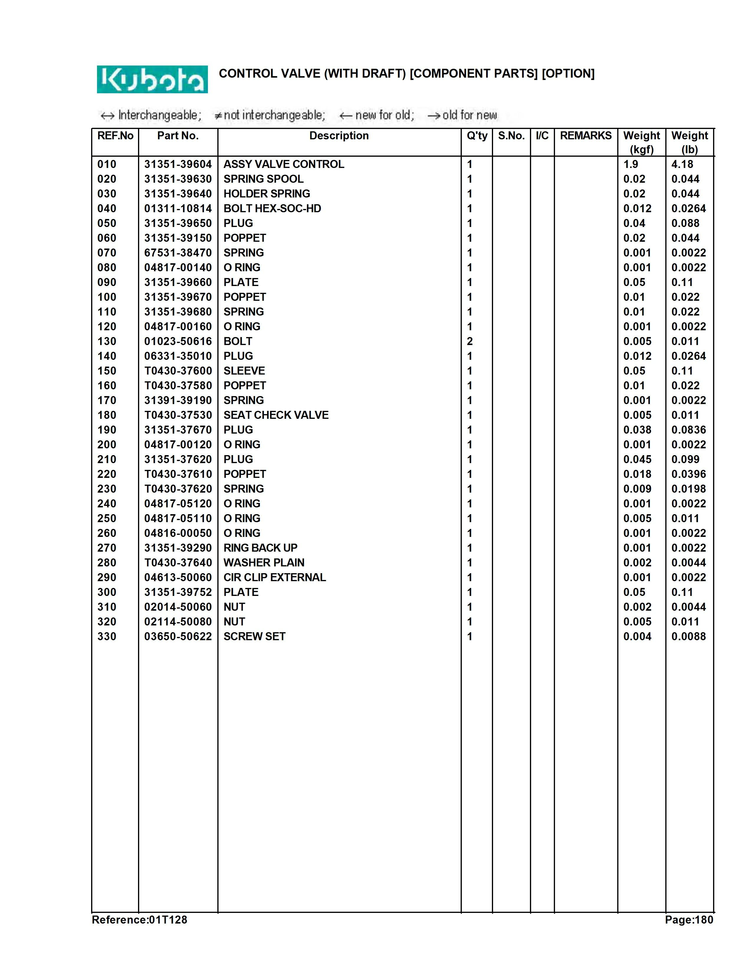

These are from the L2800 manual. Hope it helps.
Terry
