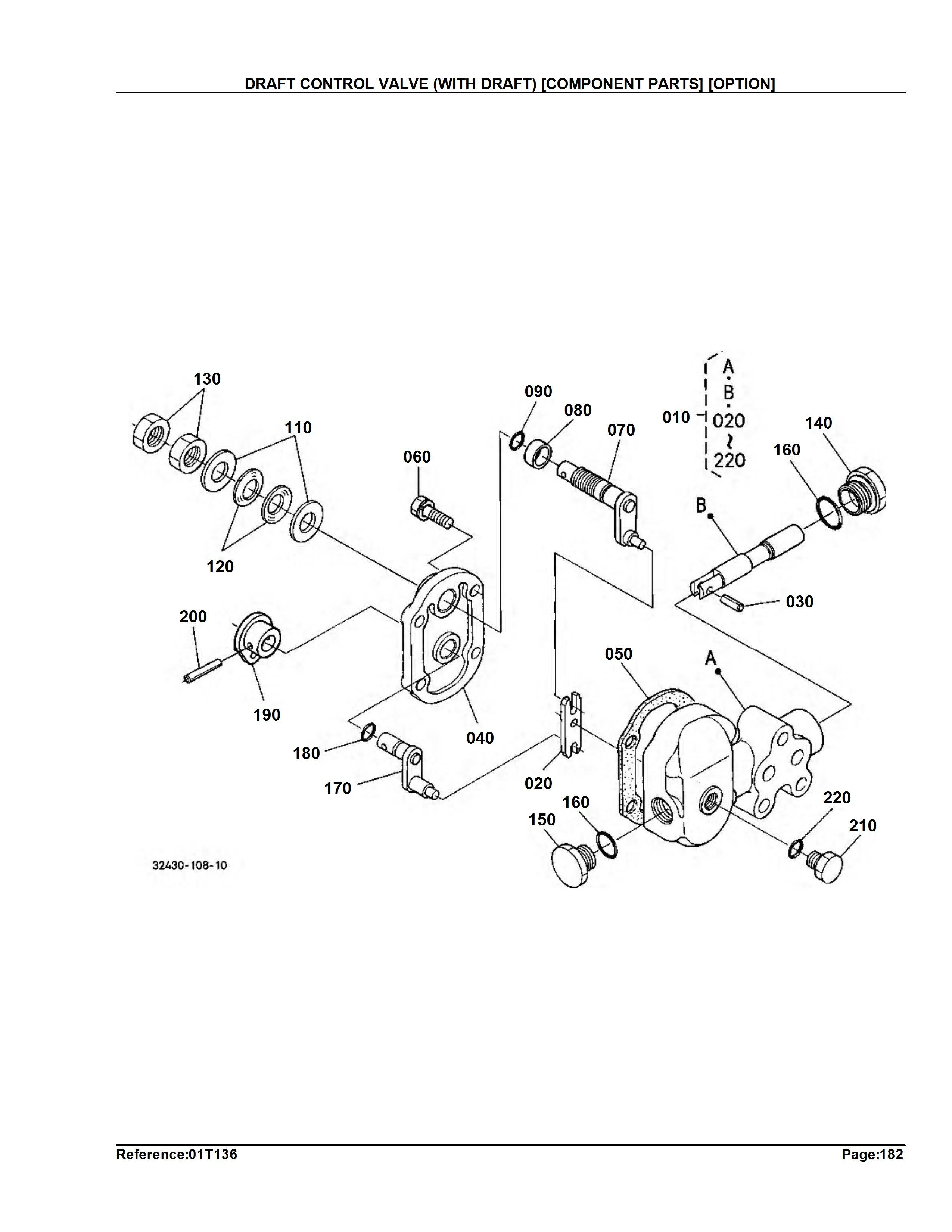

emmy71 beat me to it but Draft control is an option and it hasn't had the problem valves that the non draft tractors have had when factory installed. My somewhat older parts book indicates valve 31351-39604 from the start, when draft is included.
I don't know if this has changed since the latest position control valve "upgrade" but I'd like to. I can't see the new valve with a draft system.
teg's videos can tell/show us a lot next to Toy Camry's if he sets up a comparable scenario and he has valve 31351-39604.
teg, do you have any records confirming which valve you were upgraded to? I'm guessing at the time it would have been valve 31351-39604.
Toy Camry posted earlier that he has valve YR90800102 installed.
Any of you guys out there who have been upgraded and are happy... let us know what valve was used if you can. Thanks.
