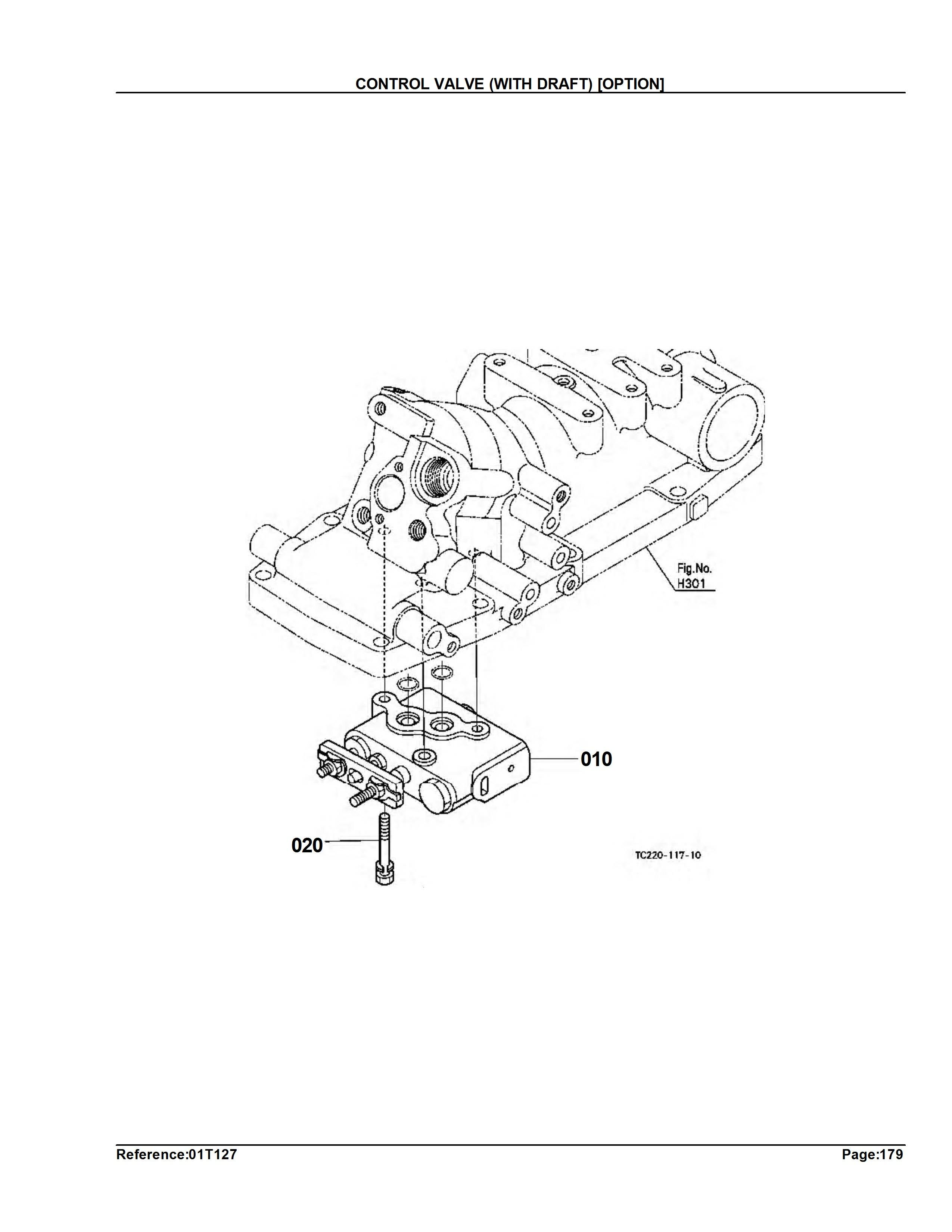

One of the reasons I haven't aggressively pursued getting my valve replaced is descriptions like ccsial's. If I were to do the ruler test without an implement I'm pretty sure that I'd get 1/4 inch increments but throw an implement on and my tractor gets thrown around like the ones shown in the bad 3 pt videos that have been posted.
I know my valve is the original faulty old style but I'm not sure if pursuing replacement is worth the trouble. It really doesn't do 1" increments at the lift arms but the implement will jerk up and down in a range of at least one inch depending on it's projection.

Ditto with ccsial. My replaced valve is far from being silky smooth. It is WAAAY better than the original one though. The original one moved in 1" increments and the new one moves in 1/4".
Still somewhat jerky and noticeable when working the box blade perhaps. That said, no more jerky than what I found - say a CK30 - similar class of tractor - to be. My recollection is from just demoing a CK30 on a dealers lot with a finish mower attached to it.

Just an update. My local dealer dropped off the tractor this morning and I must admit that I am confident he has tried his best to solve my problem. He just replaced my scratched valve with p/n YR90800102 (assembly control valve) and I have observed that my 3 point arms lift in closer to 1/4" increments than 1" increments so can I safely assume that the new "updated" valve is working as it should ?
When the tractor was being dropped off we did an informal test using a post hole auger mounted on the 3 point hitch and attached a 5 gallon pail of water to the auger gearbox. The Kubota sales representative raised and lowered the bucket of water as I recorded the video using his Blackberry. We performed the test using a John Deere 790 and then switched the auger to my L3400 and repeated the test.
The 1/4" is probably as good as your going to get. That is the new valve that I recieved.

How many valves are out there?
My tractor is supposed to have valve #31391-39002
That valve was supposedly upgraded after SN# 61730 to valve #31351-39604 which is the same valve that the L3010 was upgraded to after it hit SN# 74779, according to my reference.
Now, new L3400 owners are having inching problems and Toy Camry's valve was replaced with YR90800102 which is the one ccsial has?... with the 1/4 inch jerk?
Are there really four different valves out there? Does anyone have a better than 1/4 smoothness?
