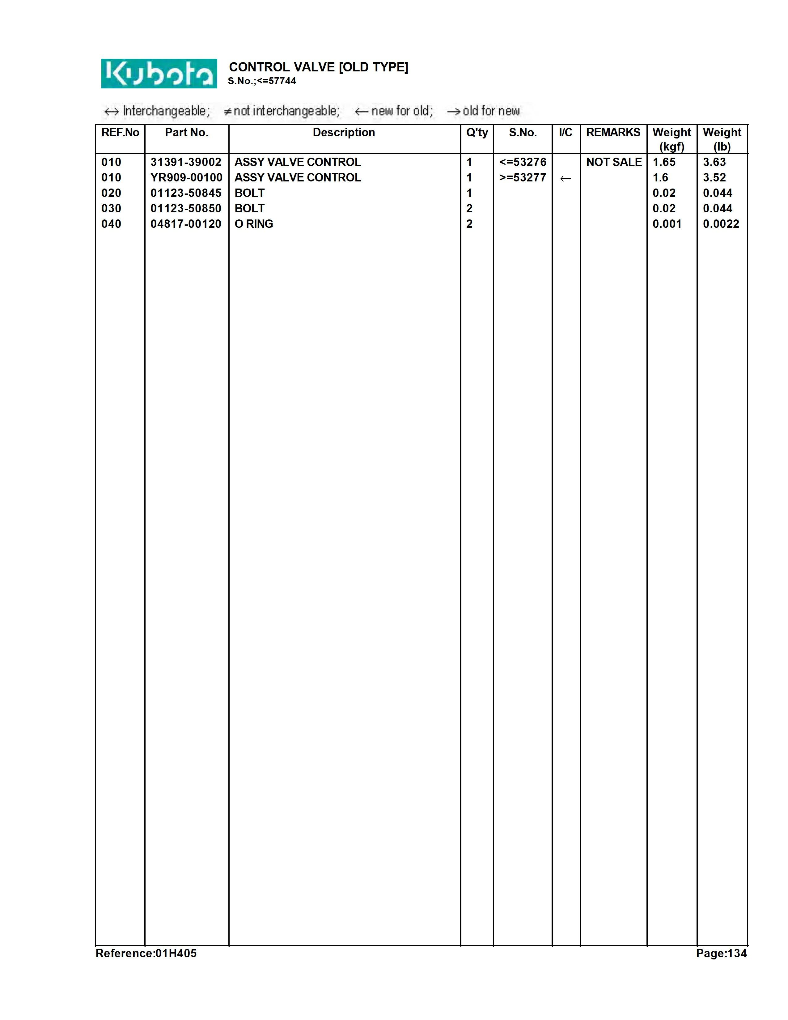

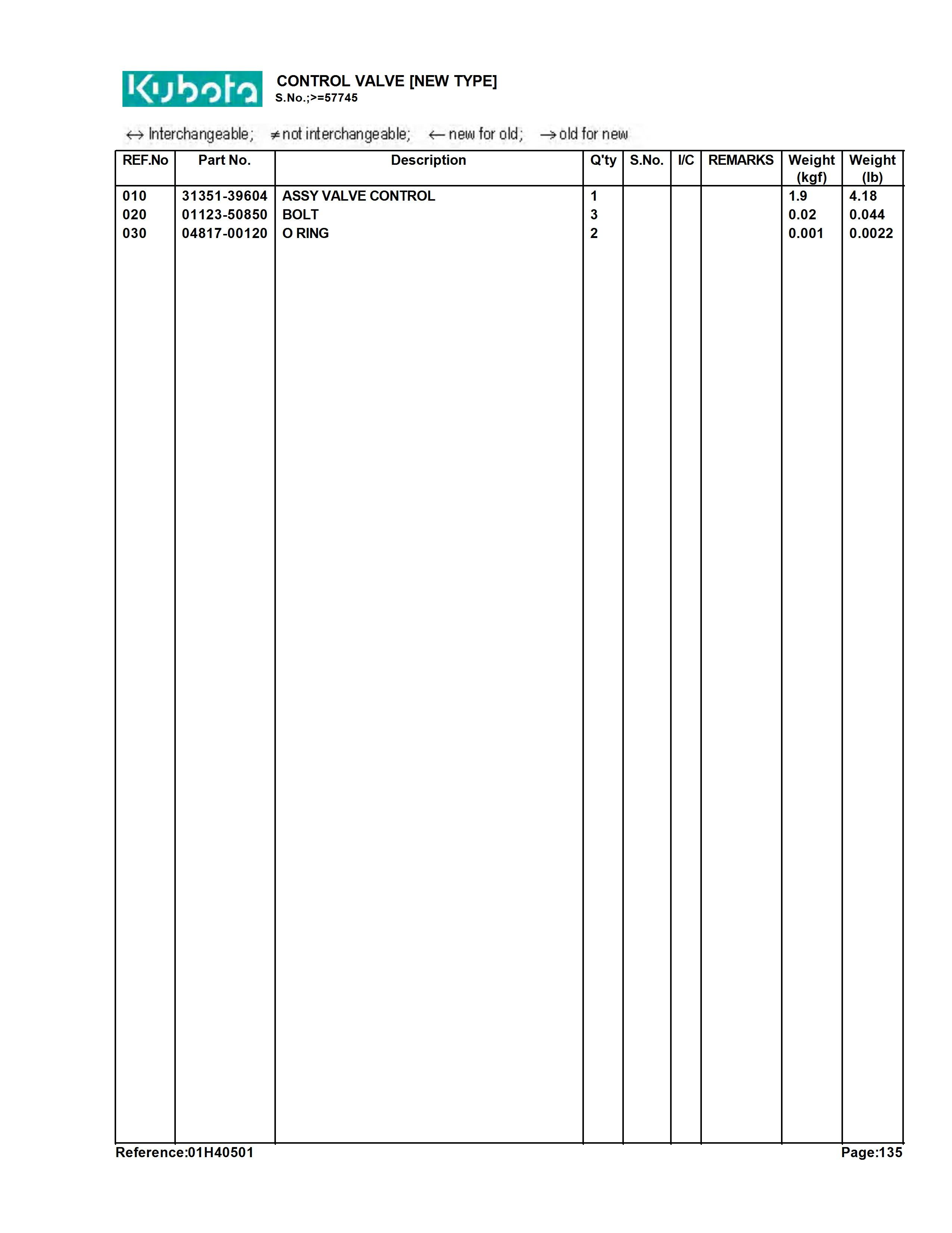

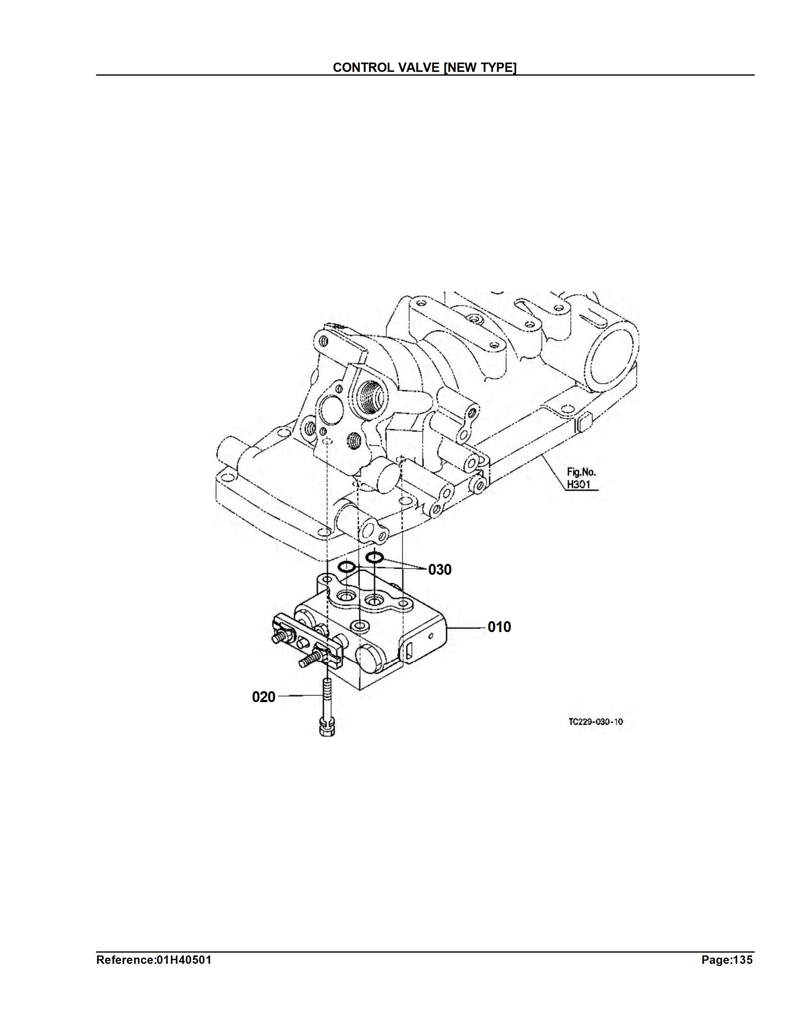

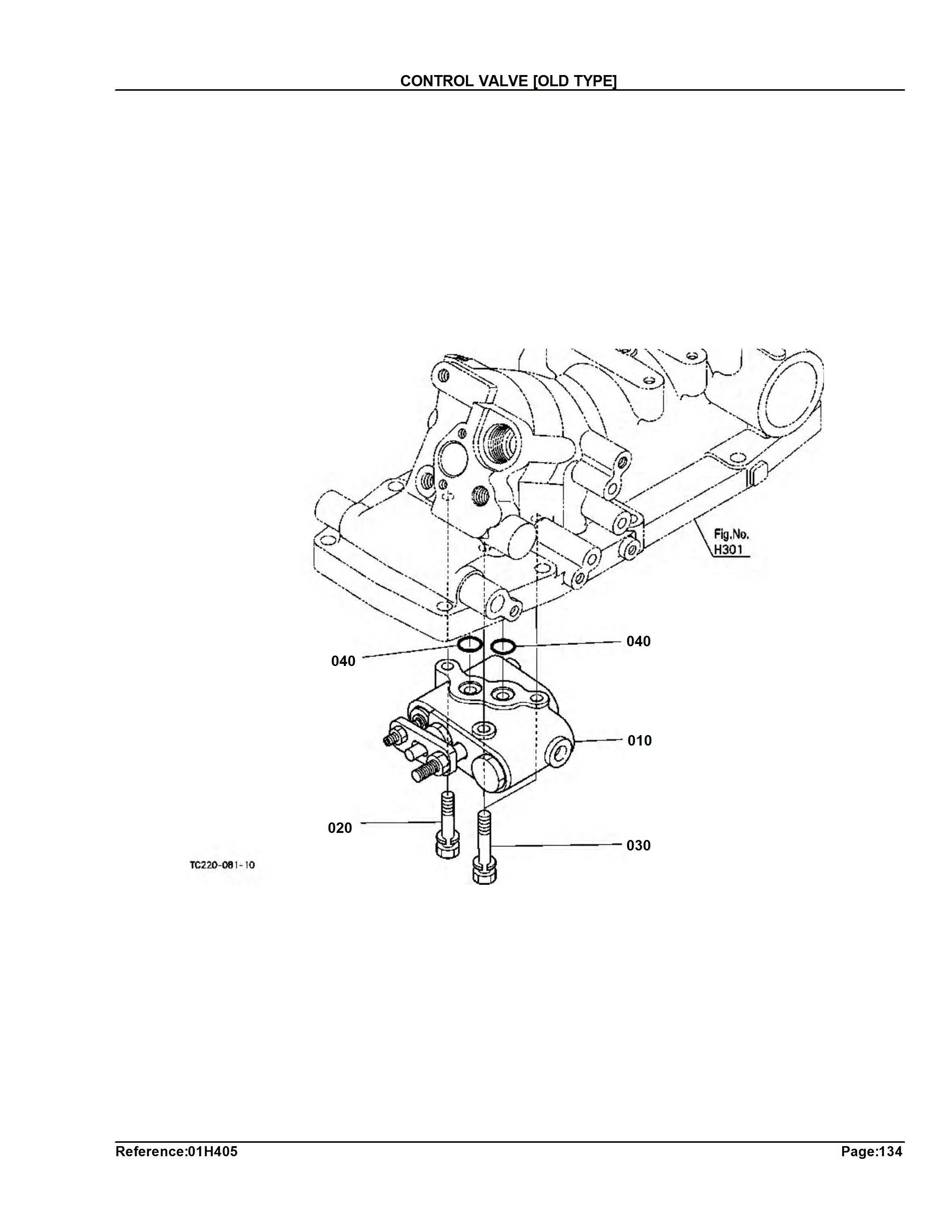

Here are some pages from the L2800 manual for the 3ph. Hope it helps.
Terry

   / L2800 Position Control (Jerky?) #48
Hi Everyone,
Just thought I would let you all know that I too have just purchased a new 2008 (I think ?) L3400 and am struggling with the jerky position control on my 3PH. The Kubota dealer who is working on my tractor has replaced my position control valve and it is still very jerky. He then setup another new L3400 and it too is doing the exact same thing so now he is saying that they are all this way and there is nothing wrong with my tractor :(
I would like to know what the actual solution to this problem is.
Question: Has anyone had their tractor "fixed" such that the 3PH is no longer jerky in operation (lifts like a normal tractor) ?
If yes, do you know or can you find out what the Kubota part number is that was used to replace your valve etc...
This whole experience has really shaken my confidence in Kubota. I have yet to return my "New Customer Satisfaction" questionaire. I really want to be a happy customer and good reference but Kubota needs to own up to the problem and resolve it soon.
Thanks to all of you for sharing your experiences, it is comforting knowing that we are not alone in this problem.
Toy

At this point I wonder what jerky means to you. When I got my L3400 in August of 2005 the 3PH raised in increments of about 1 inch. Raising the woods RD7200 mower made the tractor jump quite violently. After the valve was replaced it raised in increments of about 1/4 inch. It still jerks a bit but not enough to feel like something is going to break like it did before.
It is NOT silky smooth like my old Ford 1910. I don't know that any L2800/L3400 is perfectly smooth. I'd be more unhappy if I had to grade with this tractor. I use the 1910 for that.
With no implements on the tractor try this test. Put the 3PH at mid point. Hold a ruler from the ground to the edge of the 3PH arm and make note of the scale. very, very slowly move the control lever to go up. when the arm jumps up look at the ruler again to see how much it jumped. If the jump is in the range of 1/4 inch you probably have the same valve I do which is not near as bad as the original valve mine shipped with. If it jumps an inch I'd not let go of the dealer until it was resolved.
