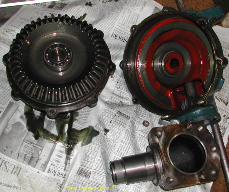

I have replaced the seals in my front axle for the L2550DT, which is exactly
the same as the L2850. It is easy, so I do suggest you try it. The two
special tools I needed are a pickle fork for the tie rod end, and a snap ring
pliers with 90-deg ends. Kubota has a retrofit (better) seal for that
tractor as I recall. There is another thread or 2 on TBN about this Kubota's
axle.
Your oil looks real bad, so it needs to be flushed and replaced with gear oil.
I also found that I could minimize the leaking by keeping good weight on
the front axle while stored.
