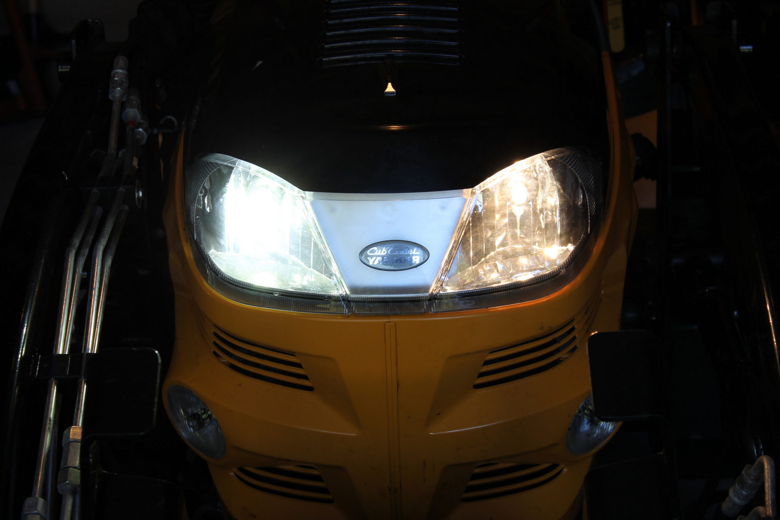

I bought them for my Sc2450 Cub / Yanmar tractor. they are really bright. Had them in for about a year.

Any concerns with them being a higher wattage than the stock bulbs? (50w vs 25w)?
/ L2900 Headlight Replacements? (LED) #10
I wouldn't worry about heat as the stock bulb has two 25w elements (25w high and 25w low), not sure about the wiring.
