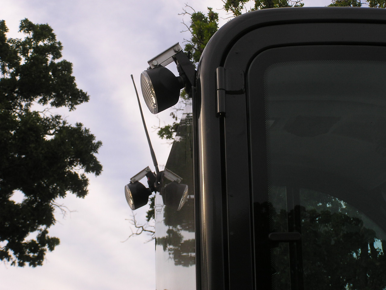

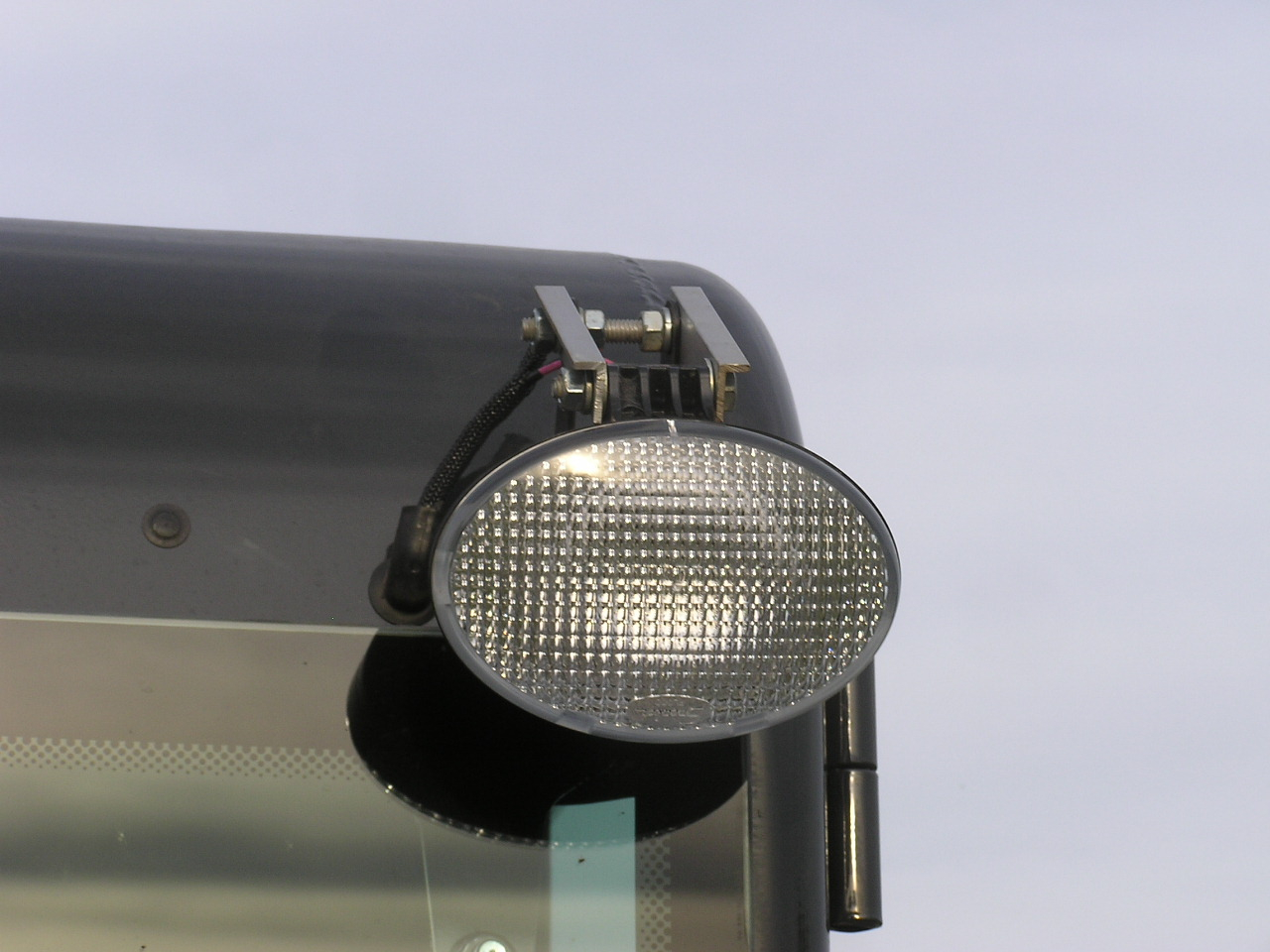

Can't help with LEDs but I did lower the rear work lights to prevent tree branches from hitting the wires and pulling out the light bulb.
Used some aluminum angle:

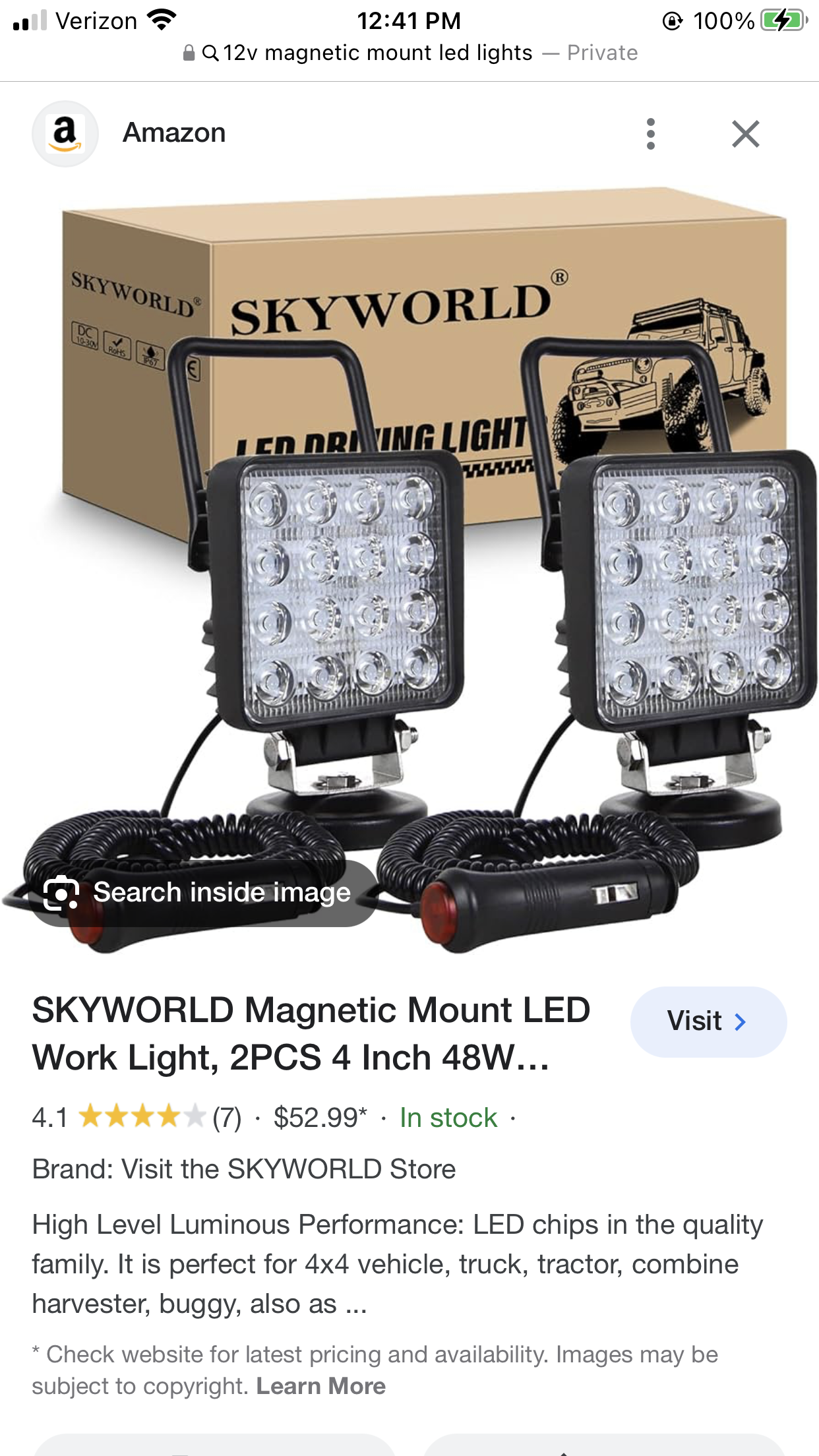

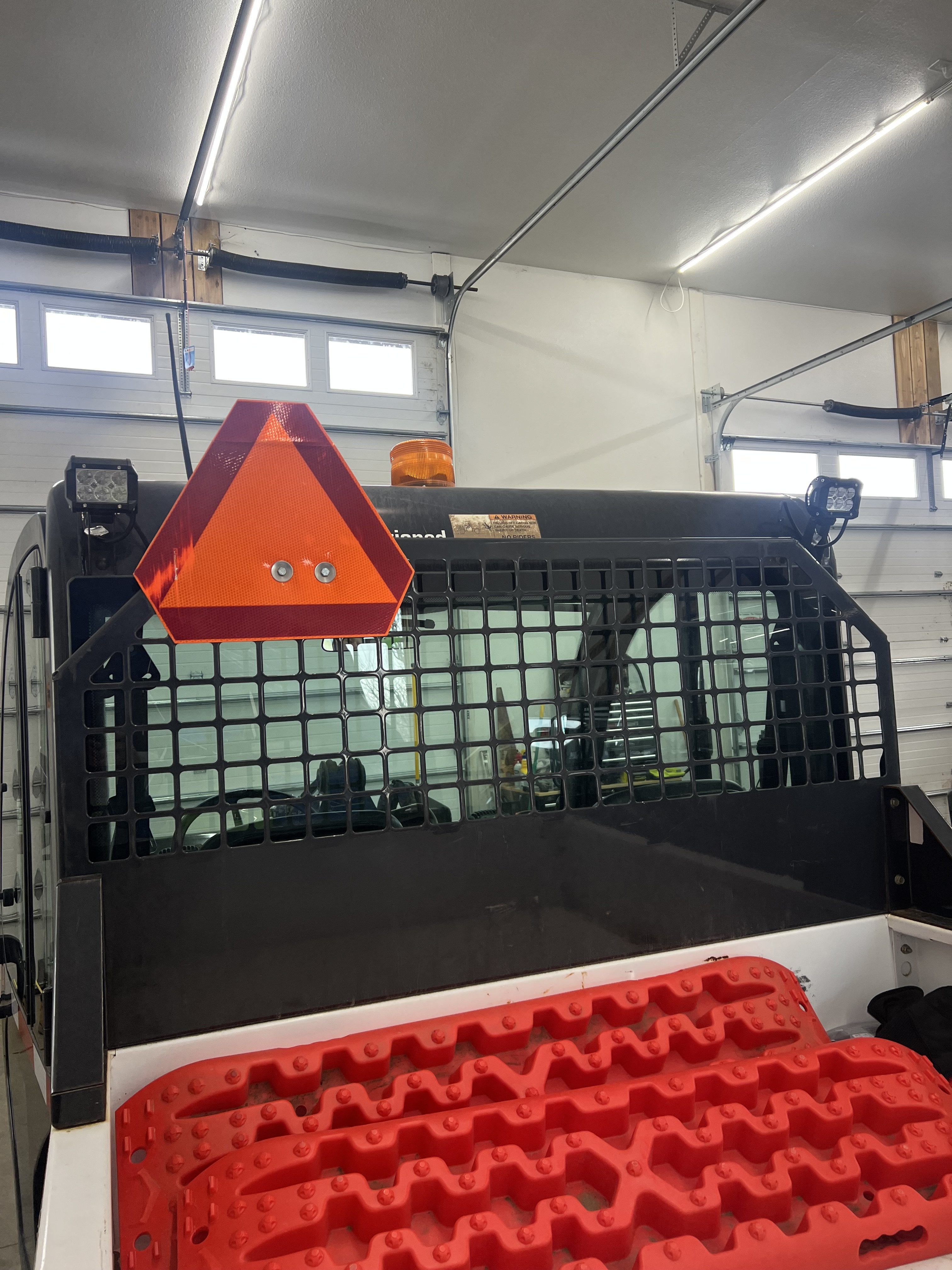

I bought some 12v magnetic mount LED lights to stick on top of my skidsteer cab. They work great; can angle or move them wherever I want.
The skidsteer has built in front and rear lights, but nothing on the sides, so it was hard to see how close I was to things on the side.
Kind of like these:

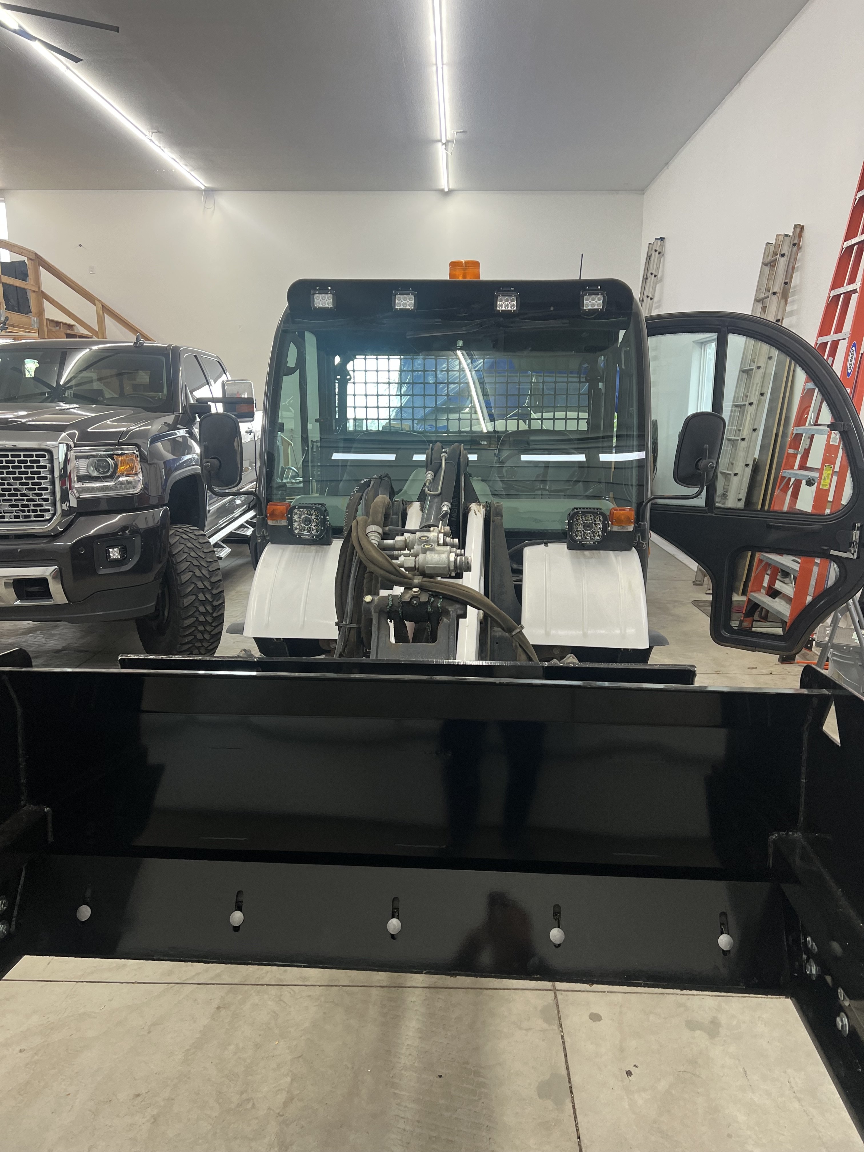

I went with these found all on Amazon very reasonable and use the same mounts.
Does anyone know how to wire the driving and floods to work together?
/ LED Replacement Work Light Bulbs. #12
the flood lights are off the rocker switch on the dash, one position is the flood the other position is the driving, you could add another switch to activate both be easy to do or just move the flood wire to the same terminal as the driving side, sadly the driving lights have high and low beam but for some reason Bobcat chose to only wire the driving, I did switch the wore inside the light on mine to work on the high beam filament
