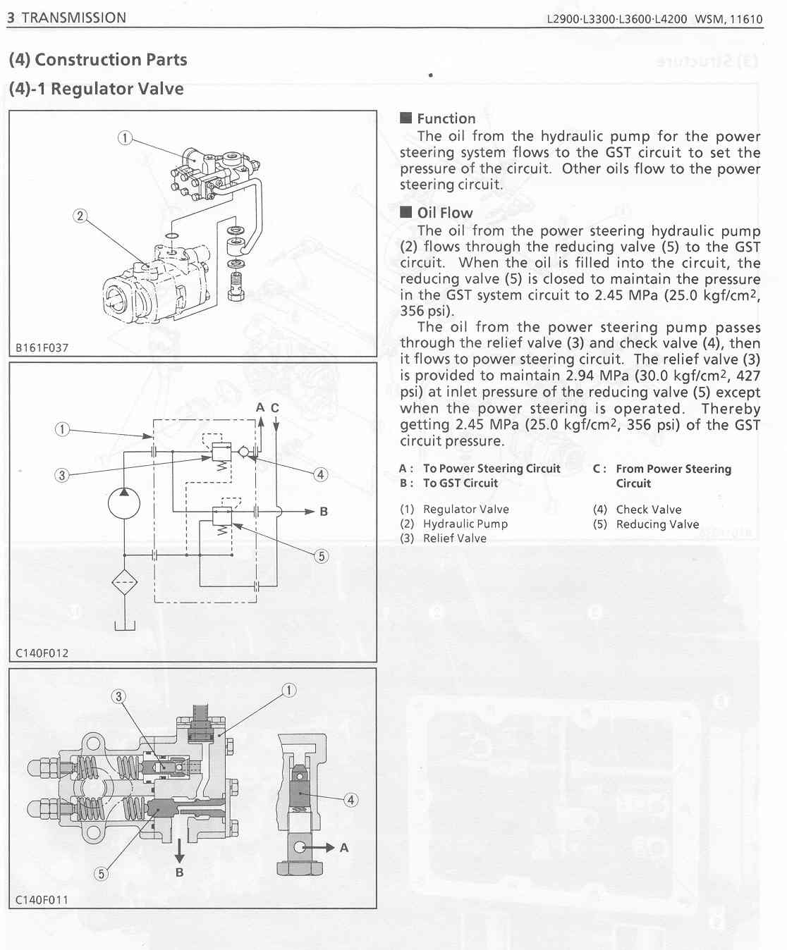

I wish I'd heard about the oil 'before' I changed it. I put in Napa's tractor hydraulic in the yellow buckets. I haven't taken the valve off the pump yet cuz it's pretty busy in there. I wonder if it can be the problem if the pressure is good enough at the check port? I can here a slight buzz from it sometimes as it trys to go into gear...

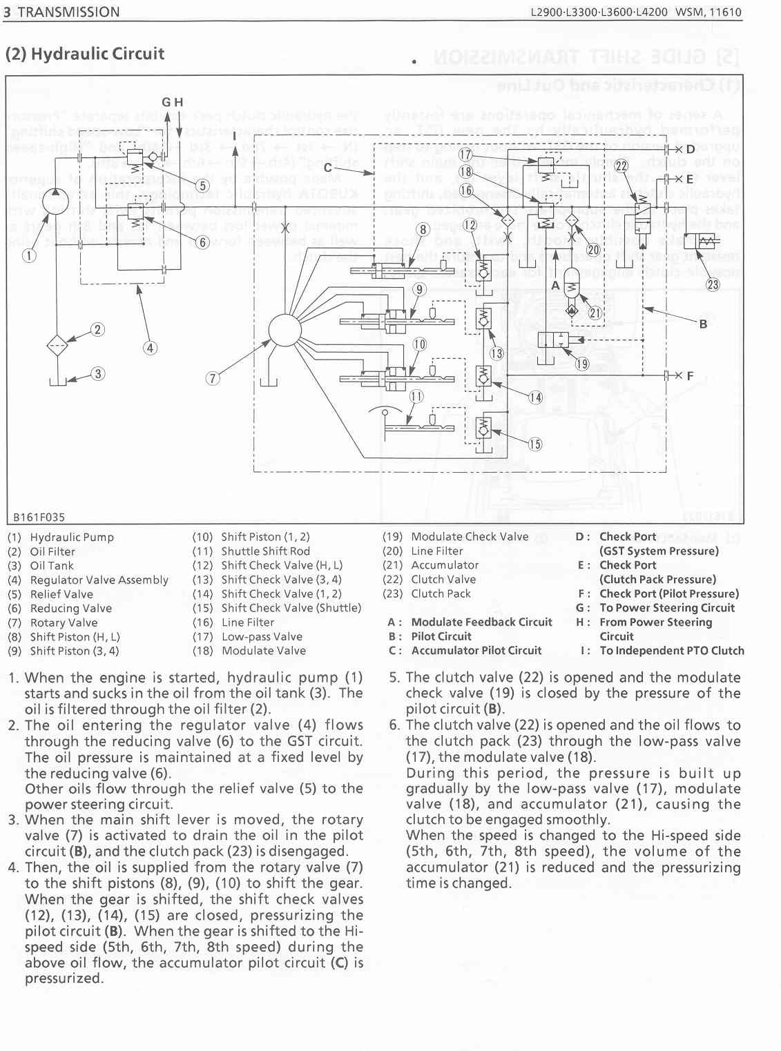

I am leaning towards a problem with the valve body because the pressure is fine everywhere until I get to the clutch port. It says in that writeup to check the modulate check and modulating valve, but doesn't say where they are? :)

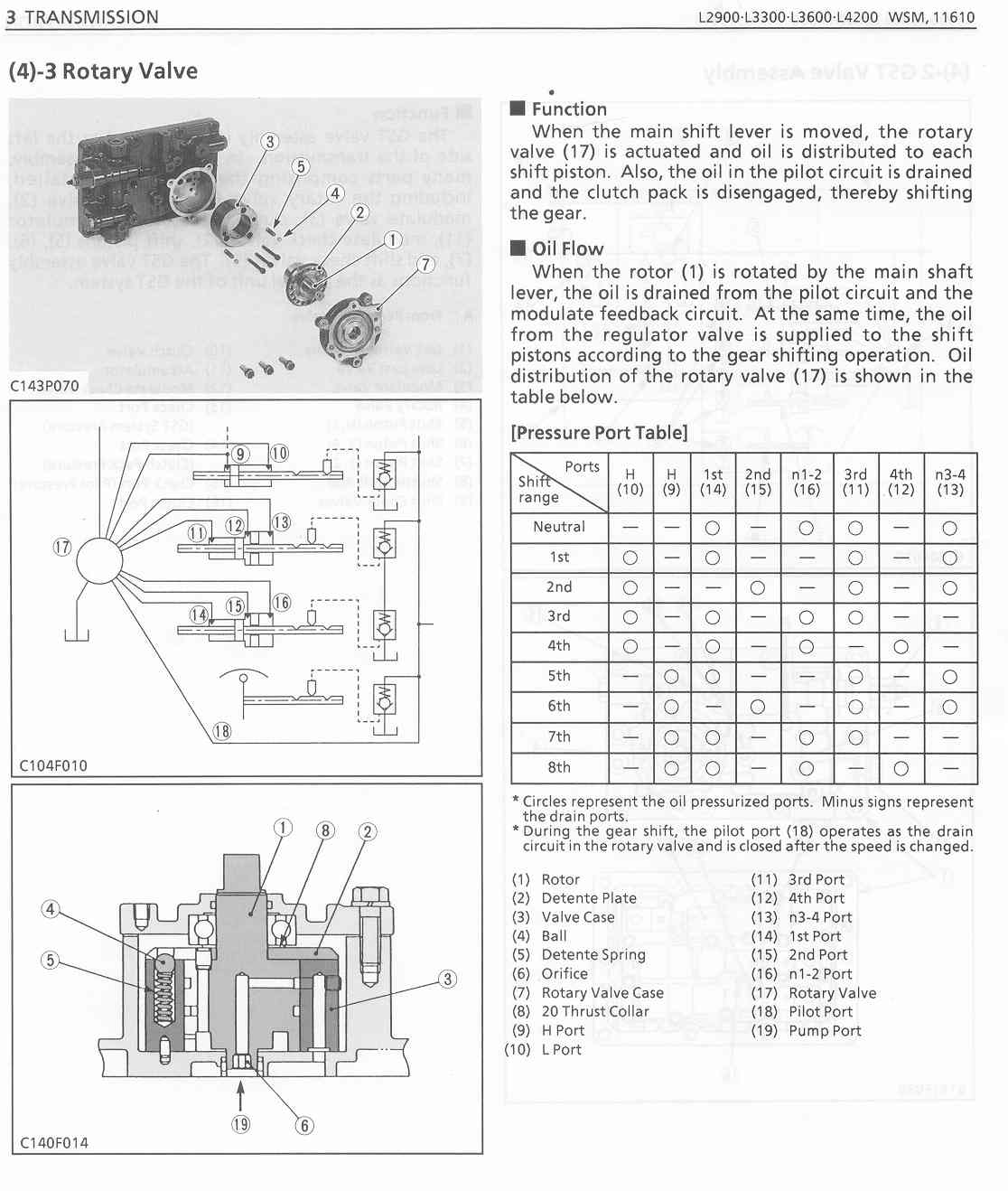

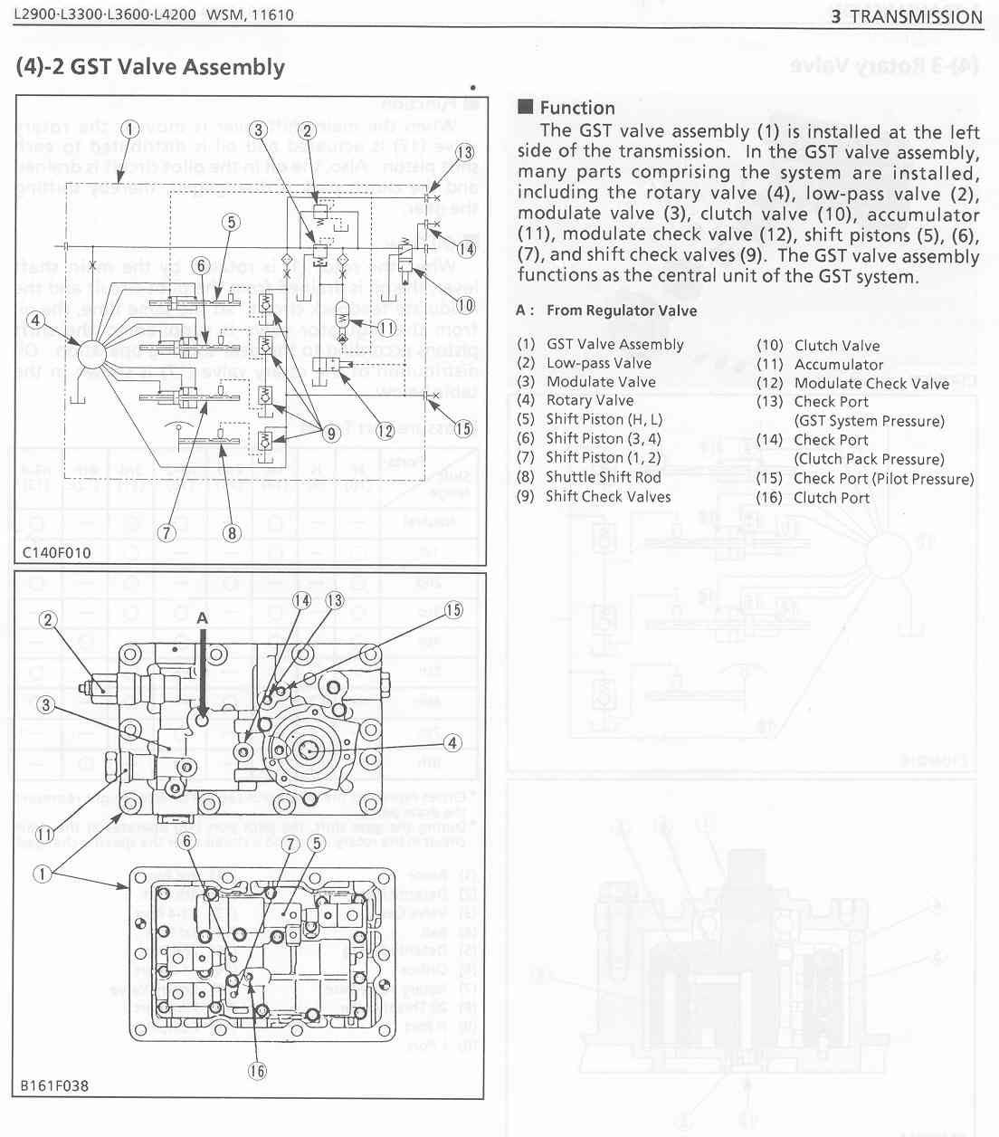

Well, after a pep talk from the local dealer it sounds like the 2 valves in question are the two that go up from the bottom of the valve body. I pulled them both out and (of course) can't find anything wrong with them.
I'm seeing some foam on my gauge when I take the hose off and wonder if the anti-foaming properties of the cheaper oil might be an issue? I hate to buy more oil, but I may have to if I can't find anything else.

Ok, I changed the oil and it worked for almost 5 minutes, but now the clutch pressure is hanging up right at 60 psi instead of going on around to 375... It does seem to be a lot more stable now, with the old oil you never knew what it was going to do. I was almost ready to call it fixed too. :(
Sure be nice to find an exploded diagram of the valve bank and see if there's anything I haven't seen yet. ;)

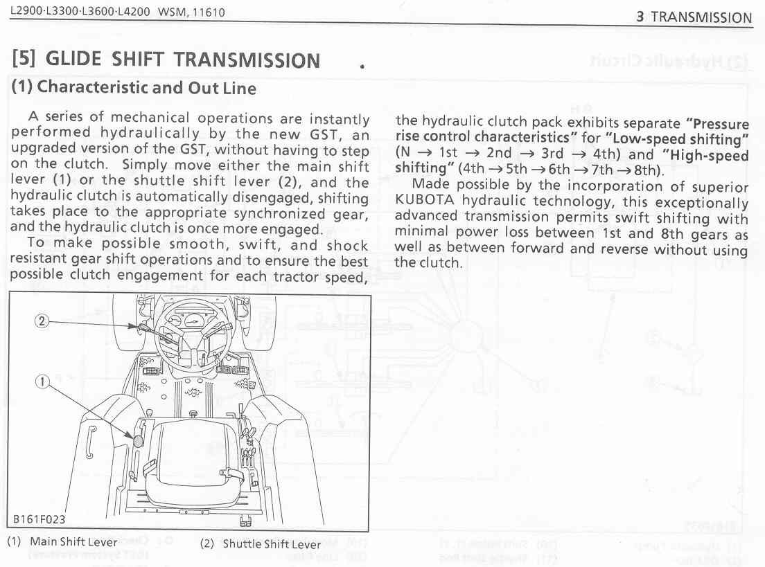

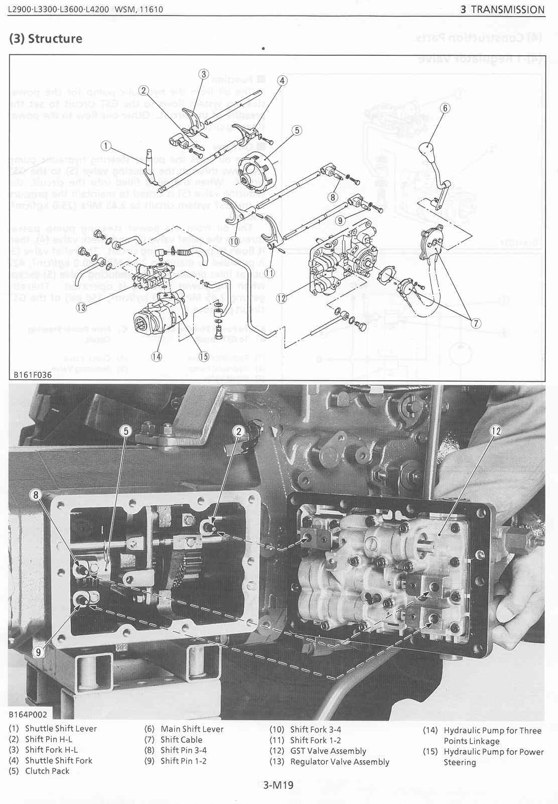

Was away from my scanner... sorry for the delay...
Here is the valving for the clutch...
KennyV
