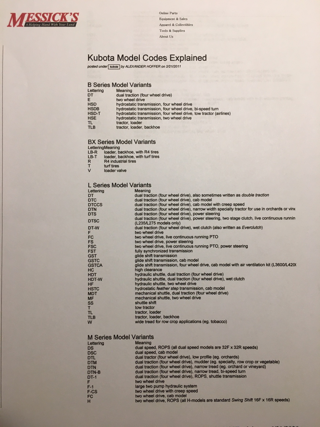

This is from Messicks.

Ah yes, Messicks, the 'Holy Grail' of high shipping costs. Coleman is much better, IMO.
Much agree. Last parts I needed I found at a dealer cheaper than Messicks.
When they first created their internet presence they undercut a lot of dealers on parts pricing. To a large degree they have gotten over that. But service sells and their service is outstanding.
