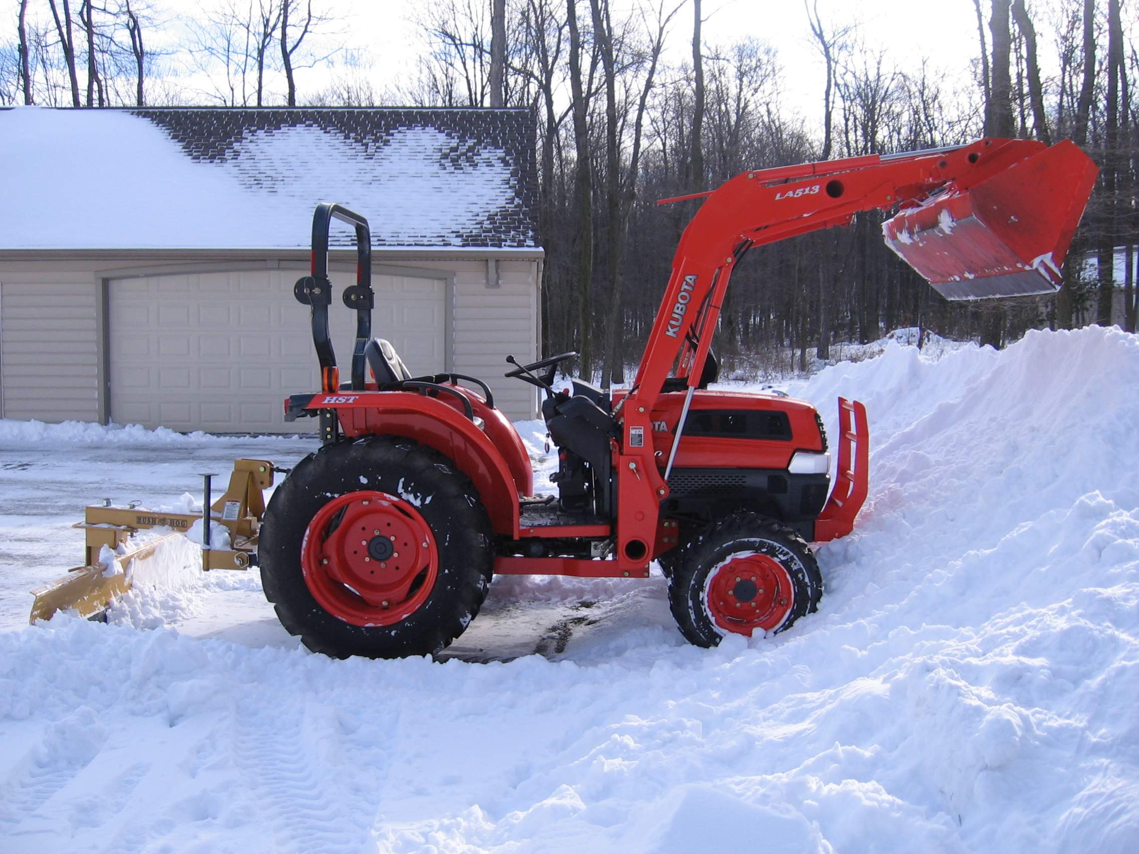

BTW - Thought I'd attach a picture I took just before Christmas. This was after the first storm of the season came through. Southern Lancaster, PA got over 20 inches of snow. Talk about fun!!! TD
