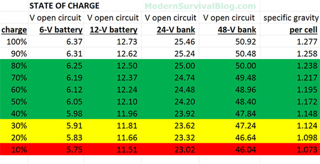

A fully charged lead acid battery should read in the range of 14 volts.
/ L3130 BATTERY HELP #11
... only while it's on a charger.
Normal resting voltage for a 12 volt lead-acid battery in good condition is around 12.7 - 12.8 volts.
/ L3130 BATTERY HELP #12
Yep should read about 13.25 to 13.35 volts on Battery Tender, keep us posted when new battery is checked under load.

Also keep in mind AGM batteries will have a slightly higher voltage when at 100% state of charge compared to conventional wet cell lead batteries, and both vary slightly with battery temperature.
There's also a difference between batteries supplied to colder climates versus warmer climates as warm/hot temperatures are really tough on their life span. To compensate for this the design (electrolyte to lead ratio) is slightly altered.
The OP should conduct a voltage drop test on the circuit in question. A bad cable will show a greater voltage drop when under load. As others have noted a wire assembly can look good but have internal corrosion that can not be seen.
