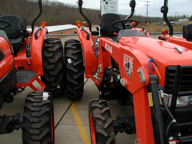

Well today I went up to the dealer to snap some pics. Here is a L3130 with R1 tires mounted the widest I have ever seen. Next to it is a L3430 with the R4 tires and mounted the same way. I wish I could have gotten a pic of the inside of the rim but this dealler was stocked to the hilt with tractors and they were to close together. The valve stem is on the outside of the rim and the dealer said he takes the left and mounts it on the right and vice versa. Check out how the tire sticks out past the fender.

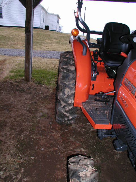

Now check out how the tire looks on my tractor.

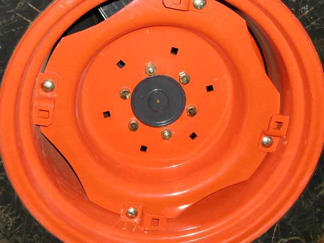

Here is a shot of the rim on my tractor. The dealer where I bought mine said this was the widest setting. So what do guys think? I measured the width of my tractor and it is about 59.5 or 60" or so from outside of the rim to outside of the rim. I would like the added stability. I think you would get another 8 to 10 inches in width.
