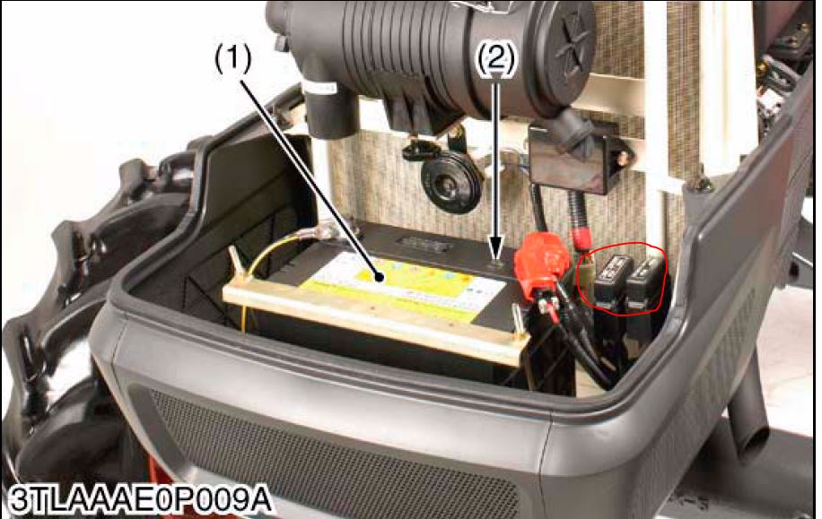

My multimeter is kind old and wonky, but I took the battery to Advanced auto parts and they checked it with a load meter. 12.4V and good for 500 cranking amps. I guess it's the battery main fuse, if I can find it. I don't get it. I checked voltage at the starter, and I have voltage. That is the positive cable to the starter. Where is the fusible link? I unwrapped the cable a foot back and see only battery cable. Where in the world is the main battery fuse?

Just to the right of the positive red terminal under a cap (in other words in a little box)

It is an actual fuse.. 40 amp according to the schematic it is right by the positive terminal.. Actually there is one main, and several others there as well.
   / L3200 HST dead. No power to anything on the panel. Not even hazards #19
Look for you fuse inside the red circle..

Thanks a lot guys. I really appreciate your help and advice. My L3200 has 2 of those small fuse panels under the dash, not by the battery. I already checked those and they were good. There is another fuse panel with smaller fuses on the left side above the starter. I'll check them again in the morning since there is a monsoon tonight. And college football.
